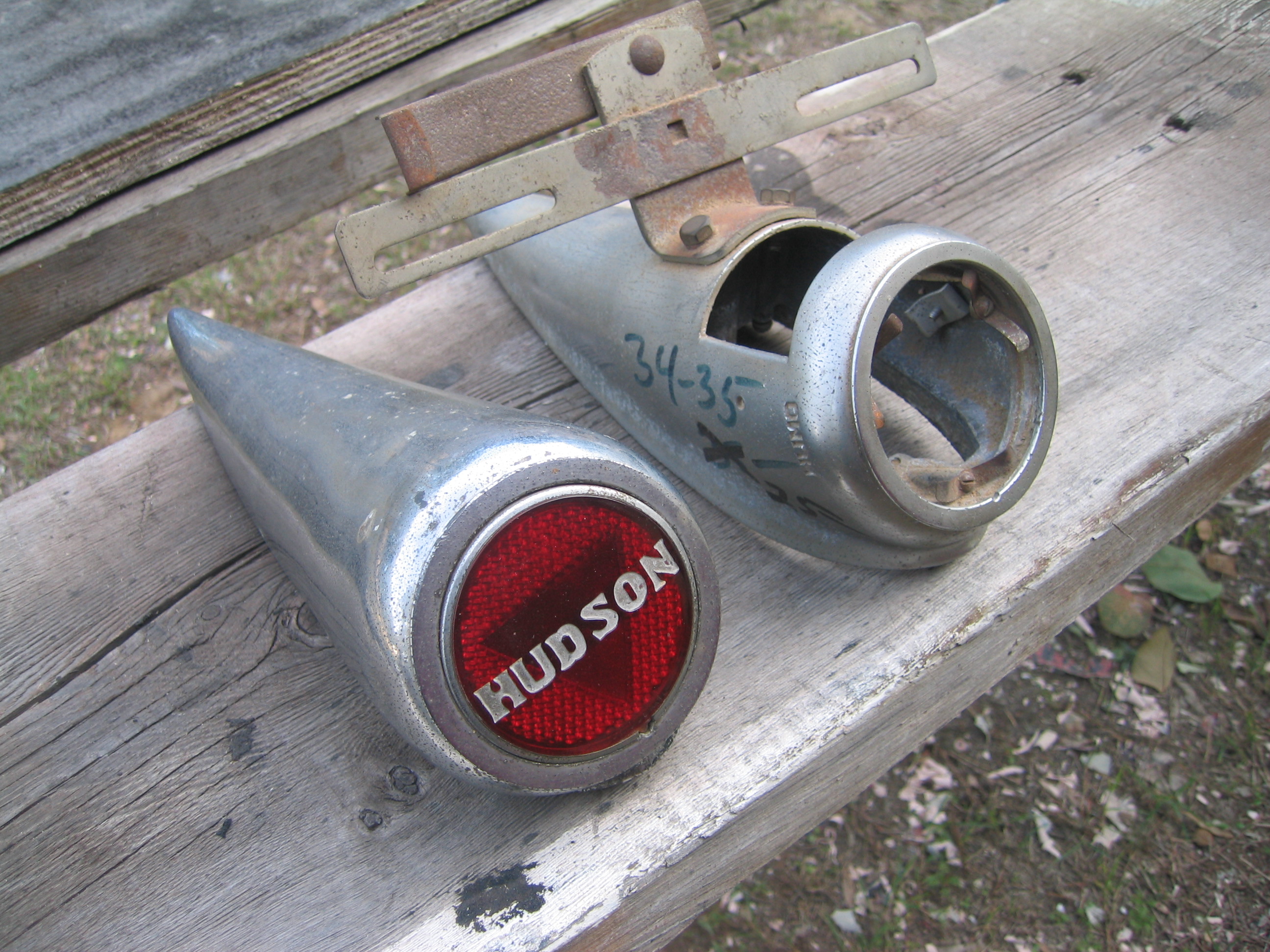

I'm trying to remove the lens from this 35 tail light, it obviously goes something like press the lens in against the spring clips and remove the retaining ring.
How to remove the retaining ring without damaging it is what eludes me at the moment. Any thoughts on technique?
I guess they are rarer than rocking horse poo, but I'm going to need a retaining ring for the other housing. Anyone have spares?
I think you push in on it and slide it down into housing. Then pry out the retainer , push in again
to get it in position to pull it out the front. It's been 35 years since I've done one , so wait for confirmation ,
Or contradiction.
Soak ring long and well with your best rust penetrant. Keep working any bit of movement until you can get even more movement. Then do as above.
