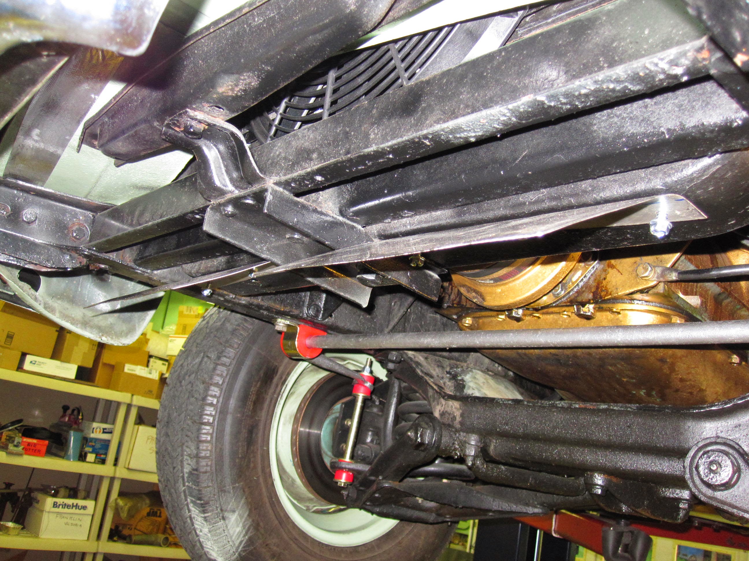

Richard,
What are the sheet metal pieces for in your picture, air dams?
Rob0 -
Air dams--the more air you get into the radiator the better, correct. This directs air up the 'slot' in the cross members? anyway. I have also used gorilla tape to close off bypass openings.

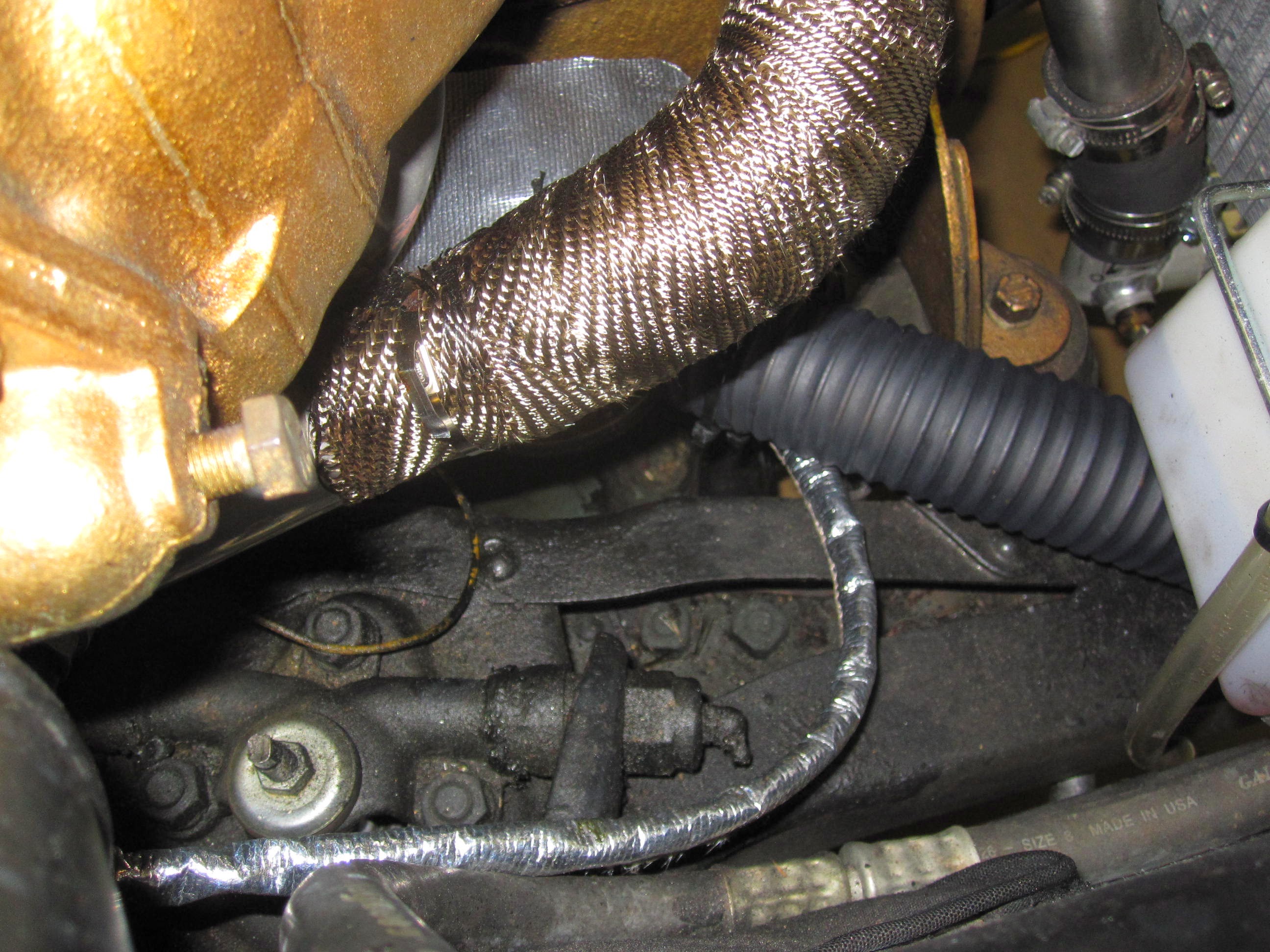

Also, an air pipe to the fuel pump. the one with the coil steel in it. if interested go here for all the stuff I have added> > https://plus.google.com/photos/101895503406236284856/albums/5971153057530367985?banner=pwa
