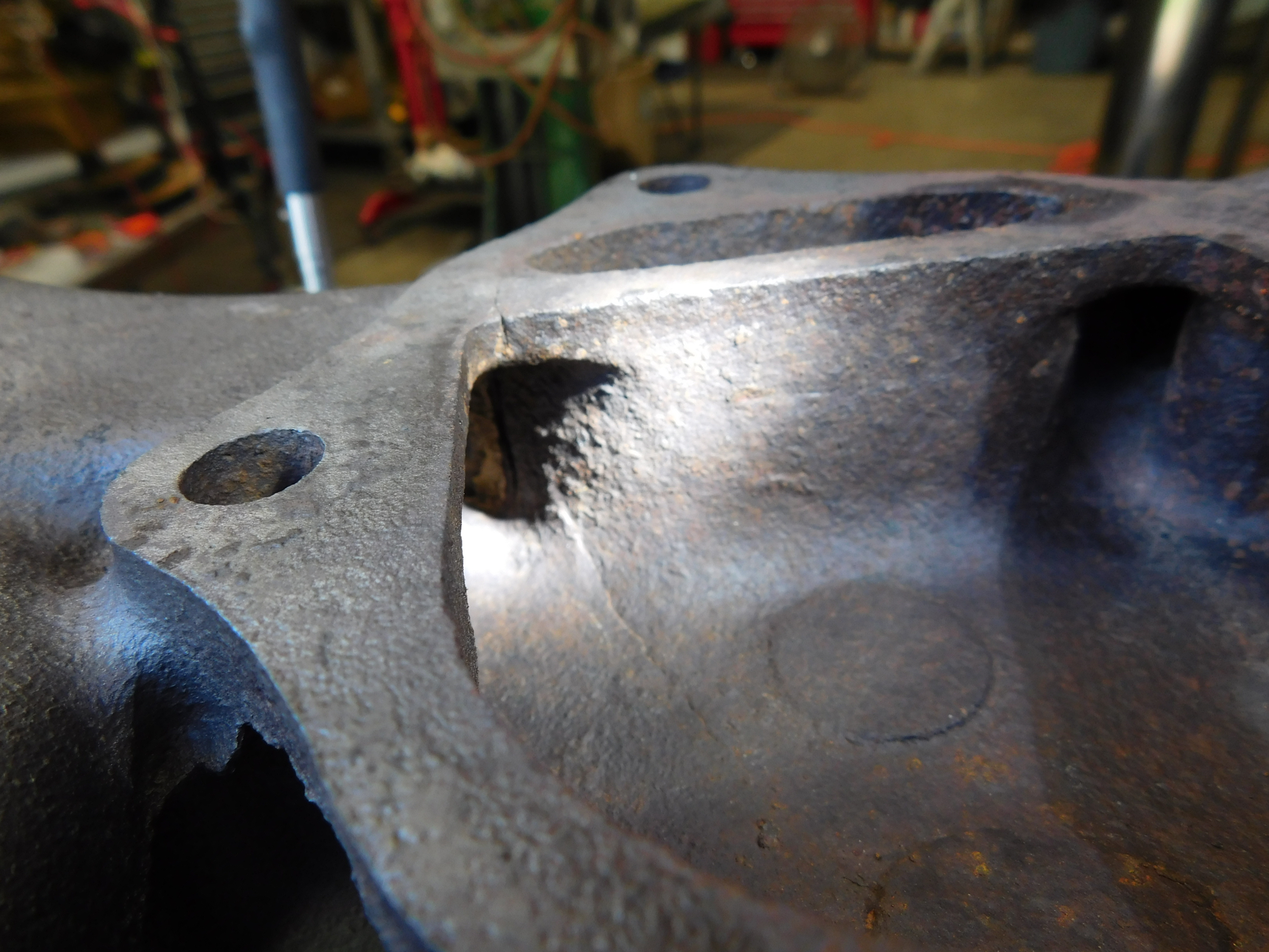

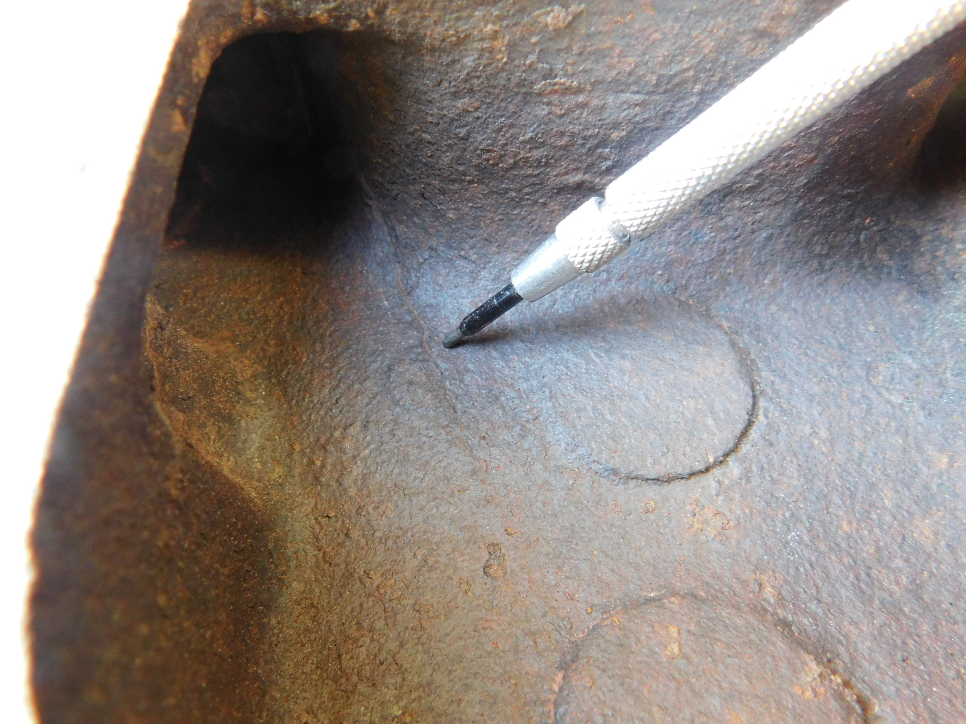

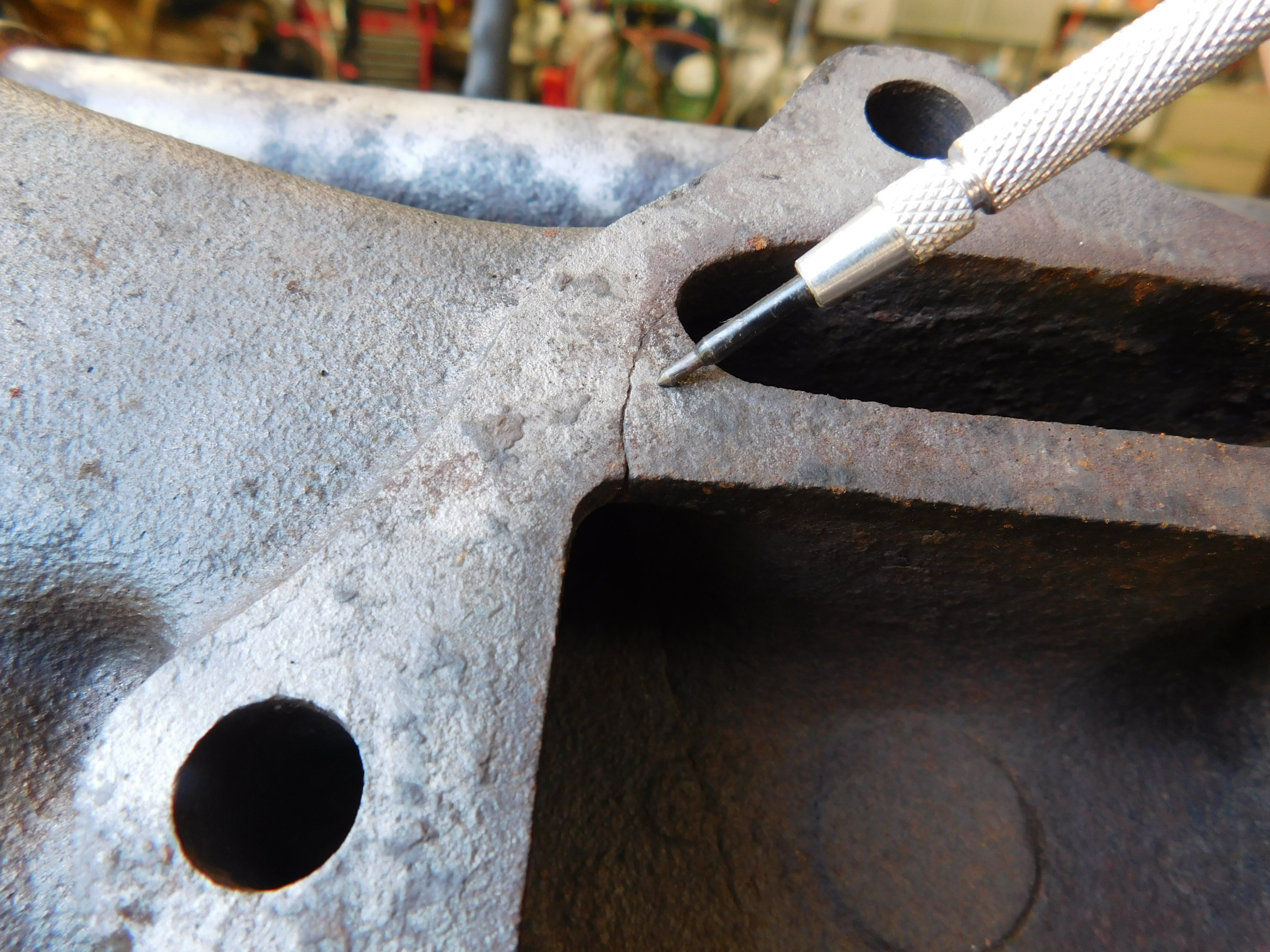

Another intake manifold just in, a Twin H that was sent to me.
Here is one of the common crack areas I've found on most. Being as this engine will have headers installed I don't think the cracks will be an issue being as they are not in the "intake" part but the bolt to exhaust part.
There is another twin h manifold on ebay. I is a complete manifold, intake and exhaust. It too has a crack in it. It appears to be in the exhaust. I noticed that it does not have a balance tube like the other one. Does this mean it came off a Wasp and the other was off a Jet? LHud0
