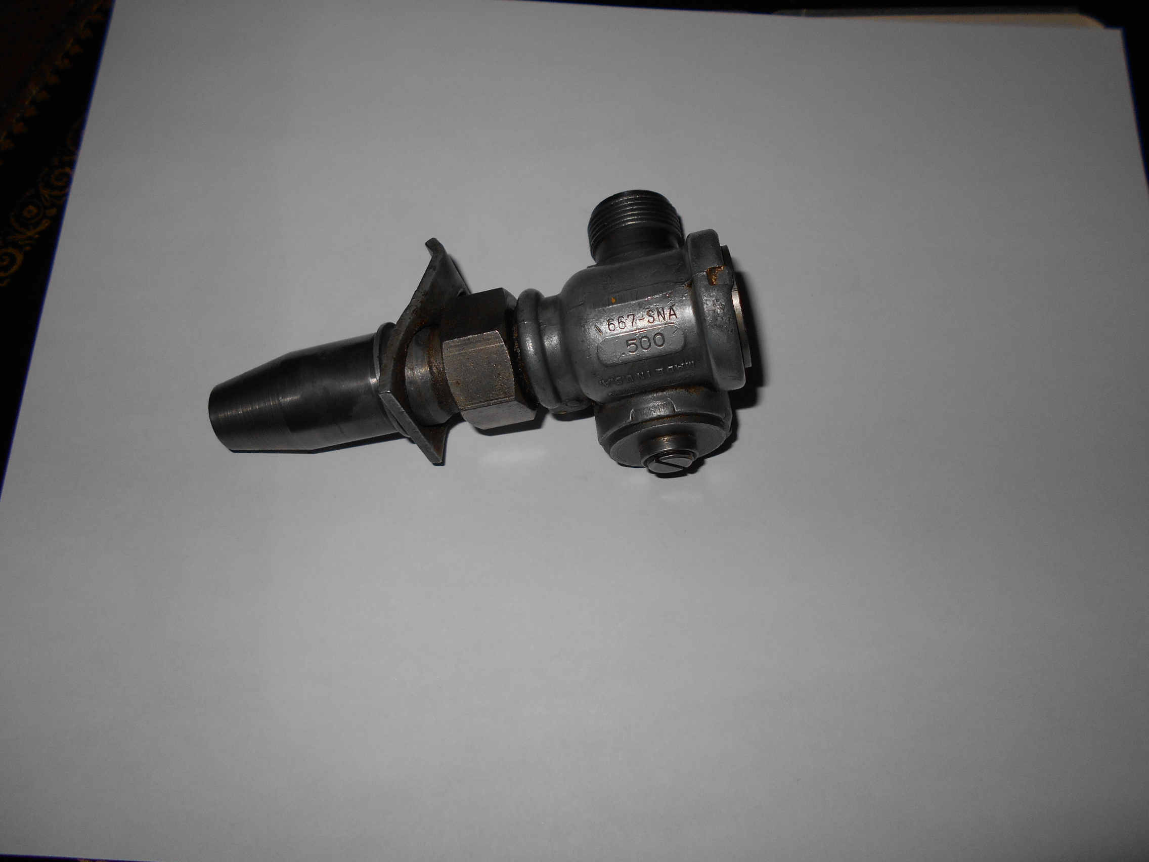

right angle speedo gizmo
Terry, that OD tranny likely came out of a '51 car. Numbers on the tranny case may confirm that. The gizmo/gadget is a 2:1 reduction gear arrangement that was used on the '51s. They changed the speedometer gearing for '51, but weren't able to change the speedo drive gear in all the OD trannys in stock, so they put this little reduction gadget on them. I've got one on my '51. If you've got a '50 model Hudson, don't use the reduction gadget. Sell it to someone who needs one.
The speedo gearing change was to match up with what all the other makes were doing. Up through '50, Hudson calibrated their speedo's at 2,000 cable rpm at 60 mph; everyone else was using 1,000 rpm cable speed at 60 mph. So for '51, Hudson got with the crowd. Because of the way Hudson calibrated prior to '51, if you ever send a '50 or earlier speedo to a shop for repair, be sure to tell them to calibrate at 2.000 rpm for 60 mph. Some of the younger guys won't believe it until they check with an old-timer.
Thanks Park I cleaned it up and it works says Stewart Warner in small script on the side. I'll have to check the tranny numbers tomorrow out of curiosity. That's what I like most about these Hudson forums, you don't just get an answer, you get a darn good answer.0

I have this for sale on the club site.........I'm not sure what to ask soooooooo.....$50 ???? Terry0
