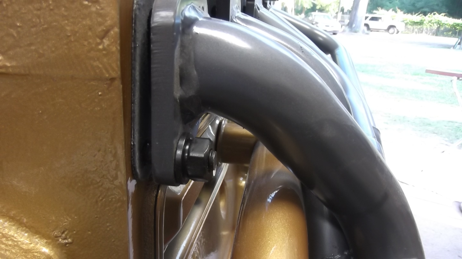

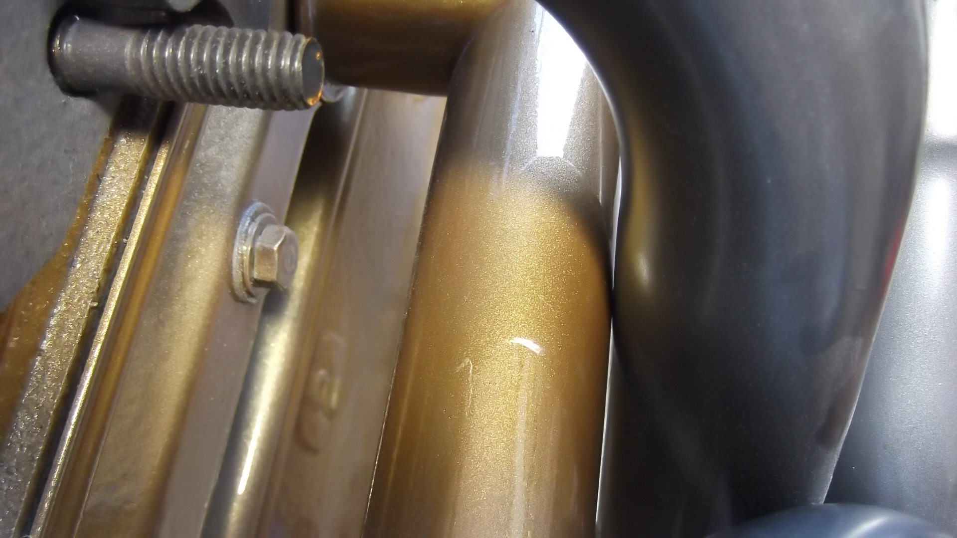

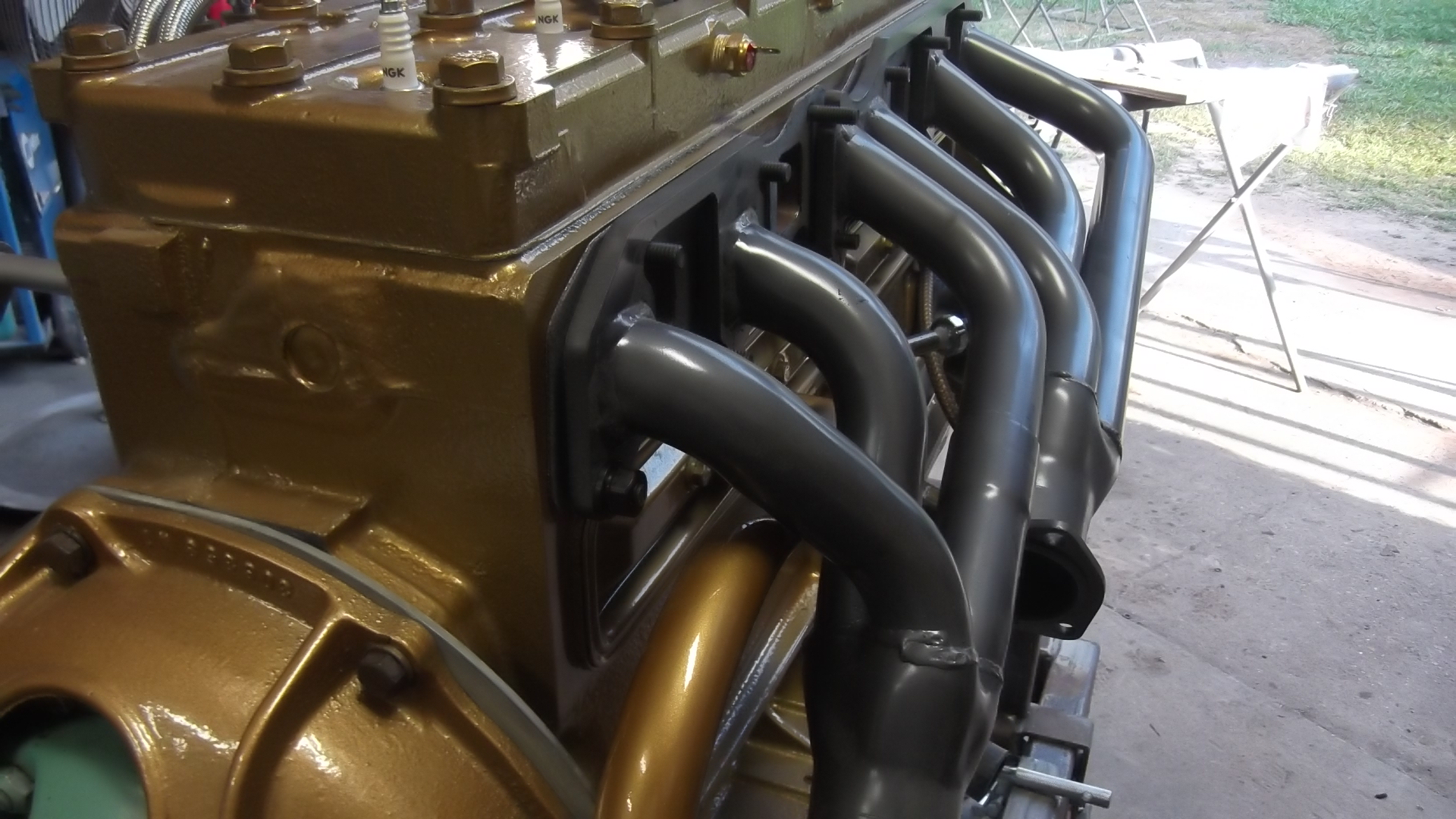

Looks like I have an excuse now to do Bill's PCV valve conversion I have planned on doing anyway. Started to
bolt up the Clifford headers and they are hitting the road draft tube before tightening.
FYI
You could use 2 Gaskets to gain some clearance with no problem, however, Ive installed PCV valves for years....
