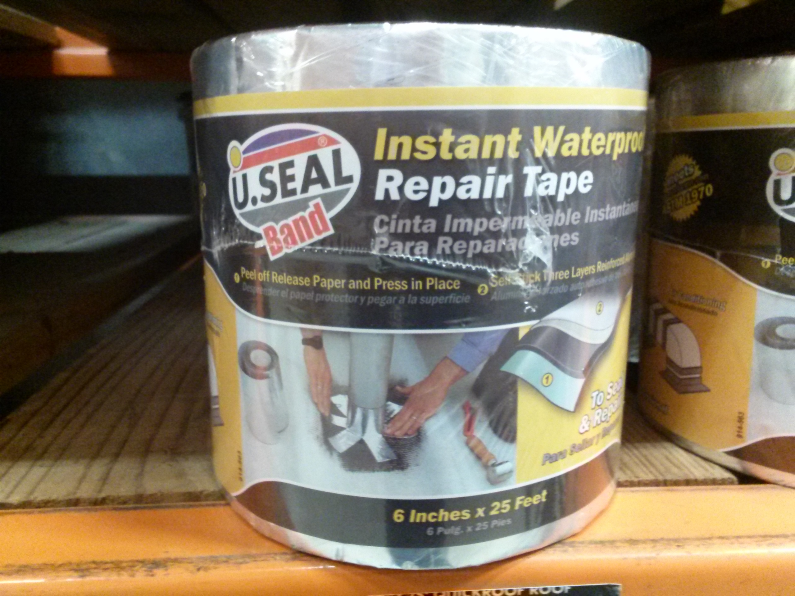

home depot/ lowes etc has an alternative which is in the roofing section it is a peel and stick product that is approx. $16 for 12.5 sq ft it is 6 inches wide and 25 ft long I used 4 rolls approx. 50 sq ft and spent $64 compare to dynamat etc sq footage and you will spend over $200 also contrary to others opinions this has no discernible odor but the choice is yours0

superDave-That's the stuff I always use. Only thing is, the surface you are sticking it to, has to be very clean (smoother the better). I also tend to use metal tape between joints. The stuff is thin, so you can also overlap it 1/2" to 3/4" or so. Price is Right!0
Thanks for info on roofing peel and stick product.
