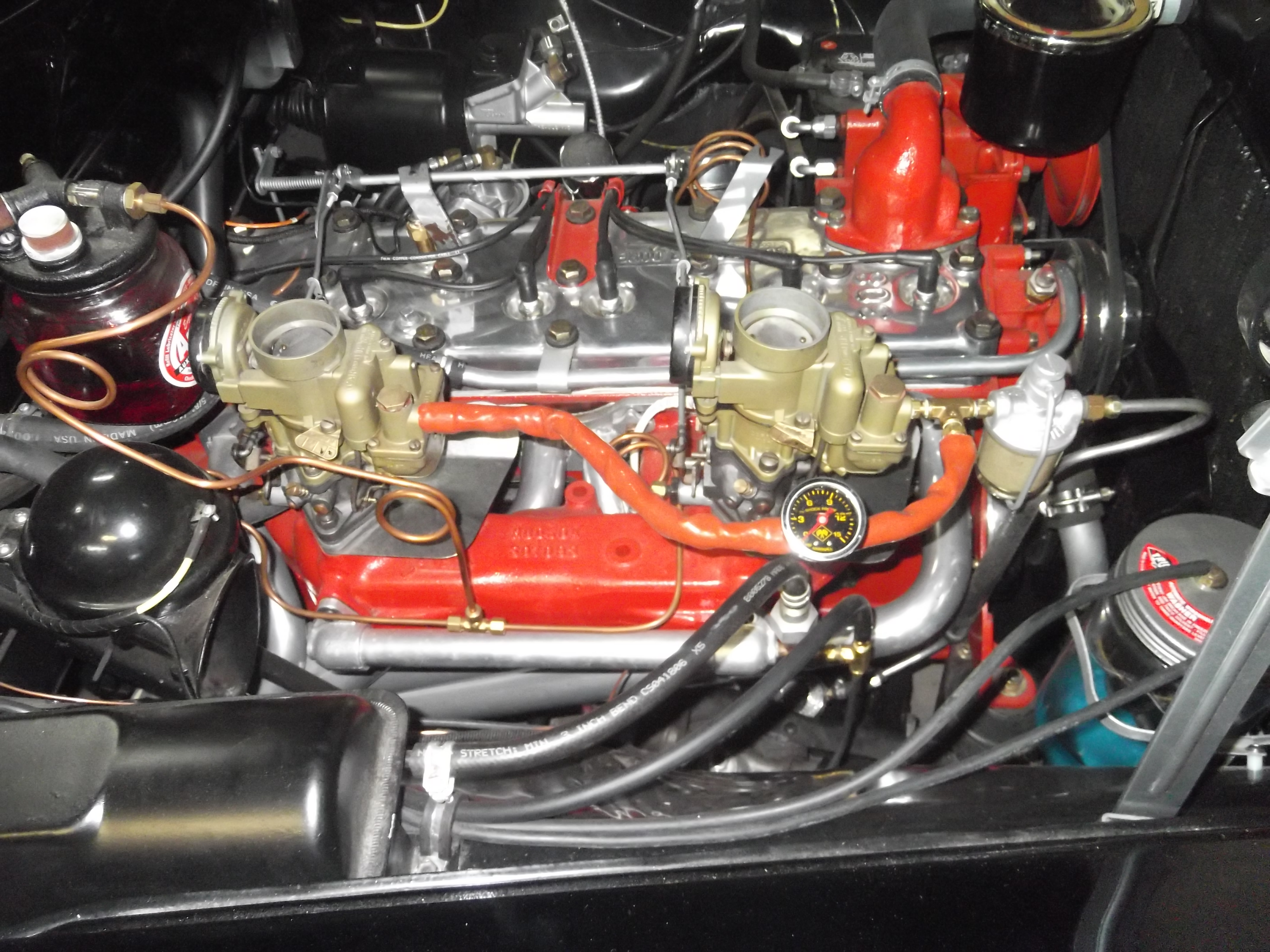

I have one on my 54 and have it plumbed to my twin h with Ampco carb spacers for an early dodge engine. I did it for looks and I believe the valve guides appreciate the lubrication. The Ampco system you get is new old stock and built to a quality standard you won't see often anymore. Its a jewel. I'm thinking you could put ZMAX or any other fluid in it you may want to experiment with. Marvel Mystery Oil for sure. I just turned 60 and don't mind at all asking for the senior discount but "old timer" brings up visions of Gabby Hayes

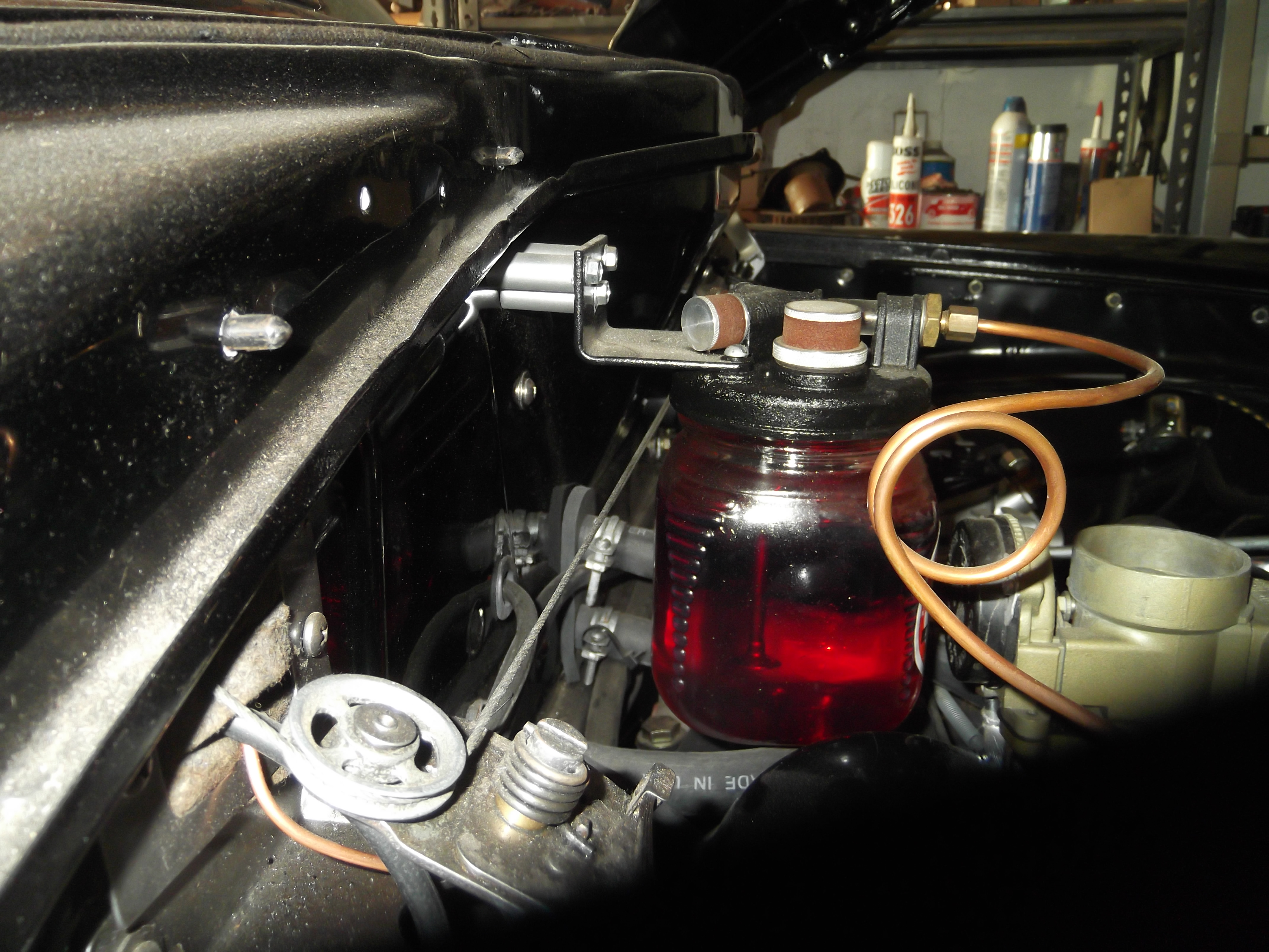

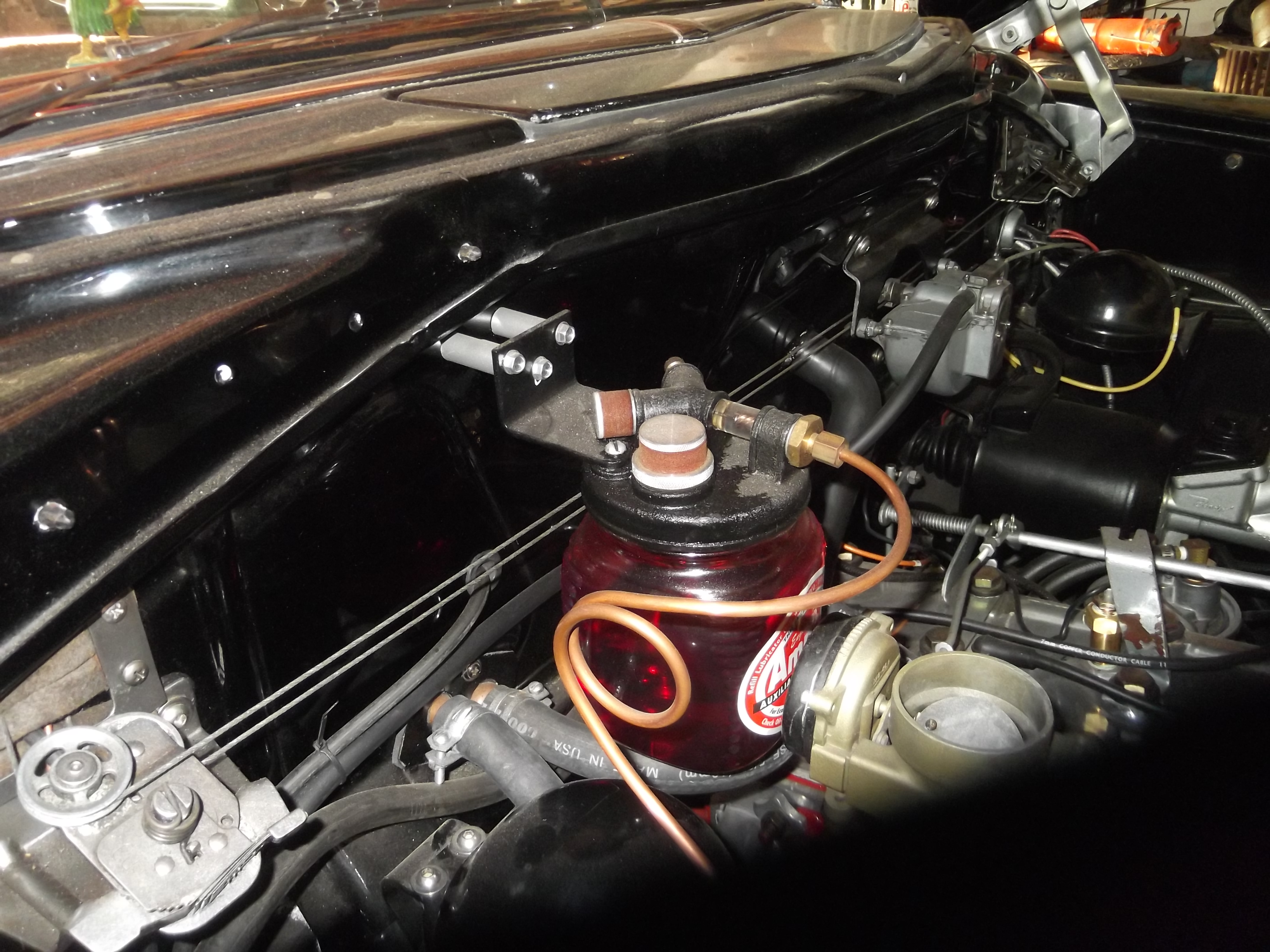

I went ahead and bought one before they sold out. They only had 16 left in stock according to the website. After I bought it, I was struck with the fact that the windshield wiper wires were going to get in the way of putting it on the firewall. Thanks Chris for posting the picture of your unit. I think I can either install it the way you did yours or put it on inside of the fender well. I've never seen the engine compartment of a 54. Does your car still have the old windshield wiper cables like my 48?0
Yes on the cables, I spaced out the unit about an inch or so to clear them with some metal tubing0
It sure would be helpful if you could post a picture of how you did that. BTW, I'm 63. When I mentioned old timers, I figured I would get a response from the guys that were actually driving these cars in the fifties, not someone younger than I. Anyway, thanks for the pics you've posted already.Jason0
Home Depot has 4 ft long metal pipe/tubing 1/2 OD and #12 14x 1 1/2 long self drill screws. I cut three 1" pieces to space it out enough to clear the wiper cables. You could also put it where the windshield washer bottle goes or near it if you have one.
Sweet. Thanks Chris.Jason0
