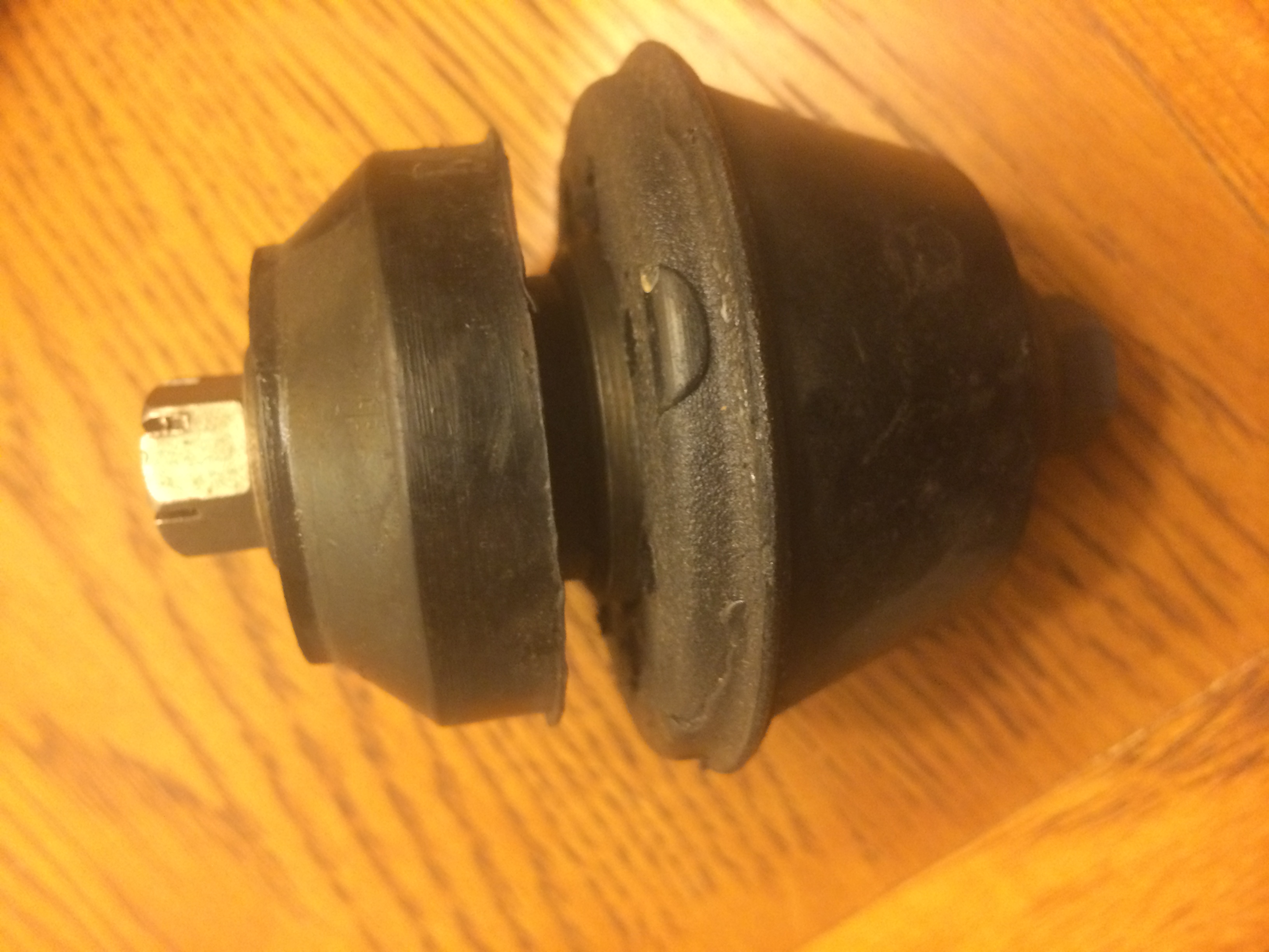

7X Motor Mounts? Found in box.
ski4life65

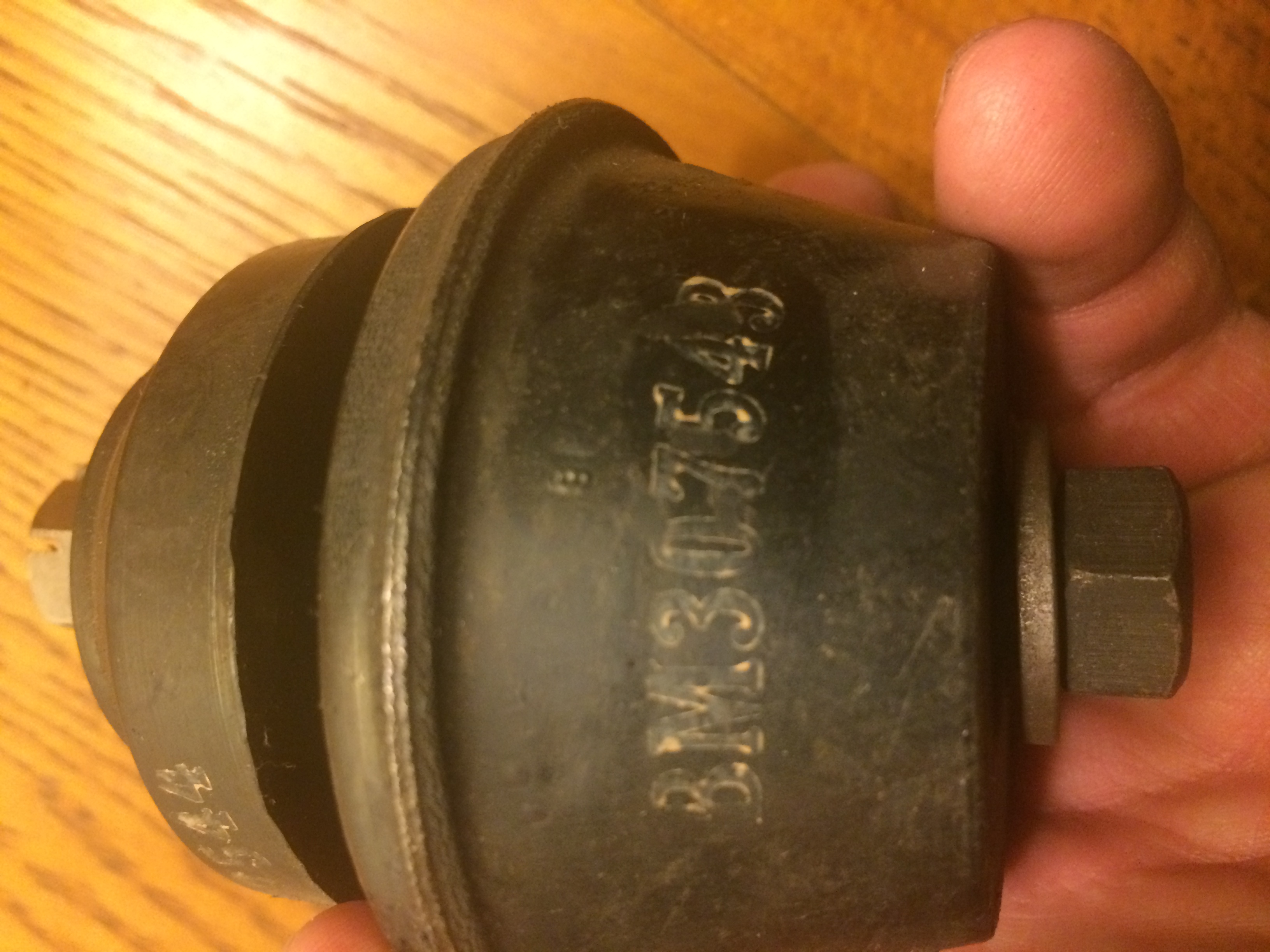

Yes, that's precisely what they are. 307543 is listed in the Severe Usage Parts section of the Master Parts Catalog. Oddly, it lists the years as 48-54 (no jet).0
GOOD FIND.
SEVERE USAGE PARTS LIST - Section Z in Master Parts Catalog 1948-1954
307574 Kit-engine front mounting, consists of 2-30753, 2-307544, 2-GM181413, 1-GM451014, 4-171096, 2-307664, and 2-307660
307543 - - Mounting-upper-engine front
307554 - - Mounting-lower-engine front
171873 - - Bolt-engine front mounting
GM451014- Nut-engine front mounting bolt
171096 - P/washer-engine front mounting bolt
307664 - Sleeve-engine front mounting bolt
307660 - Bushing--engine front mounting
It seems as if part numbers GM181413 and 171873 are the same bolts. Possibly some slight differences or come from different suppliers?
Thanks for sharing your find. Looks in like new condition, NOS

If you take some measurements, (outside diameter, support plate thickness, bolt size, overall thickness) it can easily be cross referenced to a current two piece Lord Isolator (CBB/CBC) mount. That sure is a nice find!

Oh my, that is a sweet piece that I'd love to see repopped. The stepped, cup washer looks similar to the early Chevy V-8 mounts.
