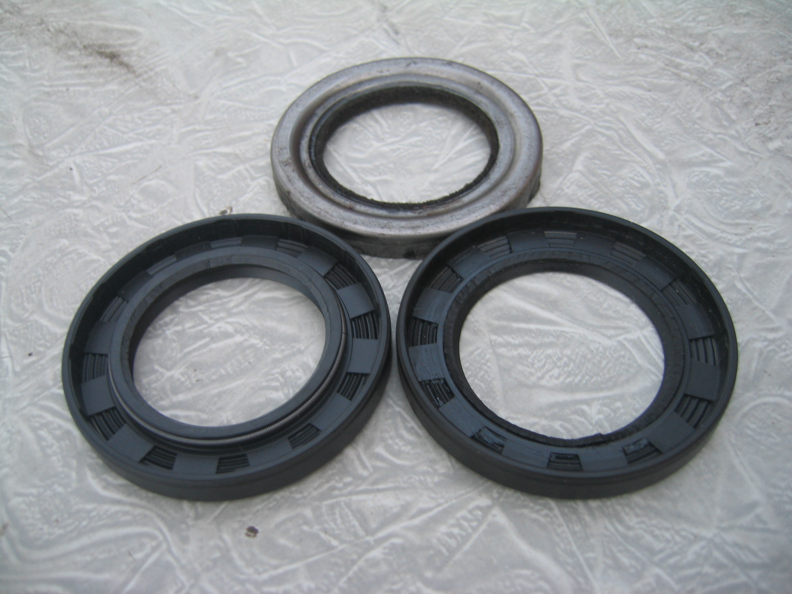

I'm not sure where Rock Auto gets their application information, but as far as I'm concerned, they are usually only about half right! ! !
I'm using the modern 5/16" thick seals in my Hornet front hubs. The moulded seals have 2 lips, if you carefully slice off the inner lip they fit and seal just fine.I've recently pulled my front hubs to check how well the seals are sealing, and they are doing the job. No grease in the brakes and no dirt in the bearings.The photo shows an original seal, an unmodified modern seal and a modified seal.0
