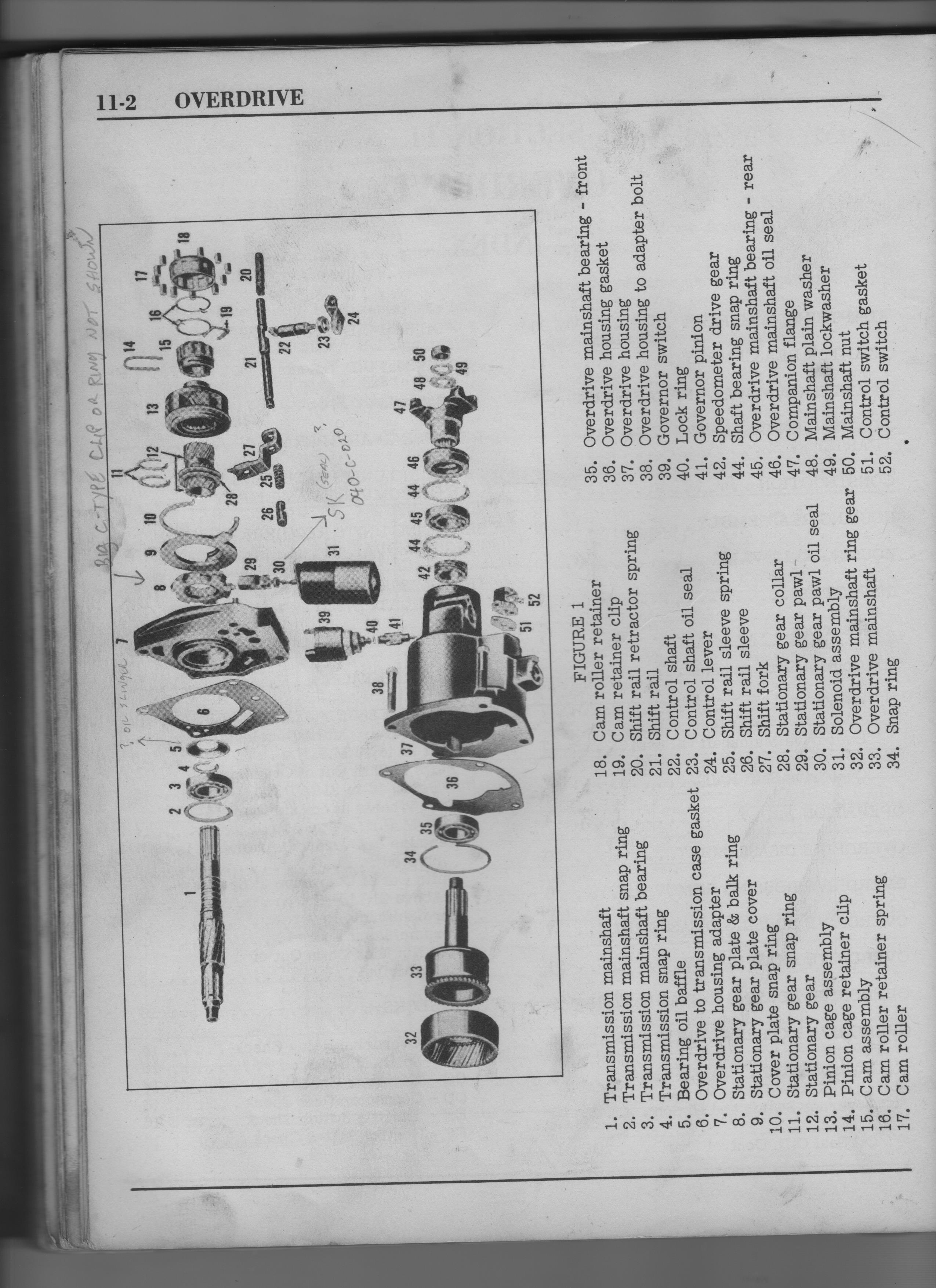

I'm wondering if it is possible to re-install the control shaft 180 degrees out? (#22)
If so, can I pull the control lever back off and just rotate the shaft or does the od housing have to come back off?
I'm not with the car right now, so just want to get my ducks in a row before hand.
The shift rail (21) needs to be properly aligned for the control shaft (22) to engage its slot (yes it can be turned in the wrong direction). You can't fit the tapered pin into the slot of the control shaft until it's all in position. It's also essential the shift rail retractor spring (20) is aligned with the hole in the OD housing, before attempting to install the housing over the shaft.
Ok, yes the spring was in proper position. If I remember right, the slot was a full 360 degrees around the control shaft, so if the lever is taken off, (not allowing the housing cast stop interfere with turning the shaft 180 degrees), can it now be turned the 180 or will the cam in slot prevent it from making the turn?
Is the only option pulling the housing?0 -
The slot is only on one side, if it's turned the wrong way it will not work. You can't turn the shaft without removing the OD housing. The below picture is from when I disassembled my gearbox.
I almost made this mistake myself, the picture below is from the reassemly and as you can see I had the shaft turned the wrong way at first!
