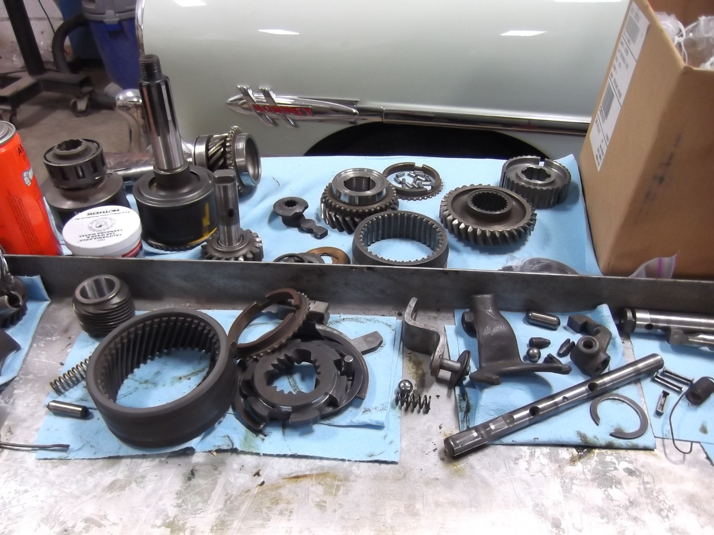

Looking for a few small parts for the 51 Commodore Hudson 3sp od transmission.
I just took the gears and shafts over to my machinist to make up the bushings.
Still need the other parts if anyone has them! Already checked with Al.
I have the transmission taken
apart now and need to see if you have a few items for it.

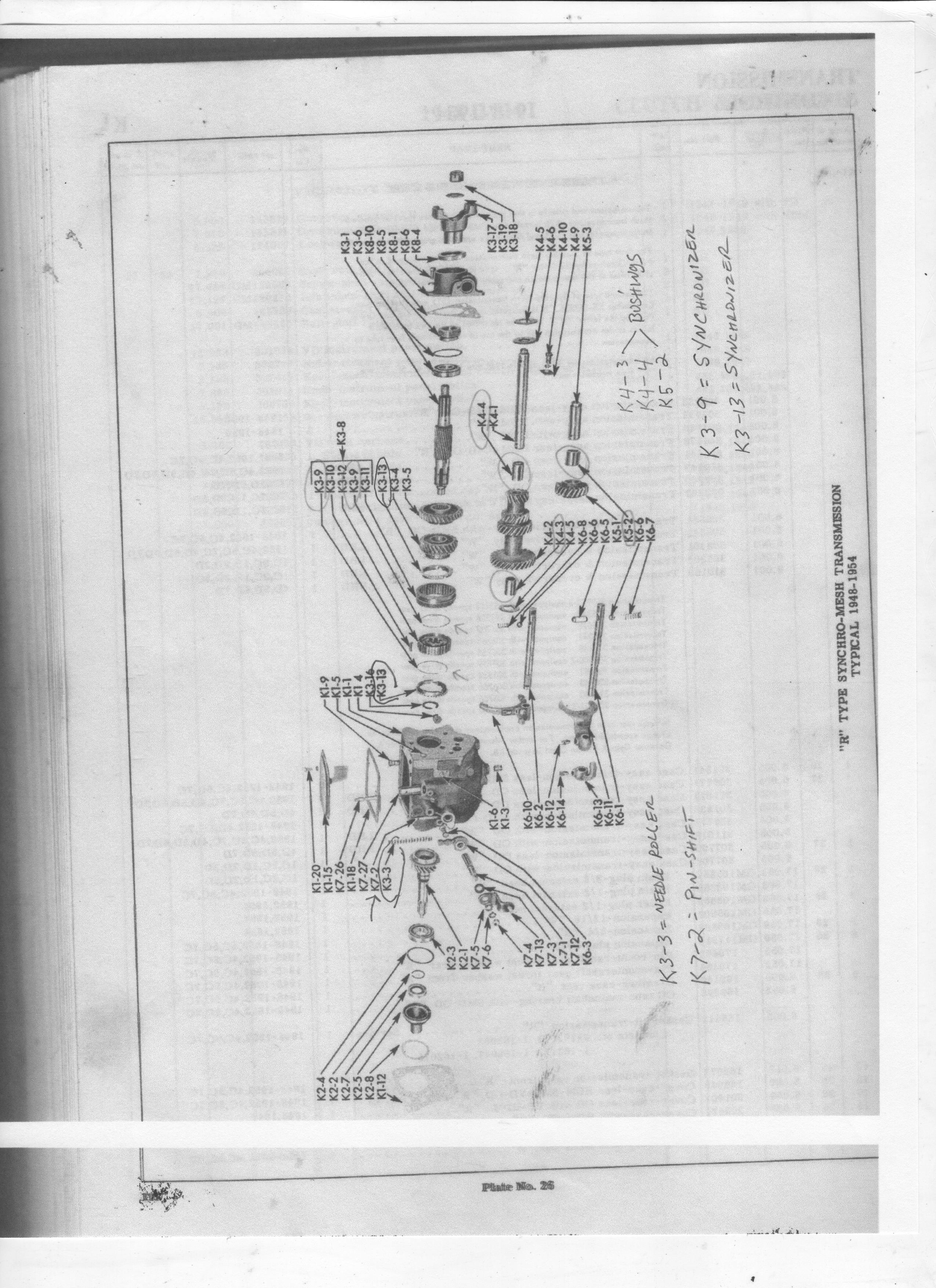

K4-4 #165855 Bushing –
Gear Cluster Rear “R”
K4-3 #306083 Bushing-
gear cluster front “R”
K5-2 #162066 Bushing –
Reverse idler gear “R”
K3-3 #16208 Needle roller –
mainshaft pilot “R” (takes 16, found only 15)
K3-9 #164473 Spring-
Synchronizer “R” parts book list only one but I have two as in picture.
I found a third one, all shiny and
torn (maybe someone left it in when they worked on it?)
K3-13 #164472 Ring,
Synchronizer “R” (2)
K7-2 # GM111845
Pin-shift “R”
