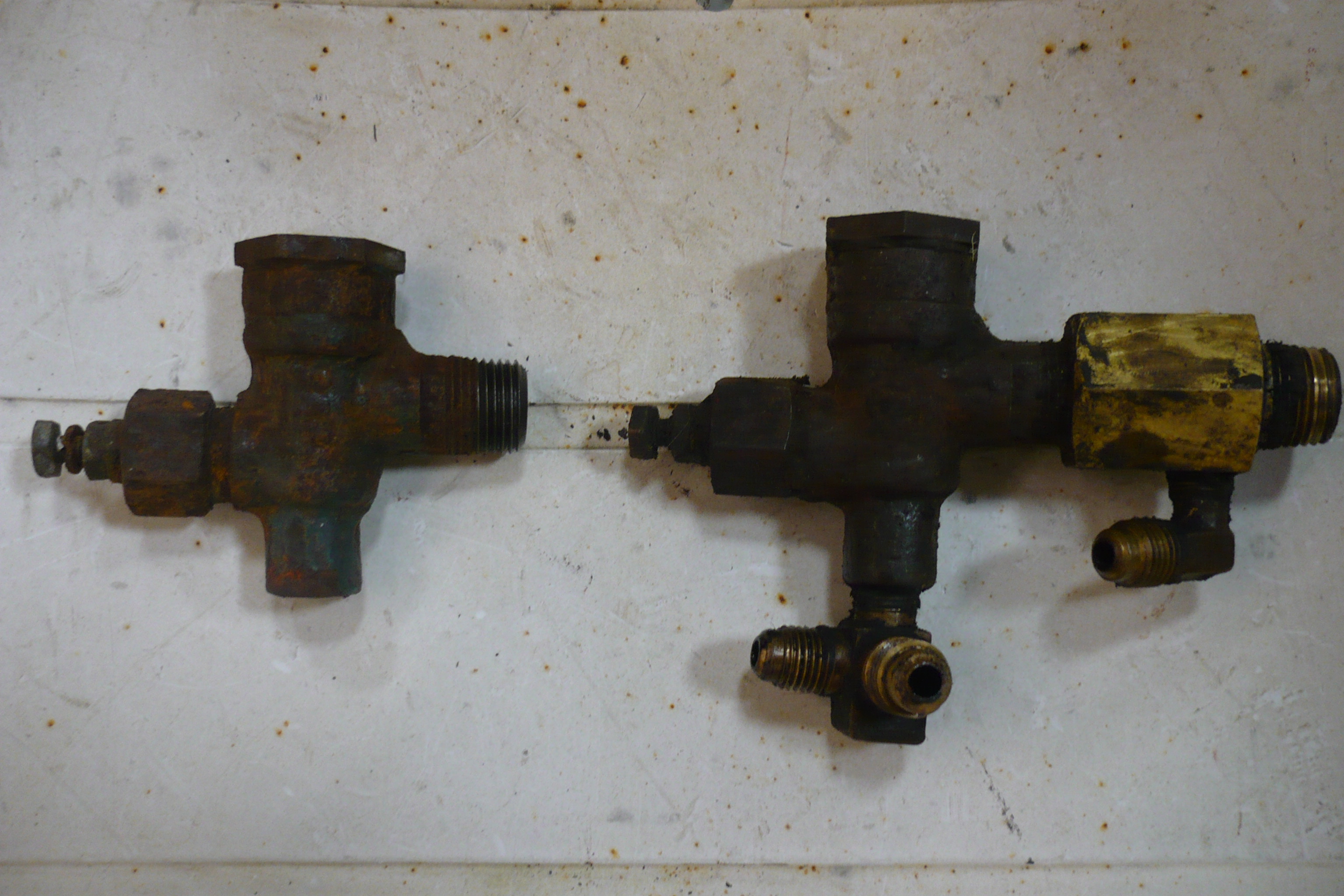

The splash lube engines have no oil pressure sending unit, in the usual sense, as they have no oil pressure, per se. They do have a special switch to extinguish the "idiot light" and is an integral part of the device known as the check valve located at the rear oil discharge line just as it enters the block. The sole purpose of that device is to generate a slight pressure (the book says 4-12 psi but it doesn't much matter what it is) in the rear line to make the light go out. An ordinary pressure switch plumbed into that line would result in a flashing light. The plunger in the Hudson unit is dampened to eliminate that issue although they still may flash about 50-60 times per min. at hot idle.
The unit on the left is the standard Hudson "check valve" assembly, with switch. The RH example is one with the optional bypass oil filter attachment fittings which you may or may not have had. Obviously, the nut/stud to the left is for the wire to the light.
These aren't available from anyone except one of our Hudson friends that has one lying around.

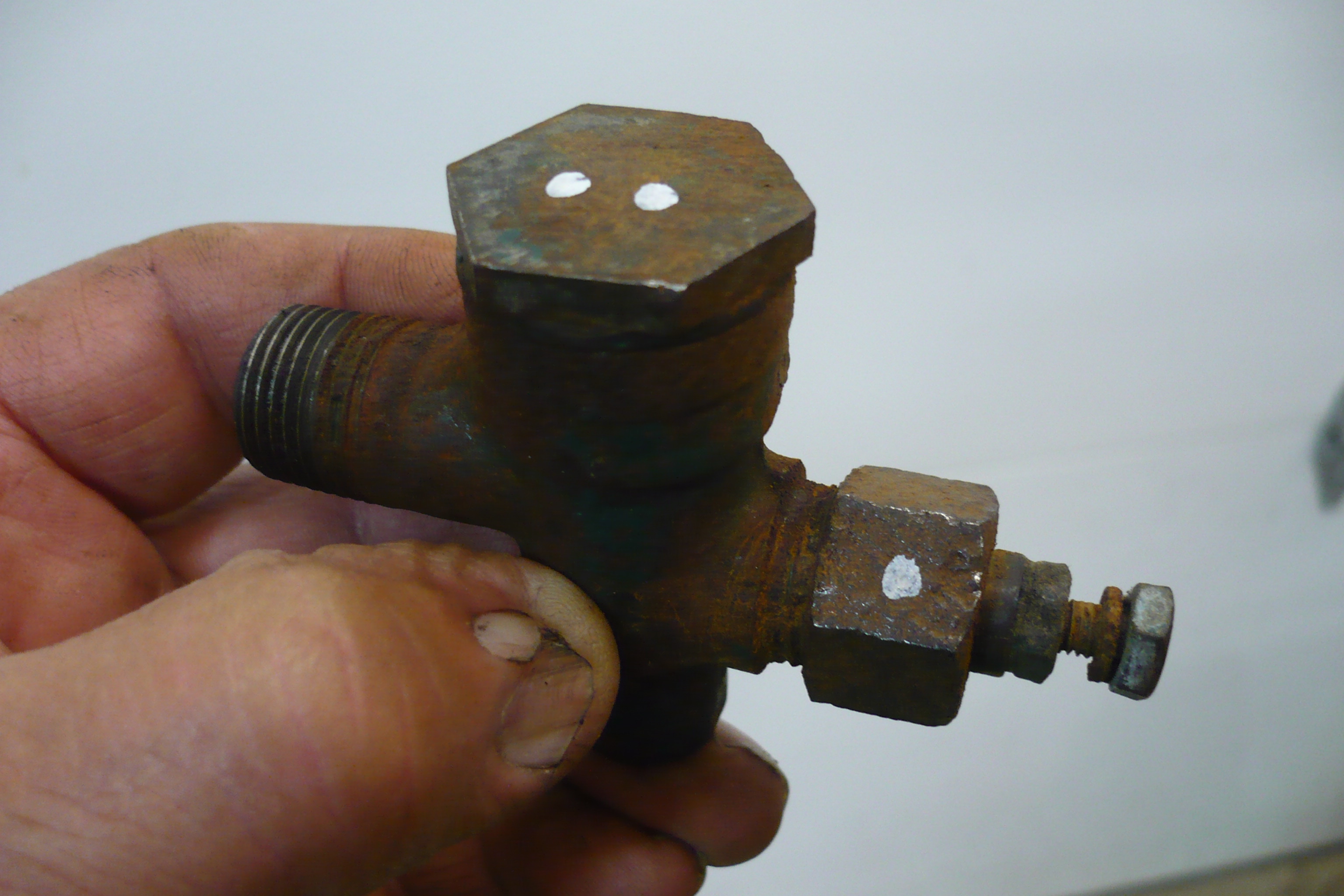

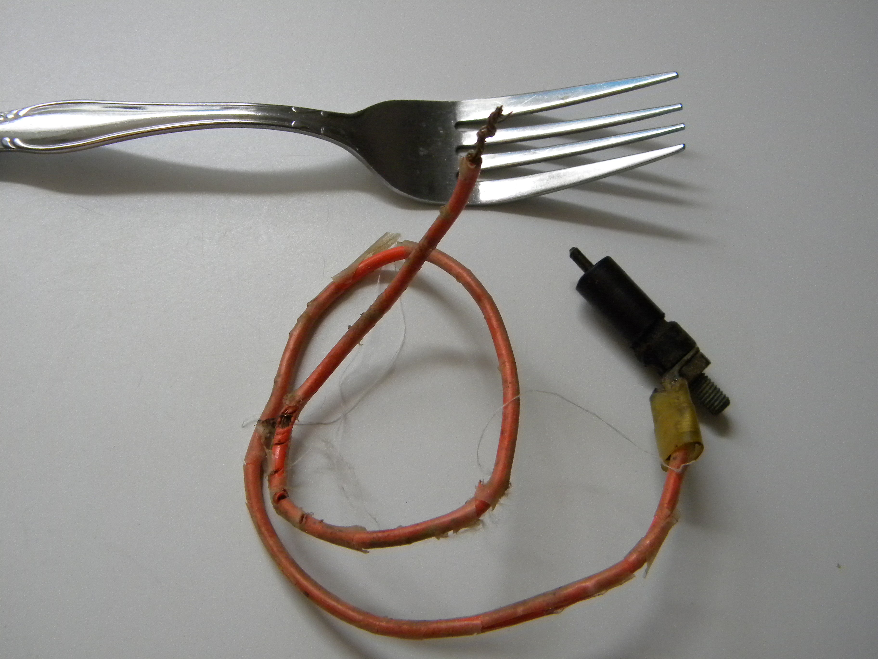

I'm not giving up yet! Lol!My engine still has the thingie attached that is in Professor Franks picture. No wire tho.Then, I find this mysterious duley-bob on the garage floor near where the engine removal crime took place. Are they related? Am I on to something here? Do I need to still keep looking or maybe send Ric some $$?Please advise...k0
Aha! You are onto something.That's the guts of the idiot light switch that came out of the device I showed you. There's a nut (look who's talking) much like a compression nut that holds that duley-bob into the body of the thingy that is still on the engine. It must be sealed in with something or it will leak oil.
Look in your can of left-over parts (there's always one of those around). it should be in there somewhere.
The little brass pin is the contact for grounding of the light.

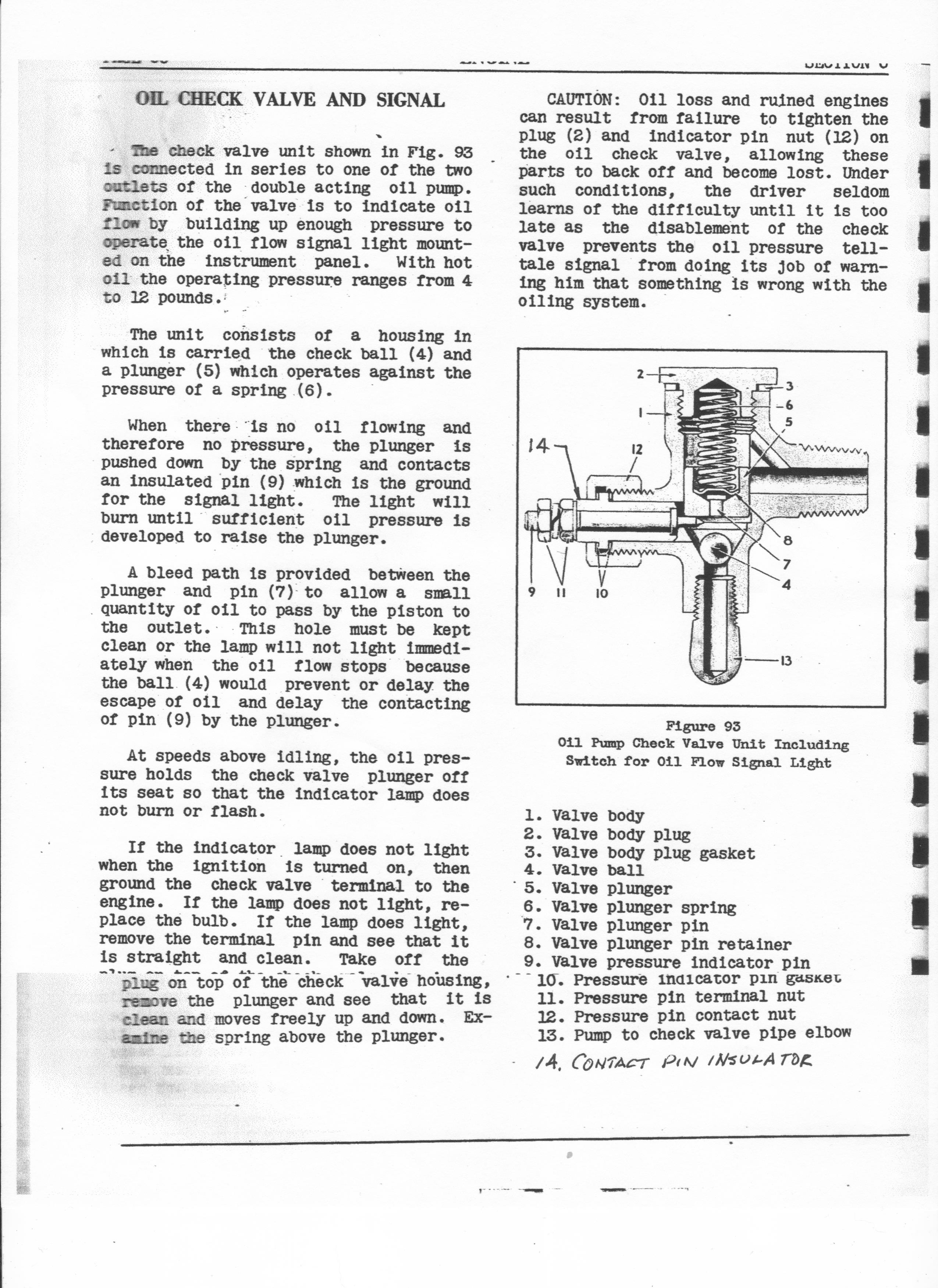

A few things I failed to mention...You may need to remove the Valve body plug (two dots in the photo, Item 2 in the sketch) in order for the plunger (5) to move upward so the tip of the brass pin will go in all the way. The nut in question is item #12 (one dot in photo) and the two seals are #10, one on each side of the insulator flange. The insulator is Bakelite so the nut probably shouldn't be tightened very tightly for fear of breaking that flange....that is, if you find the nut.0 -
