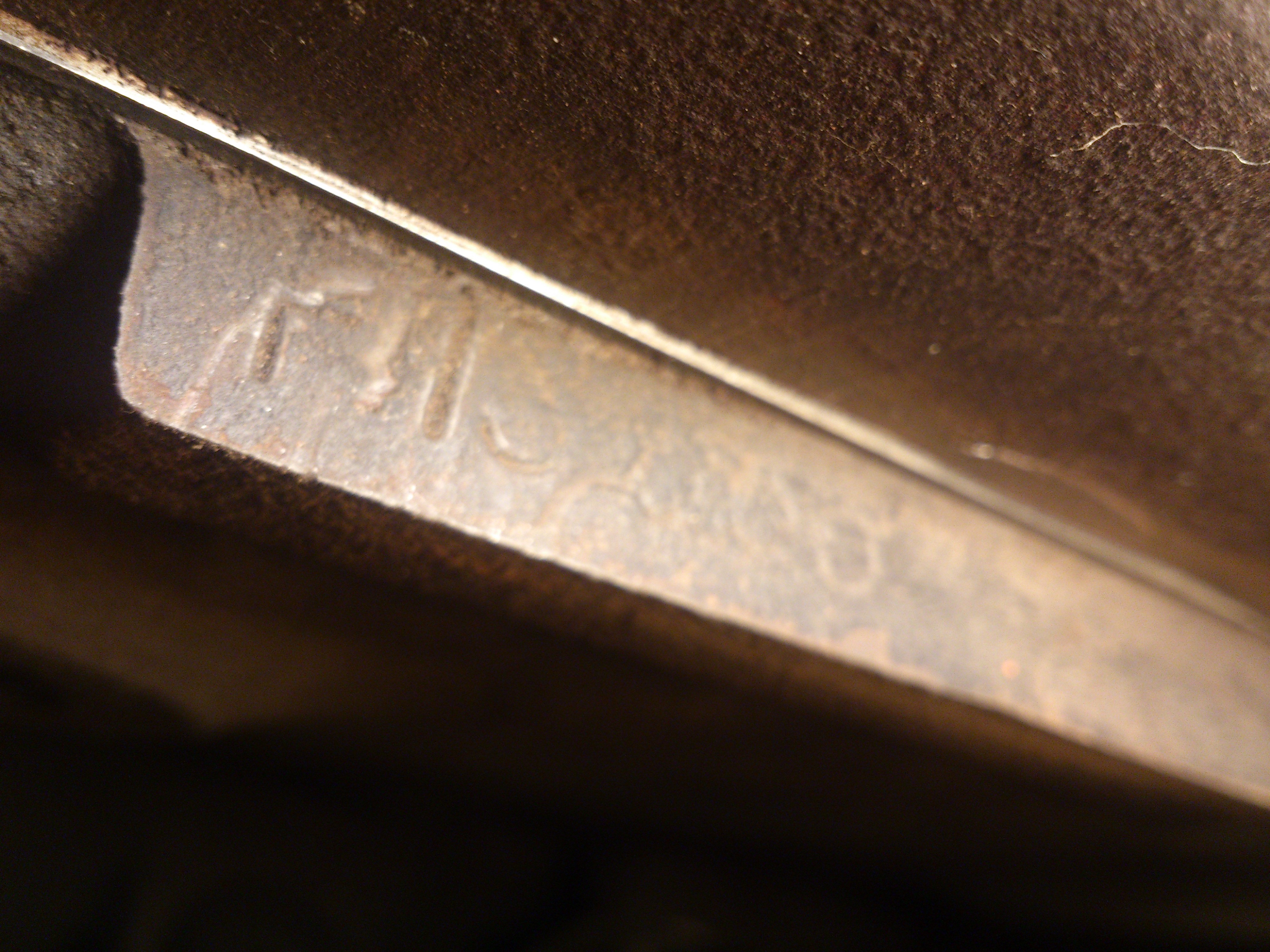

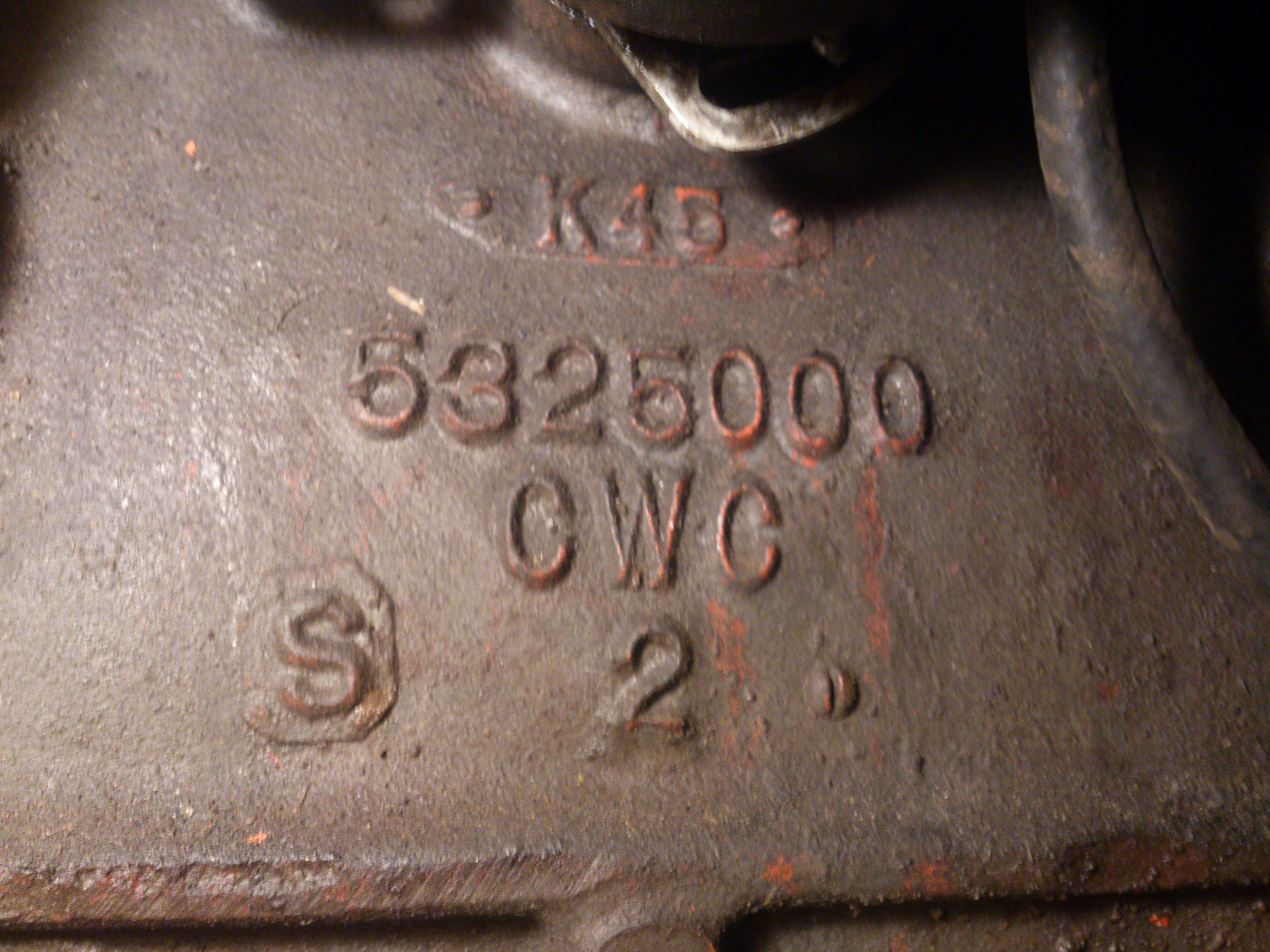

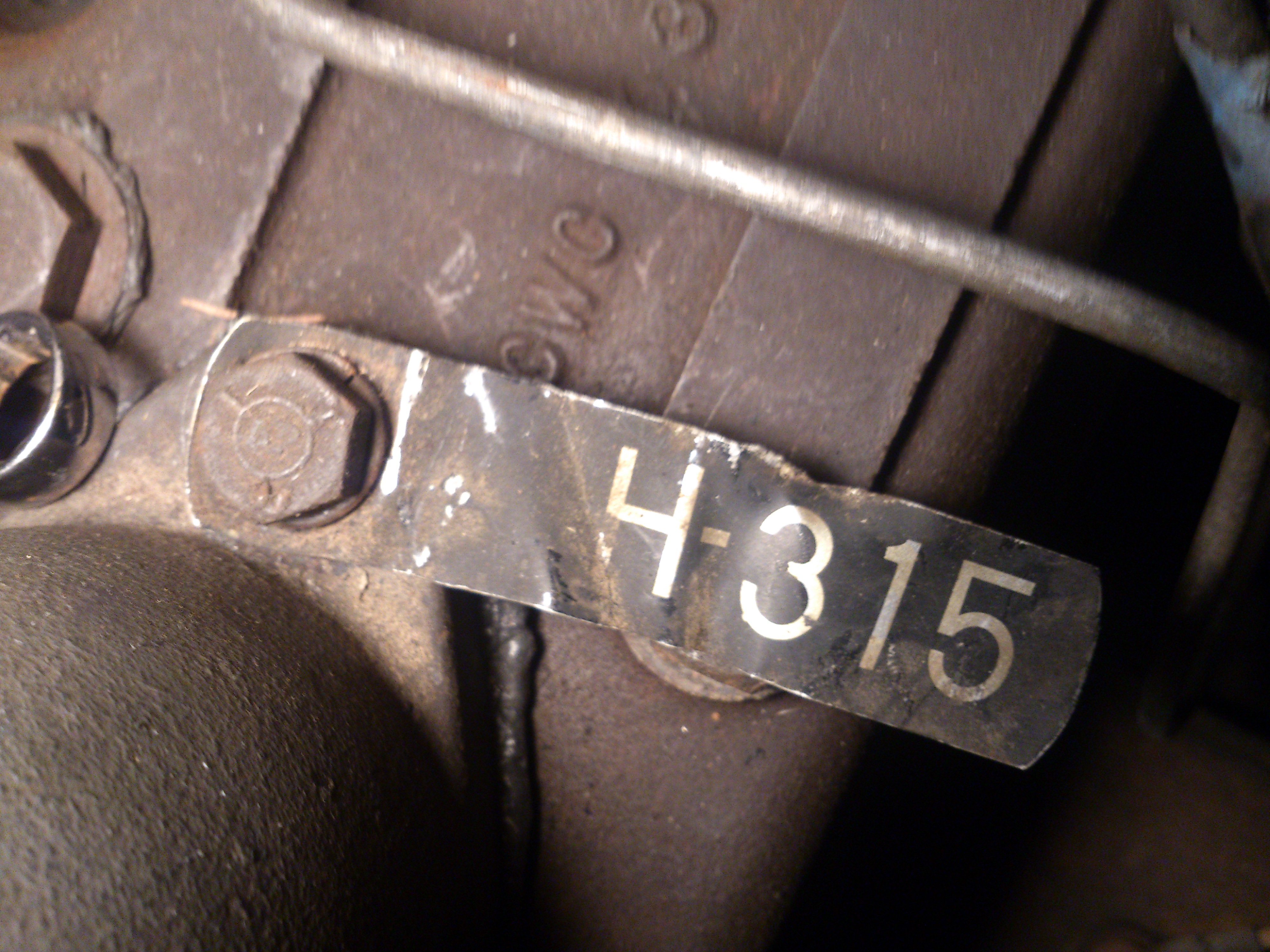

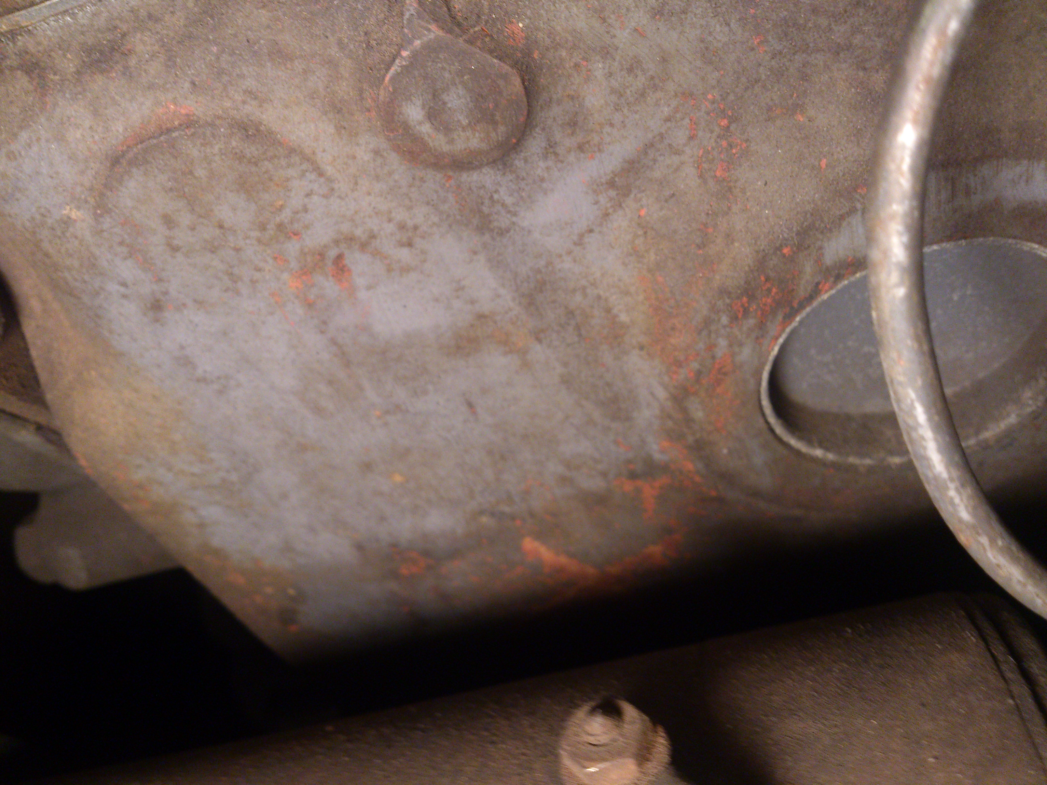

Here's some more pics... some red paint peeking out from under the grey but might be some sort of primer?Serial number on the nub of the block near the head is mostly obliterated and looks to begin with a F13_____ . Also weird tag of H-315 on the coolant neck.0
The location of the serial number on the block looks to be of a '55 or '56 engine.
My 55 engine was red under the gray too. Looks like it was primed with Glyptal before any machining was done as every unmachined surface on the block had the red,even the edges of the water jackets on my never run 55 motor. The hot tank removed the gray in short order but didn't touch the glyptal,so I left it.
