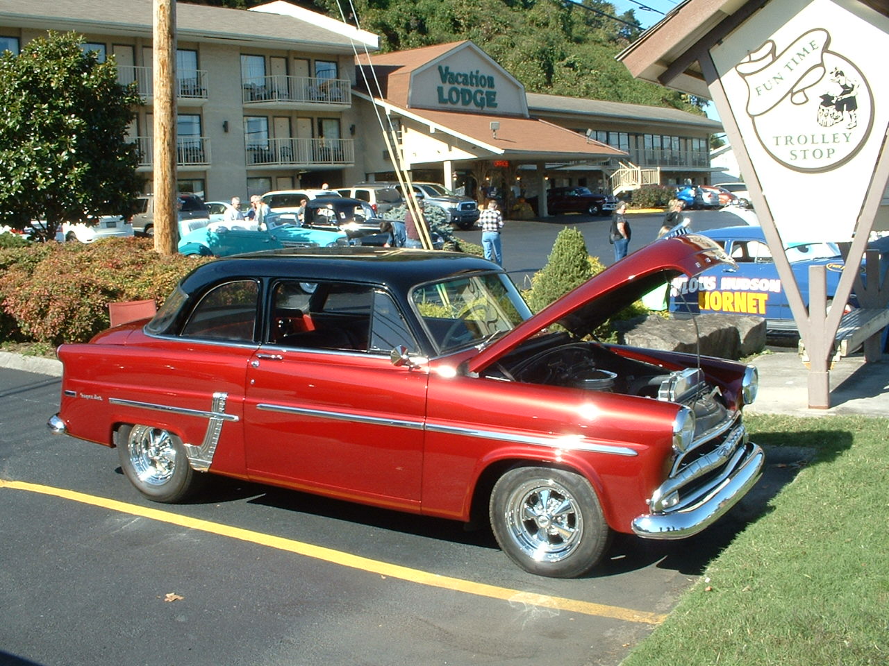

LHudsonLarry... did you drive you Hudson to the Pigeon Forge meet? I saw pictures of a red and black Jet.. yours?0
Hey Ken, No that was not mine. I only wish mine looked so good. I am slowly working on mine but have not gotten much done. The one at PF was from Knoxville,TN. I was street rodded. It had 350/350 treatment. It had a killer paint job on it.0
