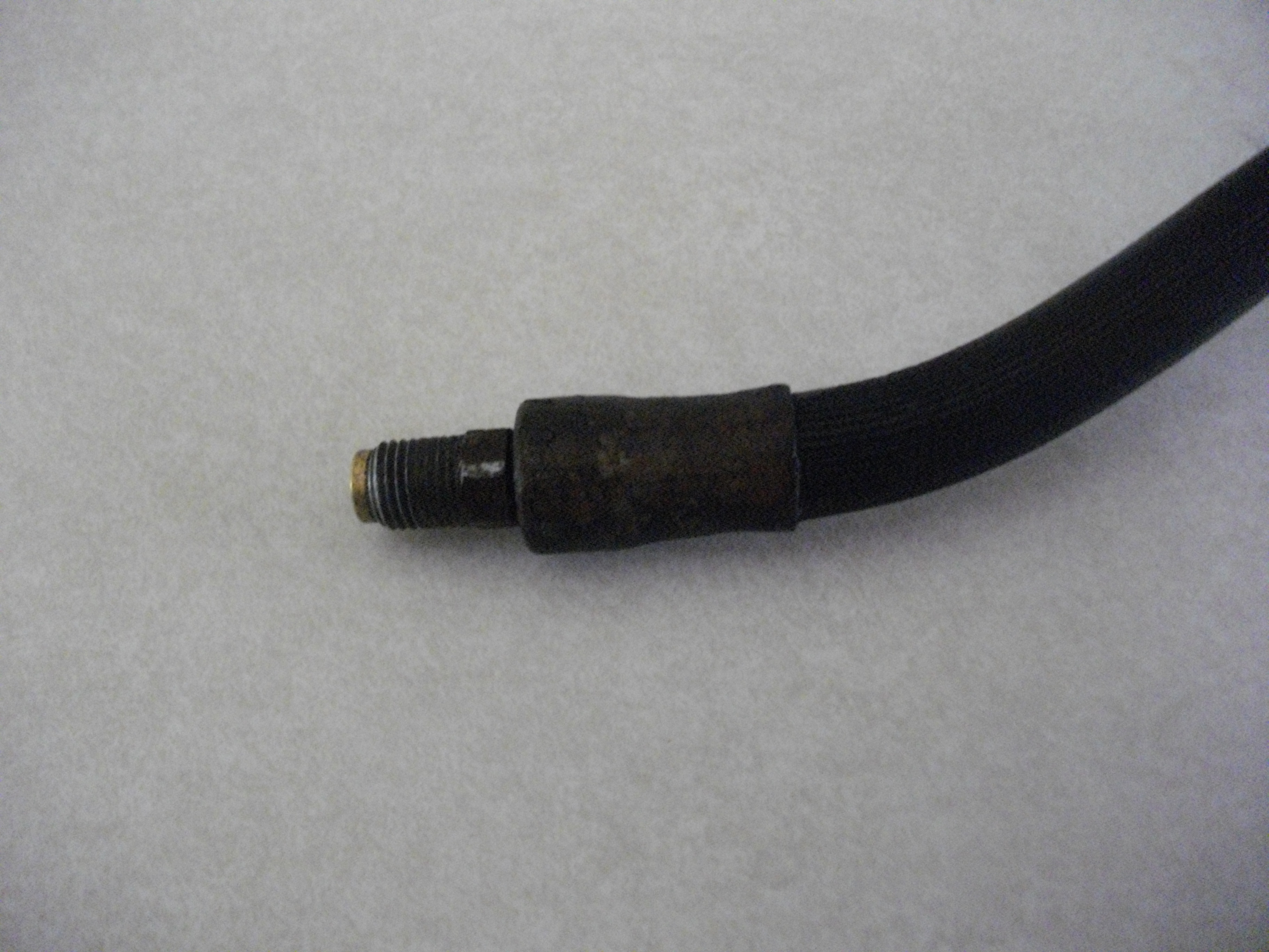

Tim,It could be something else but I had experienced a hard pedal in my 54 years ago. I sent my Treadle-Vac to Karps Power Brake in California to resolve the issue. After installing my rebuilt unit back in the car I still had a hard pedal. I removed the rubber hose we are speaking of and found that I couldn't even get air through the hose. The rubber had swollen and deteriorated badly right where the fittings are crimped on. I ran a small drill through each end and that opened the hose back up, don't do that as a permanent fix!I searched high and low for a pre-made replacement hose, there were none to be found. I was lucky enough to have a Tompkins about 30 minutes away from me. They made a new hose up while I waited.I think I still have my old original hose that I can take in to have a new one made for you. Let me know if I can be of help.John Forkner0

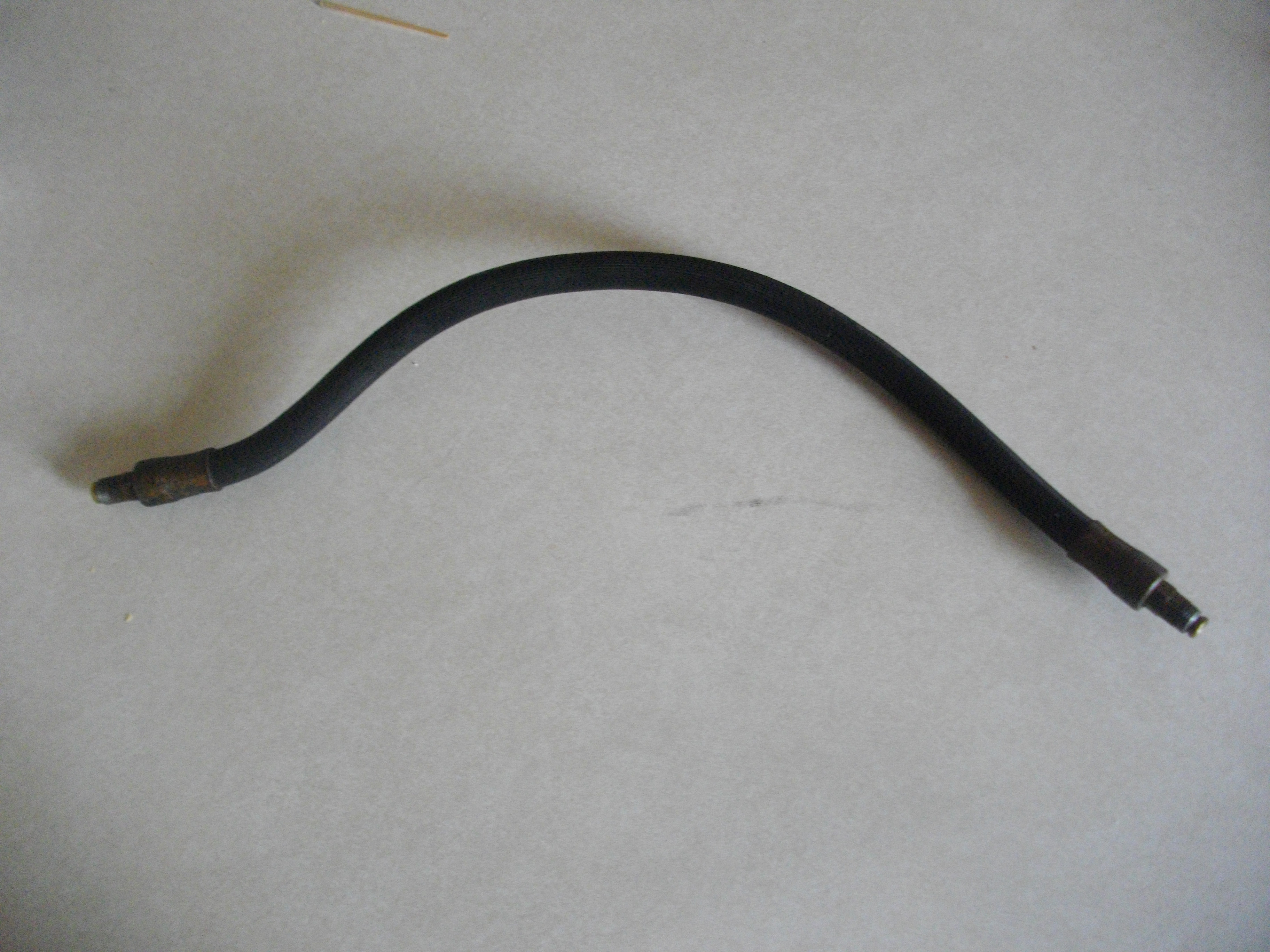

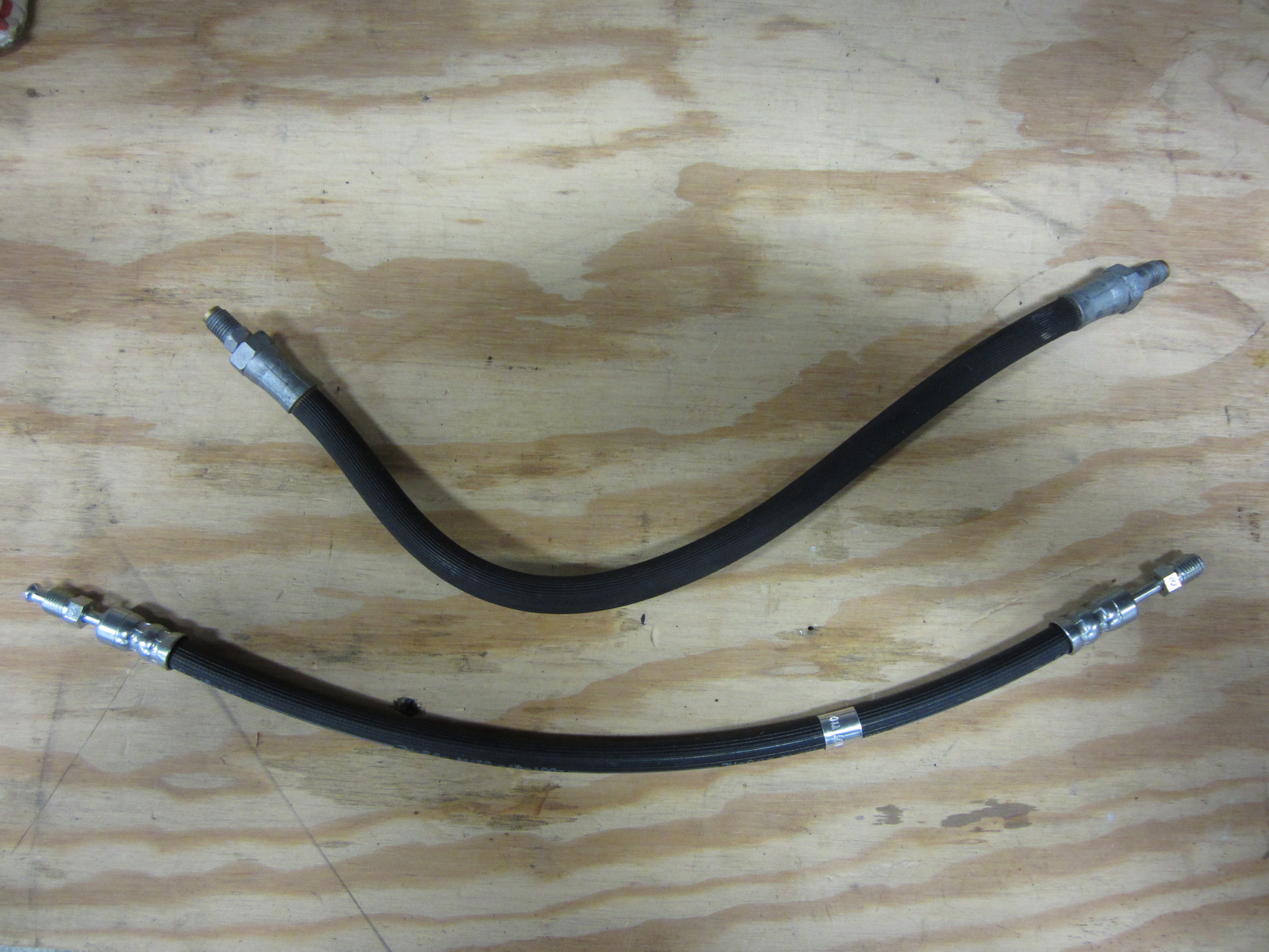

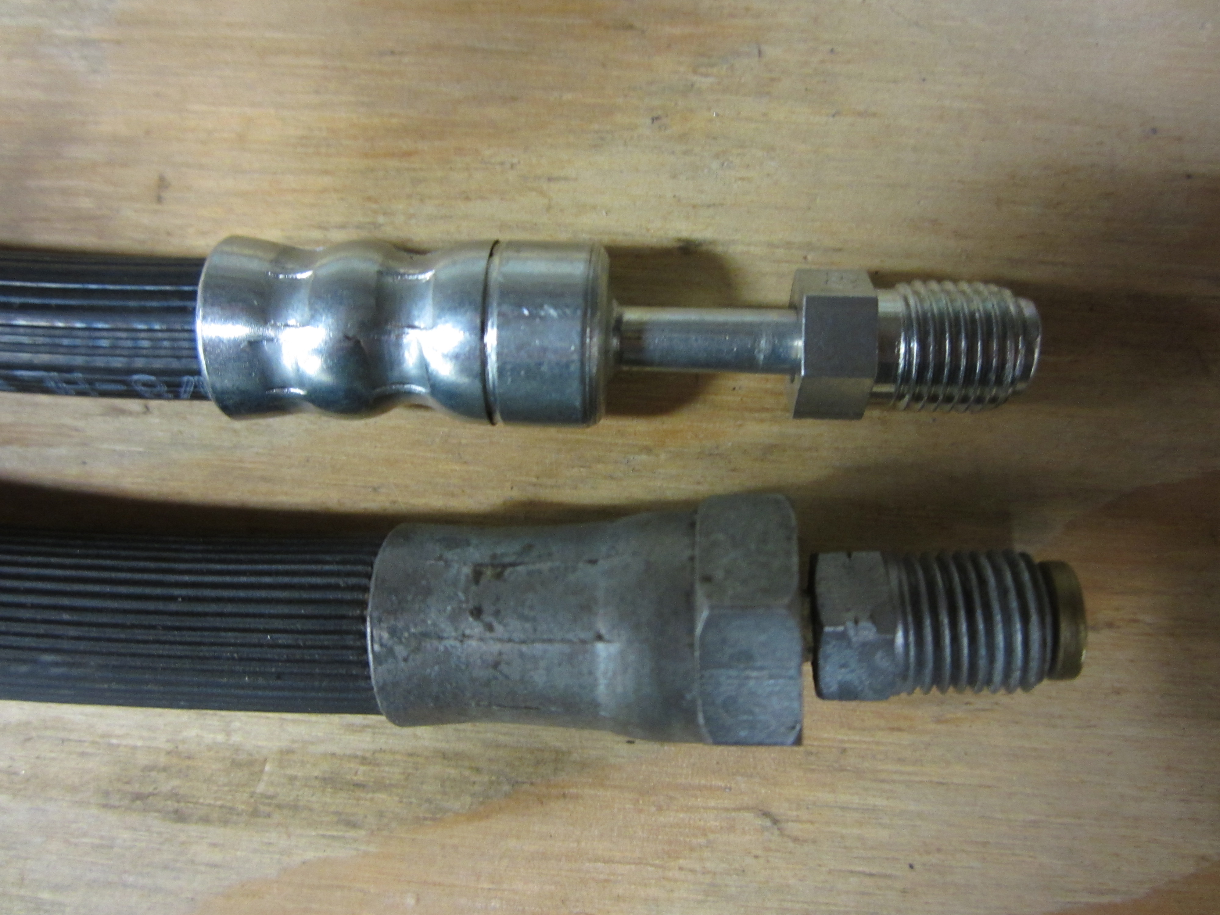

John,One other thing. I assume that all '54s with Power Brakes use the same hydraulic hose but just to make sure we're both on the same page, here are a couple of pictures of the hose and fitting from our car. The whole thing measures 16 1/2" from end to end. Thanks again for your help.Tim in WI.0

Tim,I needed to go into town this afternoon so I stopped by Tompkins. I had one made from one of my old ones, here's what I came up with.Length 16.75, ribbed hose, correct ends with the exception of no hex ends on fittings. $30.94 plus tax and shipping.If you want they can make one up with flexible steel lines for about $10.00 more.You can call them directly and order over the phone with the information on the invoice. Here's the breakdown on the codes; BQ101 is the ribbed rubber hose, HF16, HF16 are the two end fittings, 16.75 is the length.If you want to buy the one I had made you are welcome to do so, but you are not obligated.Hope this helps.John Forkner
