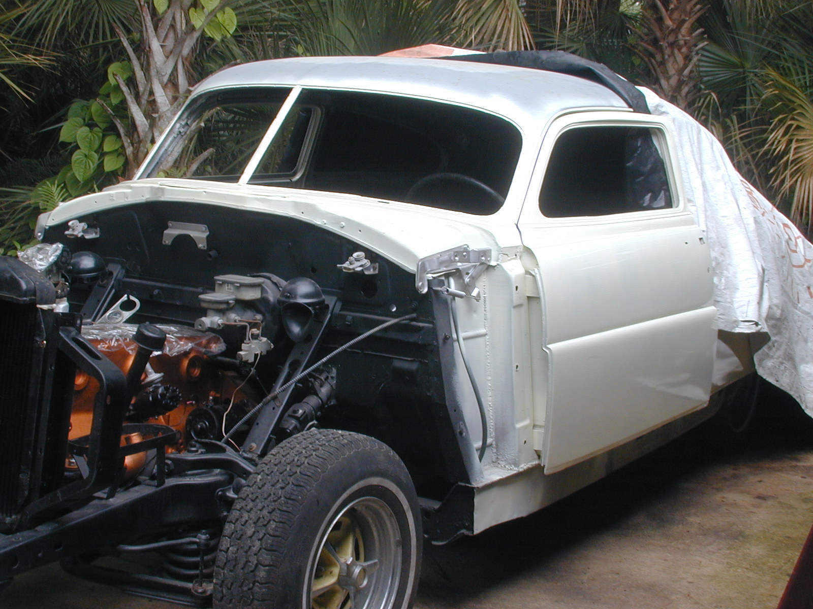

My resurrection of the 49 two door sedan included finding headliner bows. I have been able to put a correct set of 6 together. The car has grommets in the roof for 7 bows. The #7 grommet shows indentations where a bow was installed . The parts book only lists 6 for the 48-49 two door sedan and 7 for a four door. I have a number 7 from a four door which I may end up using.. I guess what I need is a picture of the headliner on a 48-49 Two door sedan showing the rear area around the back glass. Or someone to tell me how many bows are in a 48-49 two door. The 1950 and up two door shows 7 bows. The 50 and up had a larger rear window and uses a different #7 bow than the 48-49 sedan. At this point I am puzzled. I posted wrong picture but can't figure out how to delete it.

I was always inclined to believe that the four door and two door had the same roof. There are different numbers for four door and two door.. Didn't make sense to me So the book must be in error. At least through the pieces I had I was able to make up a set.. I hope the new headliner works... when I get it.
