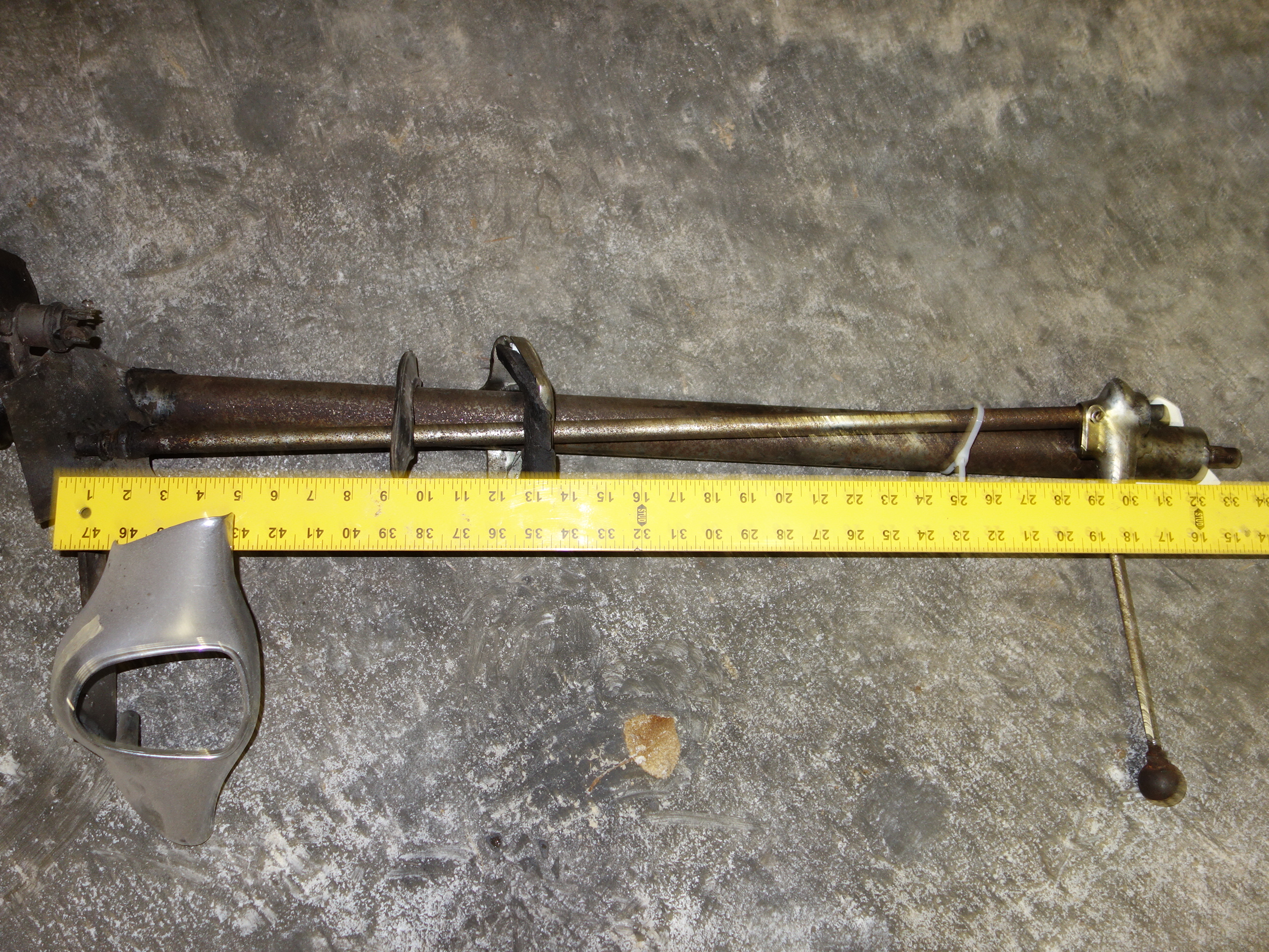

Kerry,Today I noticed I have a steering assembly that is out of the car. It has a tag on it that says 53 Wasp. I measured the length of the shifter tube to be about 37 1/4 inches.Rob0
Ok, I found my orginal notes, I measured 38 7/16" total length. Rob, would you double check your measurement? I may have held the tape at 1" mark .
Also, is yours for a standard shift?0 -

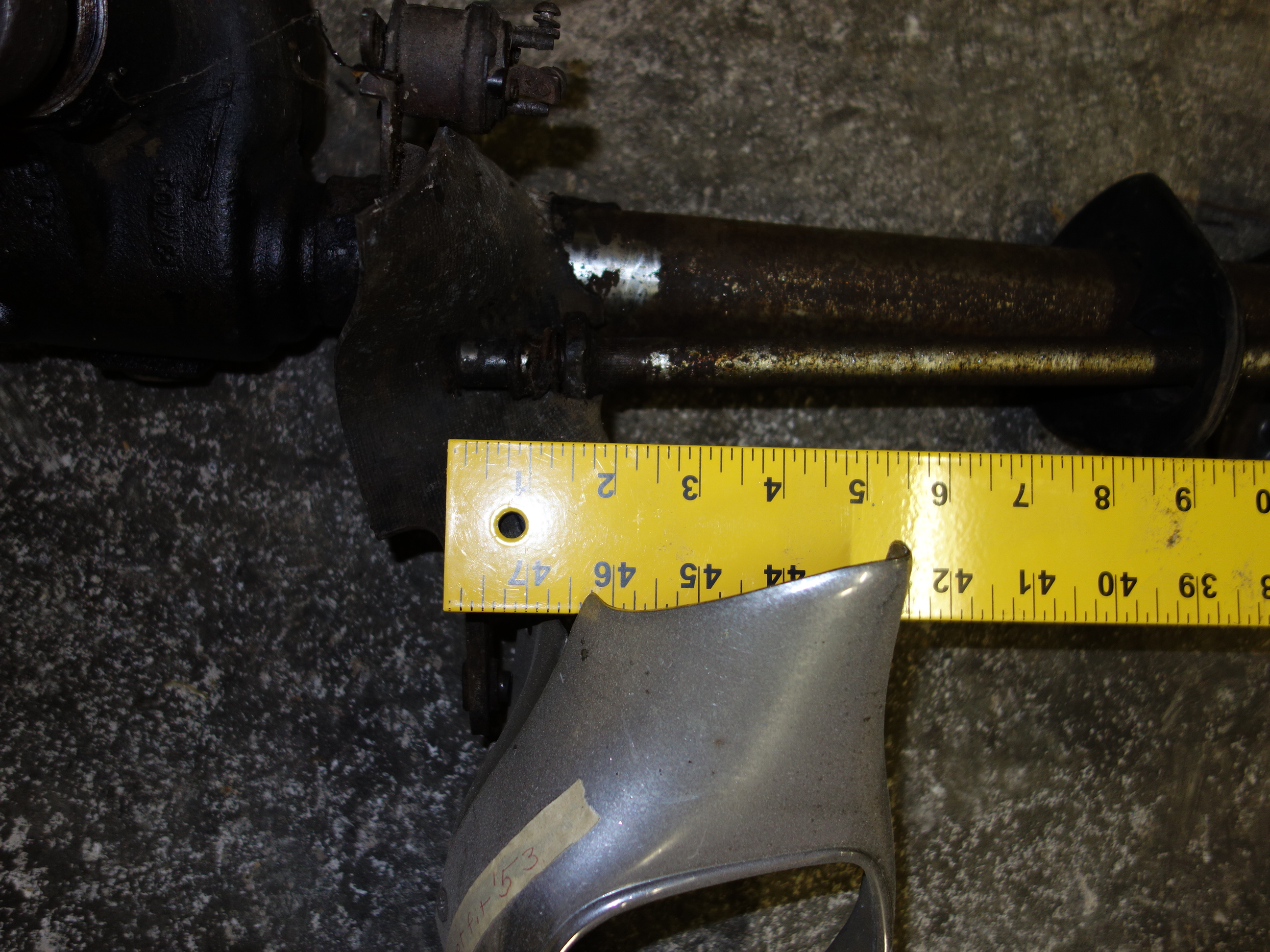

Kerry,I'm sorry for my sloppy detective work! Yes it does appear to be for an automatic and not only that but I measured wrong anyway. It measures about 31 1/4 not 37 1/4 inches. Here are some pics with a ruler nearby. Unfortunately the ruler covers up the part that shows the part that makes it for an automatic. I'm having a bad day...LOL.Rob0
Quadster- I saw pictures of that one. Hudson only offered ps in 54. The parts are not easy to find and need rebuilding if you do. Very costly to find, rebuild and install.
Thanks Bob, that is what I suspected with your measurement. I will be doing one of the conversion on an automatic as well.0 -
Ok, after bending-welding the new tube length is 32 7/6" so it didn't add much at all.
