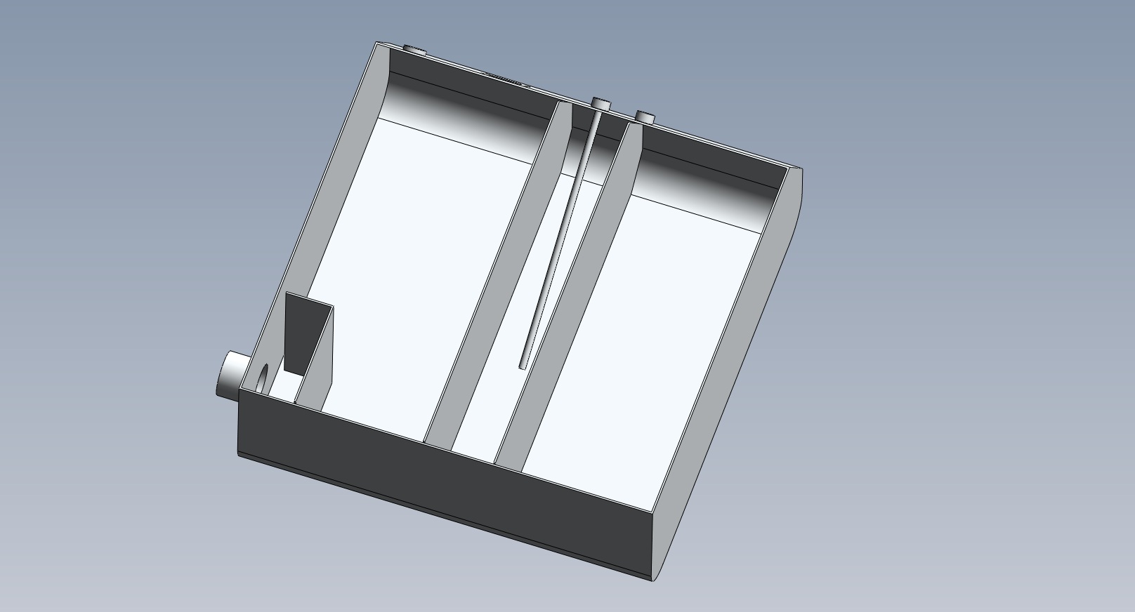

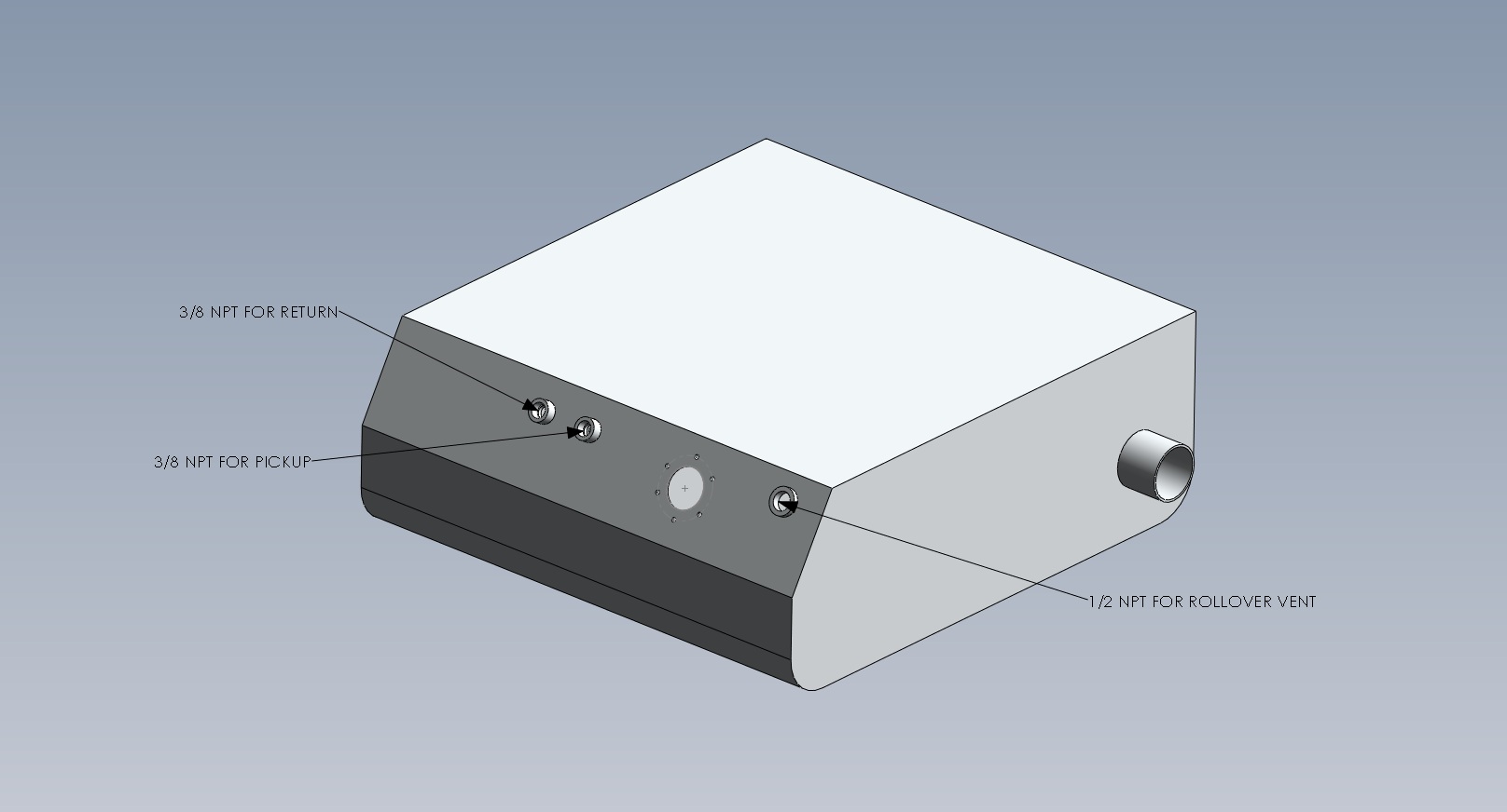

Boyd Welding in Florida has given me a decent price on a Hudson gas tank that I have designed. Fuel tanks are one of their specialties, and I found their website while searching for parts to modify a polytank to fit our cars, http://www.fueltankparts.com/ . Anyway, I saw they did custom tanks so I sent off a drawing to see what they could do. The inlet would use some 2in fuel hose and the stock tank neck cut off or a new one made up.
$425 for the tank you see below, uses the standard Hudson sender:

If you want to see the drawing, please send me a message. Any suggestions, please offer those too - this was a quick design on a Saturday morning addressing some issues I had with the Hudson tank.

I'm happy to hear that someone has moved ahead on this project! This isn't much more than it would cost to have the old one professionally cut open, cleaned, welded back together and then coated inside & out.
Before placing your order you might want to announce this in the classifieds of the WTN, where there is at least as large an audience as here on the Forum. I believe the ad deadline is October 1.
It would behoove everyone if you were able to wait until you had at 10 or even 20 orders, because the more who order, the lower the cost. If you got 20 people (as I understand it) that brings the cost per unit down to $340 which is "Chevrolet territory". Even if you only got 10 to agree to order, it's $383. So, do advertise this in the WTN as well as here (and I see you've already mentioned it on the other Hudson Forum as well).
