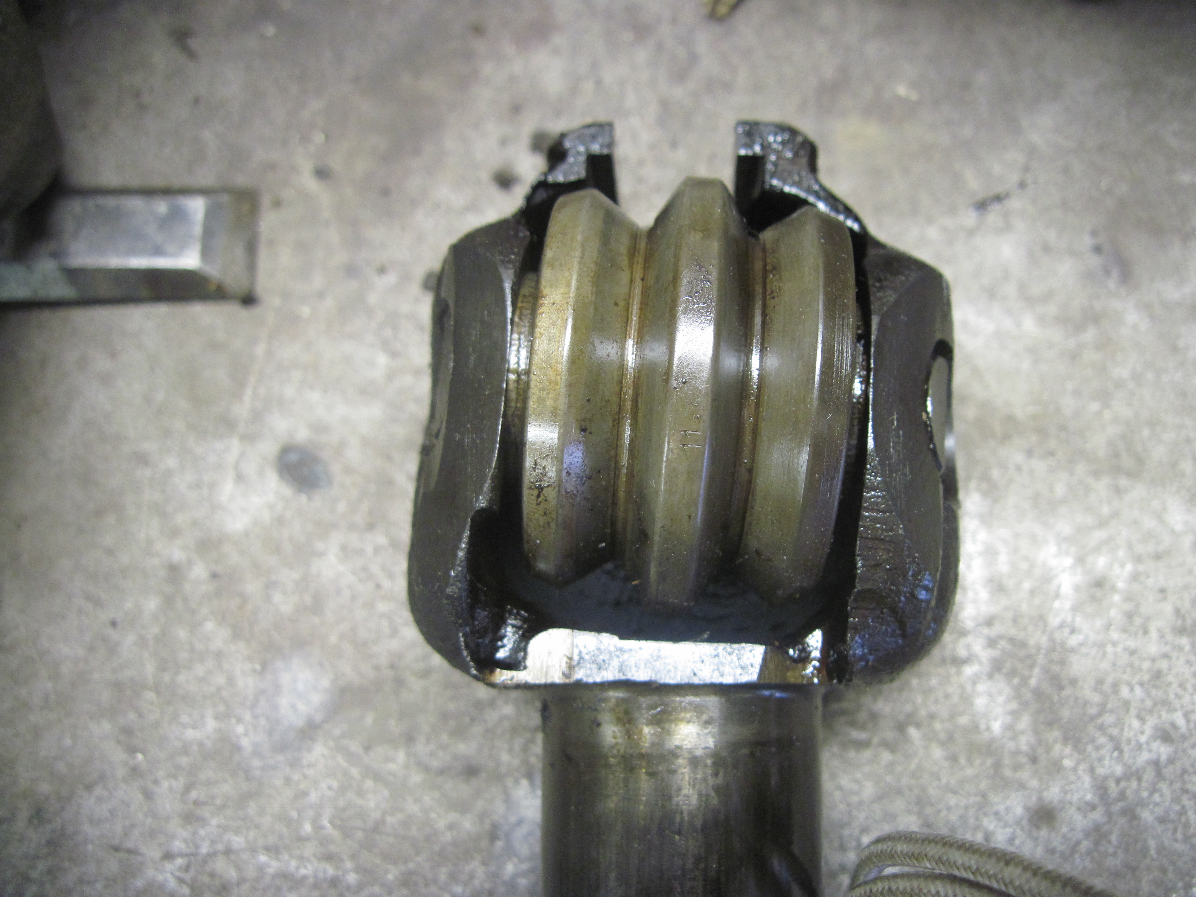

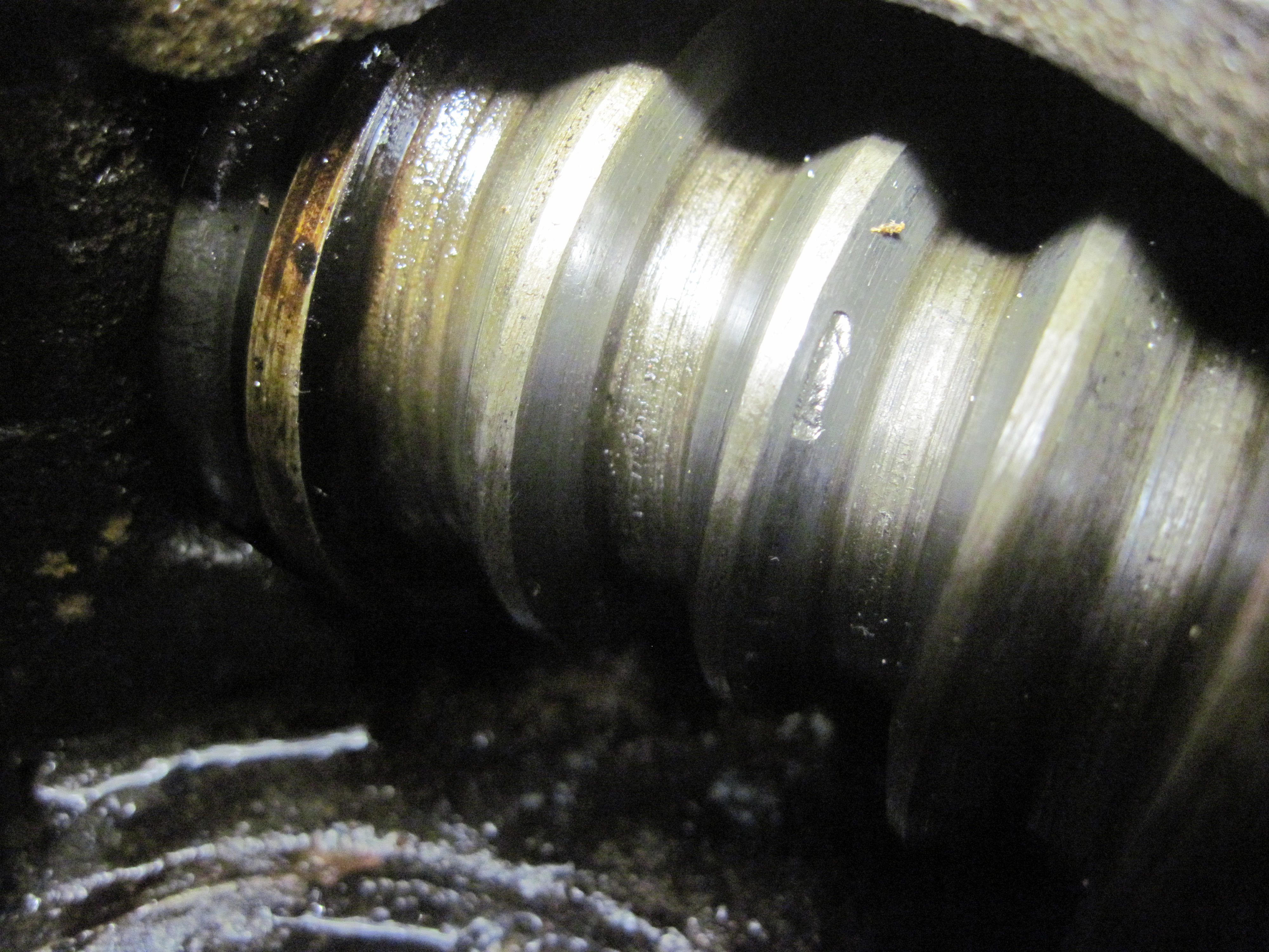

Who is reproducing the gear? Please keep us informed. My 51 Pacemaker steering has a 'catch' in it and I have a 54 Wasp gear I just took the cover off and it has a miner pit starting. I know there are companys that rebuild them at much expense, but if parts were avaliable I can do it myself.

Thanks!I have been told that the 1954 will fit my 51, knowing I have to change the tube/shifter over. Does anyone know the difference as the Hollender interchange listed 1950-1953 as one but listed 1954 as by itself. Did Hudson upgrade the box, different ratio better material ???? I was also just on the Lares Website and they list it as 50-53 and then 54 by itself..Jim SpencerWestern New York Chapter0 -
Jim, Midwest manufacturing said they would rebuild it with new roller and new worm gears, install new bearings and seals- for 375.00. I have a spare box I am sending them for rebuild.0
That seems like a very fair price. I will definately give that serious consideration. wonder what shipping would be? Thanks for the info.0
