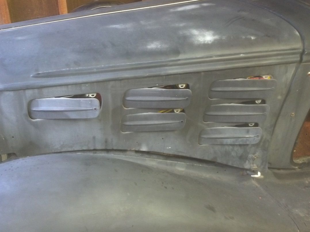

Well I guess the hood I have is the KU because it is too long by about 5" for the length between the cowl and the grill shell. My hood had 6 doors on each side that can be opened if that helps. photo attached.

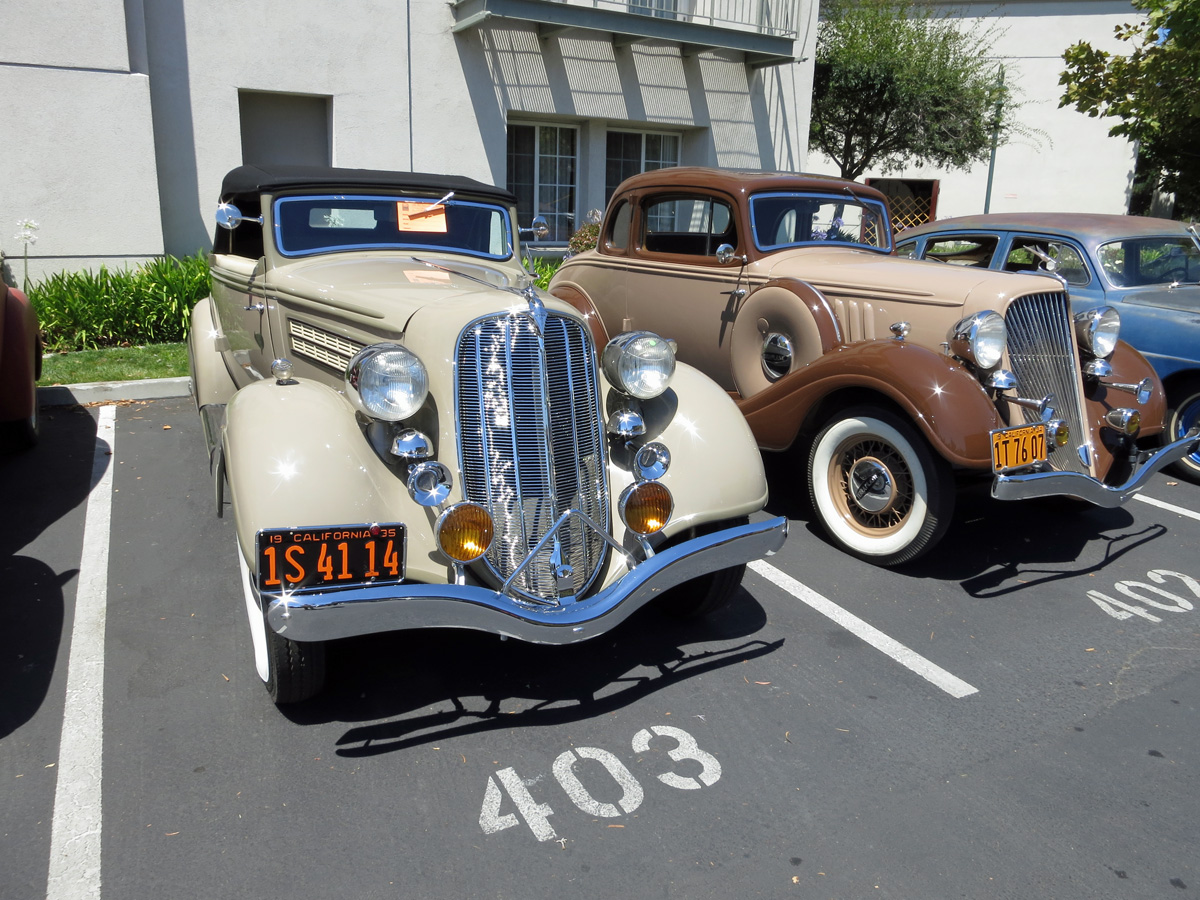

The brown one on the right is a 34 Terraplane K coupe (next to 35 Hudson convertible) - no "doors that can be opened." The white one claims to be a 34 T KU, as does the black one. So, if those are KUs, then hood vents look the same for 34 T coupe K and KU. Yours looks to be a Hudson hood; not Terraplane, no?
That is very good information. My car is registered as a 34 Hudson coupe not a Terraplane but doesn't list a model. I am getting the feeling this car was pieced together. My right front fender has the spare tire well just like the brown one. Someone moved the fenders forward to accommodate the longer hood. This caused the fender to body fit problems I am trying to correct by replacing the hood and bring the fenders back where they are suppose to be. I am still looking for a K model hood.

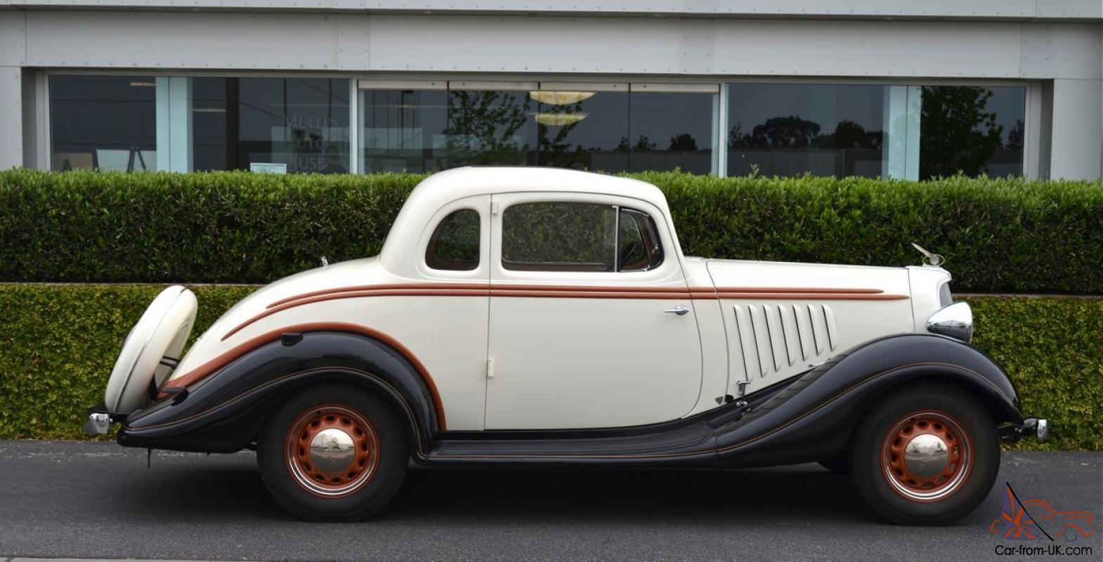

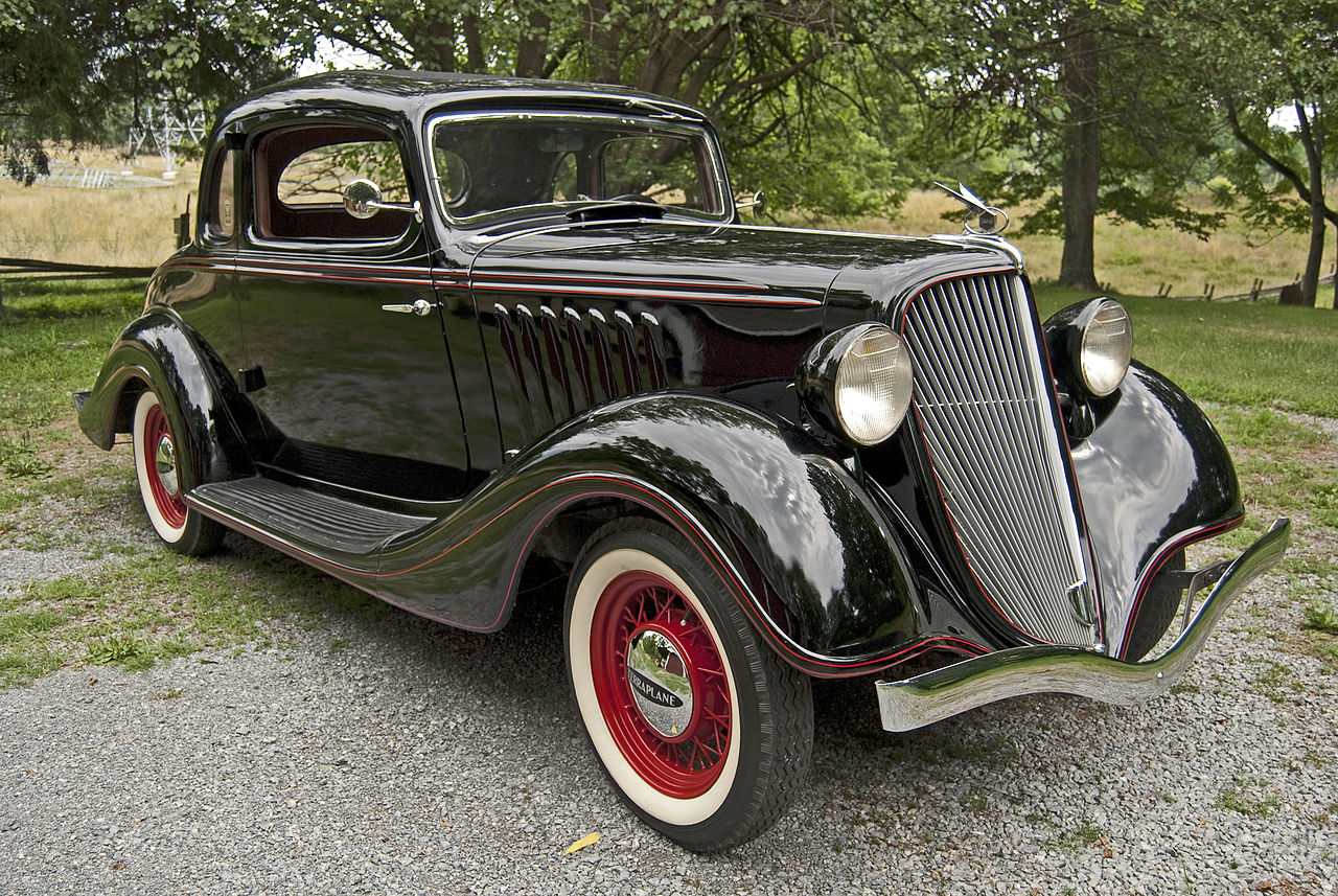

Here are some 1935 coupes:
(This may be an English model, as the wiper is on the right side as is -- no doubt -- the steering wheel. I'm not sure if the chromed headlight bucket is standard; it might be from a Hudson.)

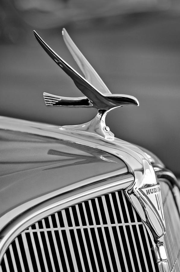

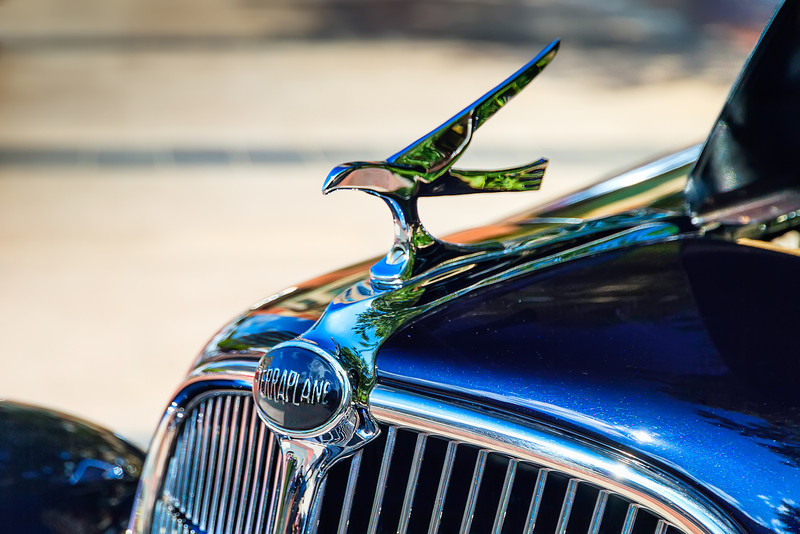

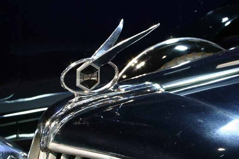

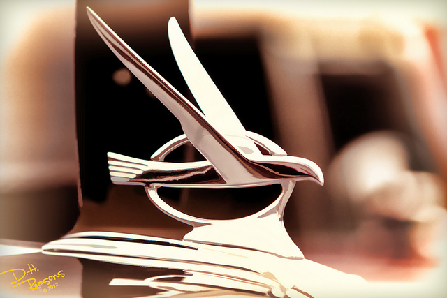

Having had a 34 Terraplane K coupe for 41 years, I guess I can understand how Hudson's nomenclature might confuse people. First off, let's not confuse 1934 with 1935, and let's not confuse a Hudson coupe with a Terraplane coupe ...in 1934, look for different hood ornament, hood, hubcaps, taillights, etc. between Hudsons and Terraplanes. Between 1934 and 1935 Terraplanes, see hood ornaments below.
You know the drill; something like ..."Essex Terraplane" from 1932, then dropped Essex and went to just "Terraplane" in 1934, then to "Hudson Terraplane" in 1938.
So, if that blue resto-mod picture is the car, then it looks like 1935, as noted above.
Thank you for the great information. My hood ornament is the first one pictured. It has the circle with the hexagon shaped center with Terraplane.

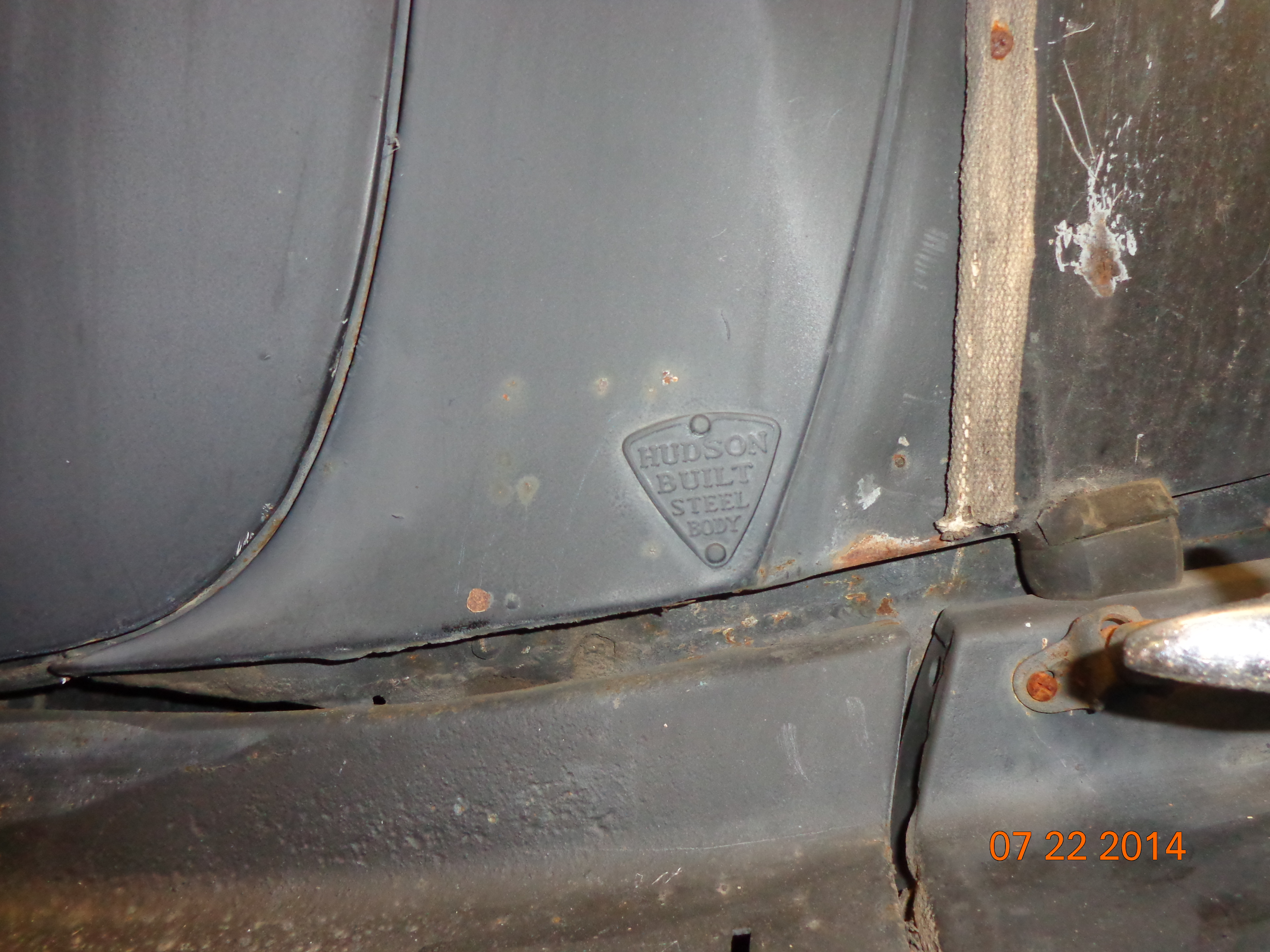

What is the difference between a Hudson and a Terraplane? On the lower right front corner of my body there is a tag rivited on that says "Hudson Built Steel Body". Did Hudson make the Terraplane? Is the Terraplane a cheaper model of the Hudson line?
Yes, Hudson built the Terraplane. Yes, it's the cheaper model. I wasn't aware until now that Terraplanes had the tag. I thought only Hudsons did.
