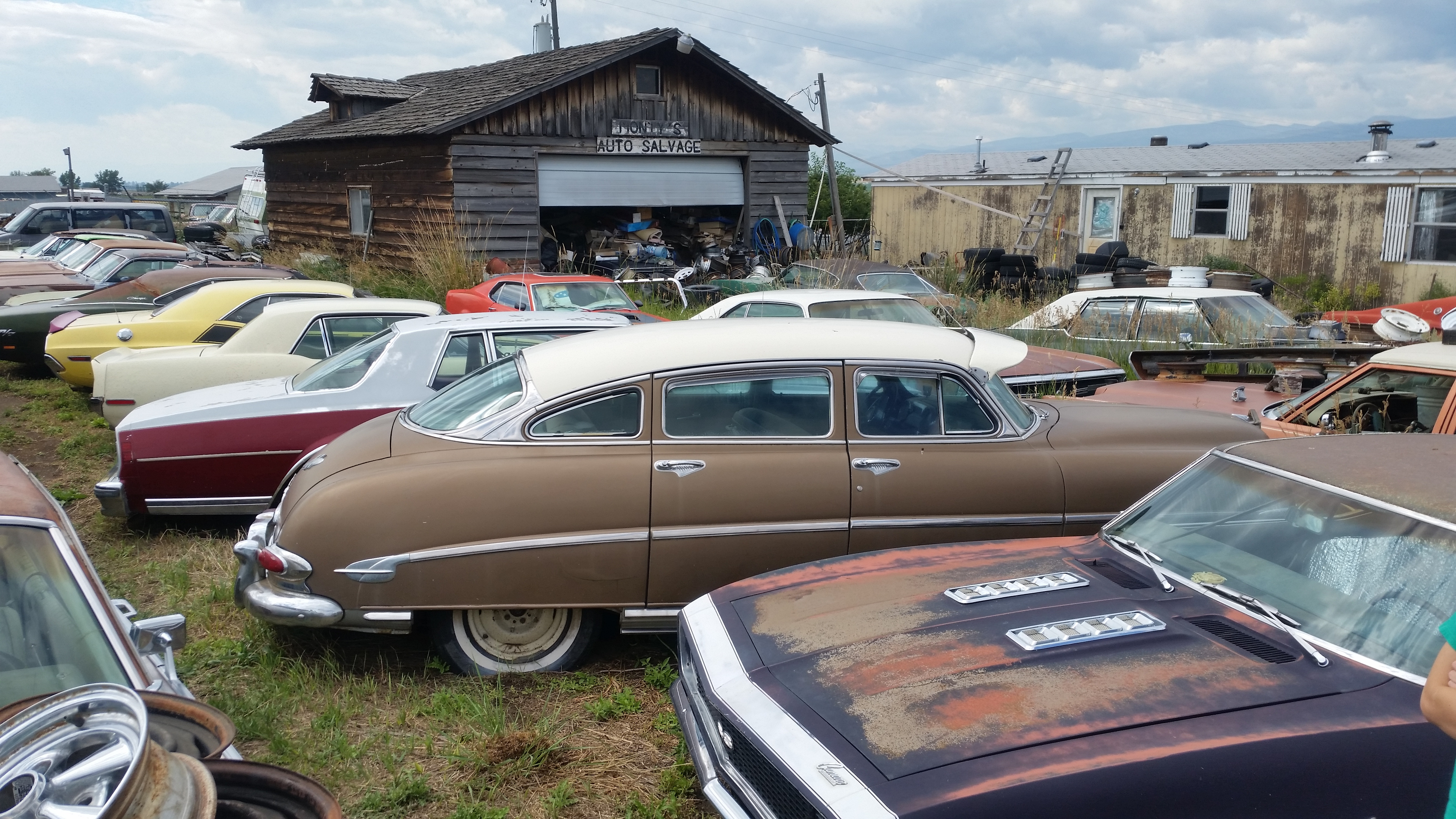

1952 Hudson Hornet 4dr. Legend has it she was the last Hudson used by the Montana Highway Patrol.
Exterior Side
My immediate plans are to get the mechanicals 100%. As she sits, she runs and can move under her own power --the brakes even seemed to work for the 1 foot section I was able to rock her back and forth! As you can see, getting the car to the road will be quite a production. Still though, the whole thing needs to be gone through and that's the kind of stuff I'm good at --I've just never worked on anything quite this old (6 volt!?).
From there, I'll gut the interior and inspect for rust or any other issues hidden beneath that gnarly carpet. Once the metal is cleaned up, I'll hit it with POR15 or something to make sure it's sealed for good. Unfortunately, interior upholstery isn't my strong suit and will probably be stupid expensive. Any links to where I can find carpet/headliner/other fabrics would be appreciated (I prefer as close to original material as possible). The seats and door panels will have to be handled by someone who knows what they're doing as well... but if I can provide original-ish materials, that'd be ideal.
Basically, I intend to get the car running WAY better than it looks and get the interior all pretty, too. I kind of dig that patina exterior look with everything else perfect --though the car will eventually get a full exterior redo as well.

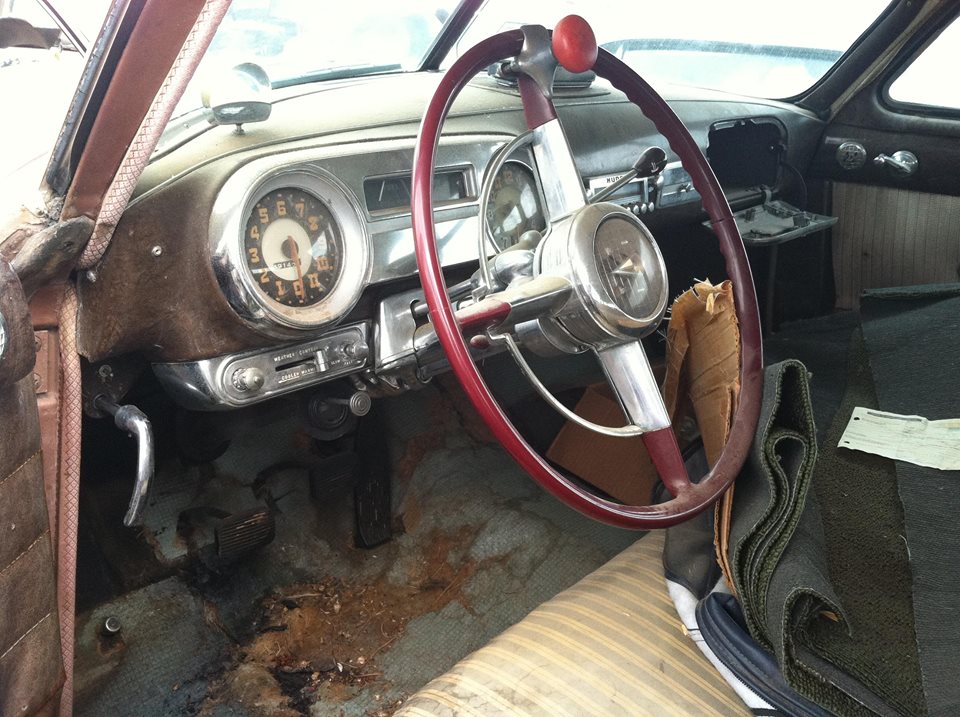

Another big question I've got is the transmission: it's a 3sp w/ overdrive. I guess I'm wondering how the heck to drive the thing. I know the whole column shift deal, but the overdrive function being separate from the column is a mystery to me.
Last question (for now) is about the doors. They all open and close with a solid thunk, but they seem to not be shutting all the way. And I don't want to just slam the hell out of them! Do I have to adjust the latch or striker or something?

    See the round knob on the left side of the steering column? Out position is "out" of OD and "in" is in OD.
    Look up - google T-86 with Overdrive, you'll get all kind of info on the early OD.

    The overdrive is a piece of cake.  Essentially a semi-automatic cruising gear.  For the time being, just pull the overdrive knob out all the way, which disables overdrive and gives you the conventional 3 speeds.  It will take you about 2 minutes to get accustomed to overdrive.  And if it doesn't work, rest assured that most of the problems are in the electrical connections, and don't require overhaul.
    Frankly, I've been running my 1937 on six volts for the past 40 years, so just get your car running (on six volts) and decide about any changeover later.
    The door closing problem is standard; my guess is that the rubber seals have hardened with age, and you're fighting them every time you try to close the door.  But the StepDown folks will have ideas on how to fix that.

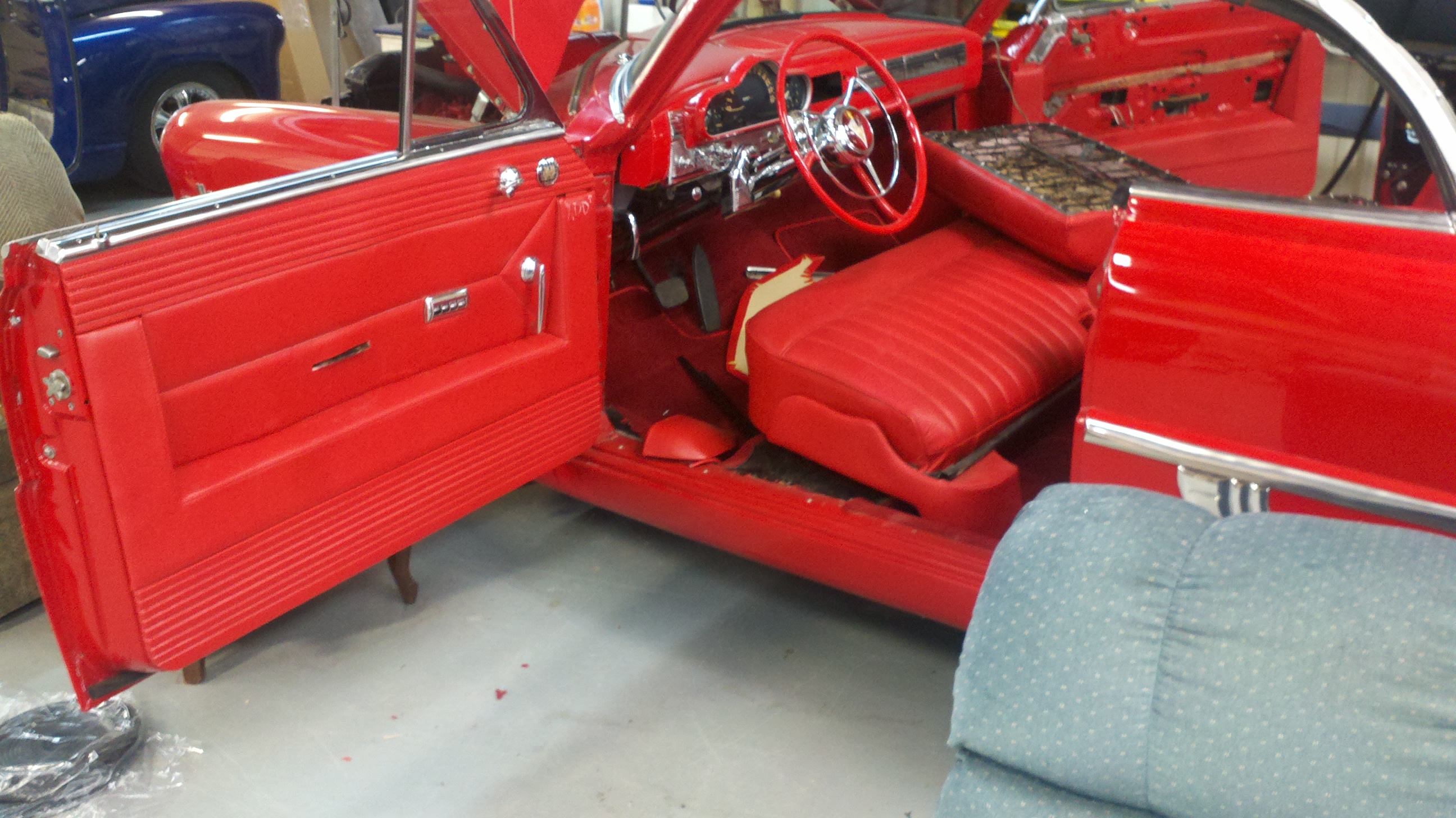

    Stick shift, Overdrive, Twin H, Visor, window wind shade and the various other items for the sedans. As I said, Stu would have any items you are missing such as the fender skirts that are not shown? Also, in the White Triangle News (official publication of the HET Club) you will find a number of vendors that have new and old parts for your car. Jon B that has been responding to some of your comments has a listing of a lot of other vendors for parts. I will not mention them all but you will find Dr. Doug Wildrick listed in member services and he supplies all the rubber parts.
    Just as an example of a seat I have posted a photo of the one Russ Mass has in his 1954 Convertible. It is the same pattern That is correct for your sedan.

    Great looking Hudson. I was very surprised to see such a good looking complete Hudson in a salvage yard. It looks out of place setting there. If it hadn't been surrounded by so many cars I would have believed it was a set up.. I love the color combination. Congratulation on a great find. You have been given a lot of good advice. You will experience a very comfortable road car when it is back on the road.
