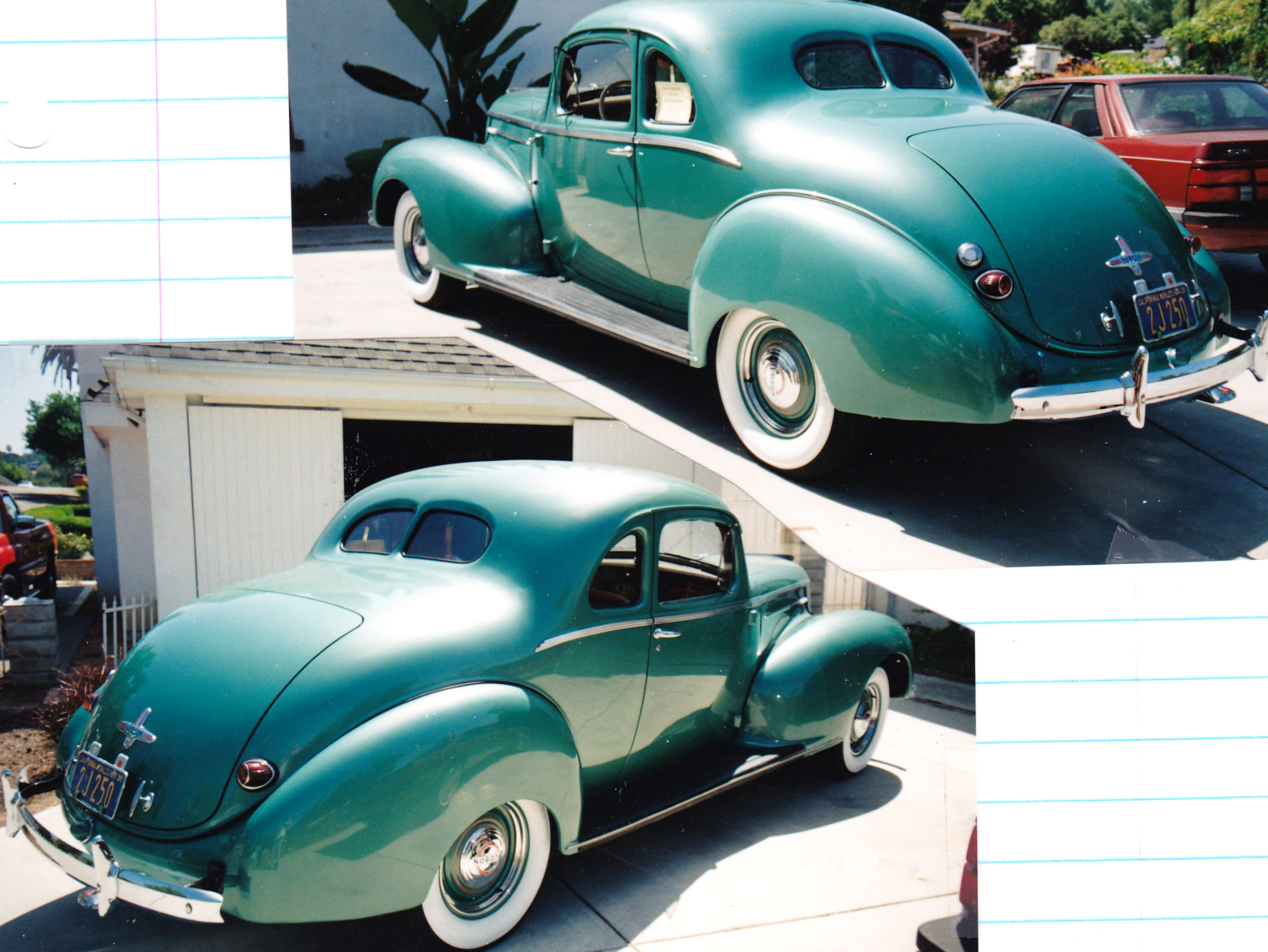

First of all I have to correct the large mistake above in re Bill Albright as he had ABSOLUTELY nothing, as in nada, to do with the restoration of this '39 Country Club 8 coupe! The restoration was begun by Frank Hammer, who I'd met when he lived in L.A., who then retired & moved up into the "Gold Rush Country" of central Calif. Frank had taken the body off the frame, cleaned the frame, and painted it prior to selling it to me as he'd gotten too old & weak to continue the work.
ALL of the restoration work of re-assembly was done by myself & fellow HETer & friend Buzz Stahl in Escondido. The paint & chrome work was done in Escondido too.
Upon close examination I have to say I don't believe the car with the partially completed '41 front end is the is the same car - take a careful look at the windshields. I put all new rubber in the '39 as you may be able to tell from the last photo above. Also look at the lower corners of the windshields of both cars; the '41 comes to a sharp point whereas the '39 is rounded.
After I completed the '39 CC8 bus. cp. (it had exc. original interior so it was left untouched) I sold it to a guy in Texas some 10-15 years ago.0 -

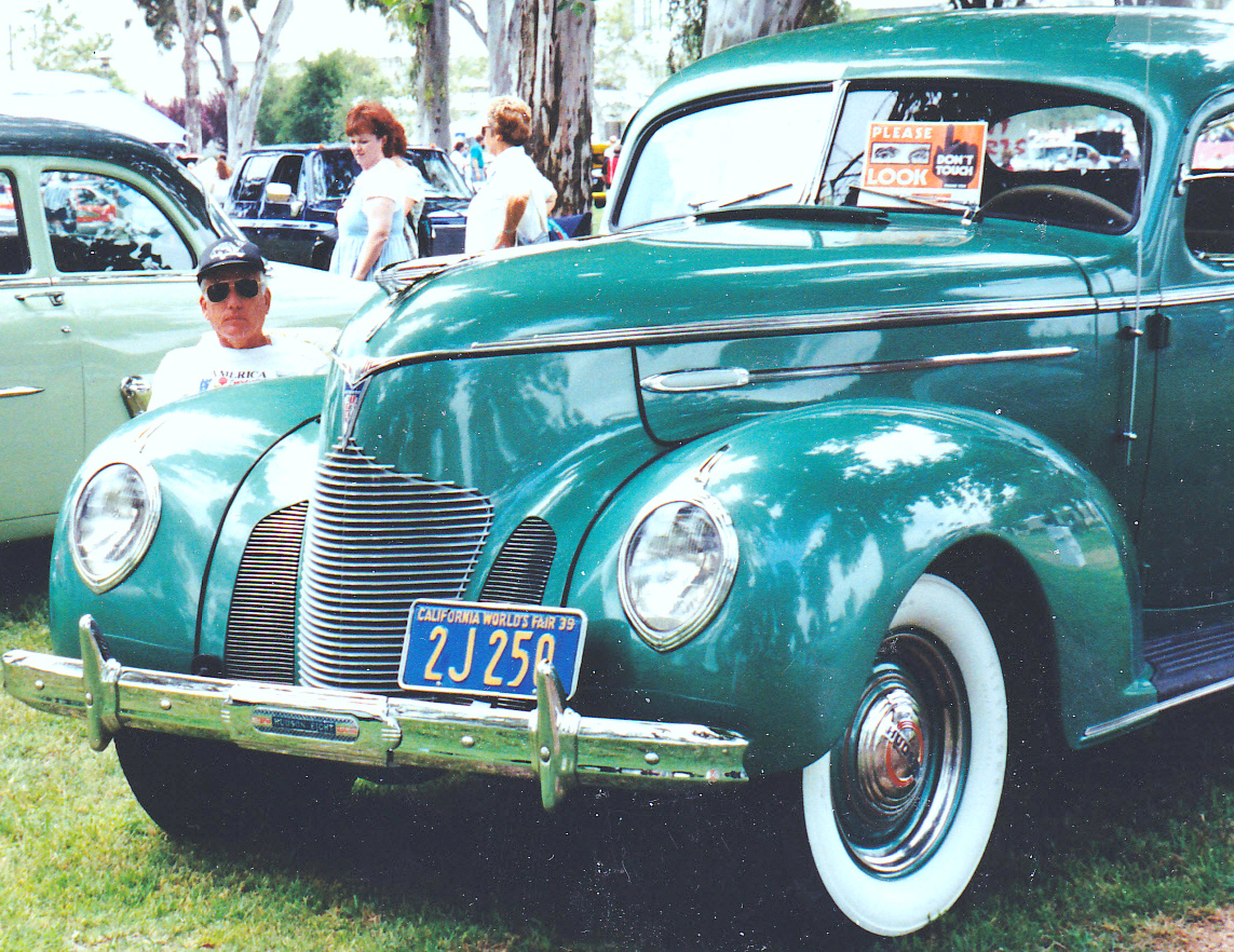

the 2 photos above were taken in the driveway of my Escondido home, this one at a car show in Escondido.0
Upon further careful examination: you'll notice the '41 (?) has fixed door vent windows (you can see the brace) whereas the '39 CC8 has the "disappearing" vent window. The '39 has long fancy belt moldings whereas there are none on the '41 (?). In '41 you could get the cars with or without running boards which this '41 (?) doesn't have & is missing the rubber cover that goes onto the front of the rear fenders (you can see the holes where it would be attached) whereas the '39s ALL have running boards.
In lieu of the above I'm certain they are not the same cars (whew, as sure had to think someone butchered that wonderful '39!).
As you can see the '39s have "teardrop" rear windows & from the photo of the '41 (?) it would appear to me to have the squared corners of a the 1 pc. it would have.0 -
