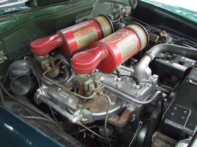

No problem with the fit. The air cleaners will not be "in line" as in a long wheelbase, but works fine. Lots of 262'a Had twin H0
If you don't alter the back air cleaner, then you have to cant it inwards (at an angle) in order to miss the wiper mechanism. Paul S. altered his in "Baby" so that it sits parallel with the front air cleaner.0
Here's a shot of my '53 Super Wasp with a dealer installed Twin H. Note the rear air cleaner is canted to clear the wiper motor as pointed out by "Super Dave" and RL.
