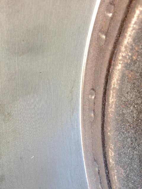

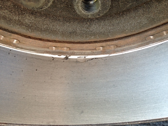

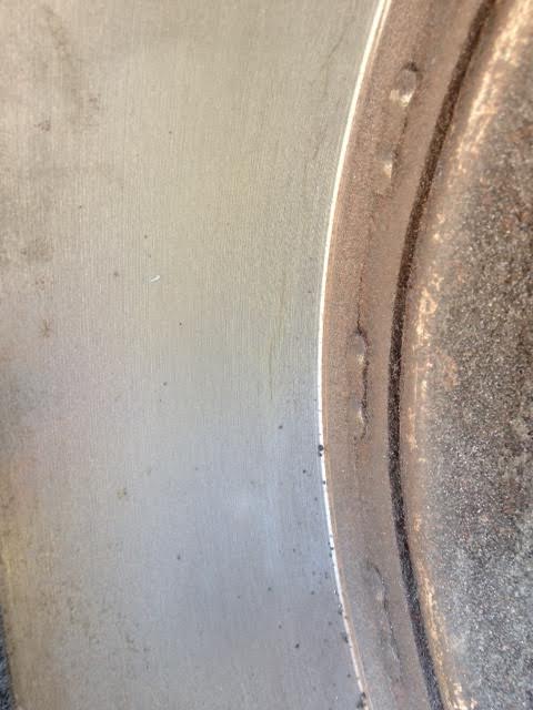

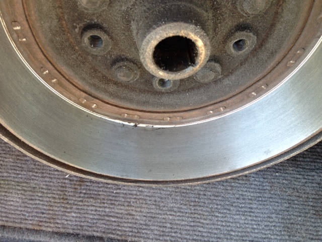

Thought I'd add some pictures of the hairline cracks. Pics 1 & 2 are from one drum. 3 & 4 are from the other.
Thoughs?

Those would be ok for a parade car , but not a trip to California.0
