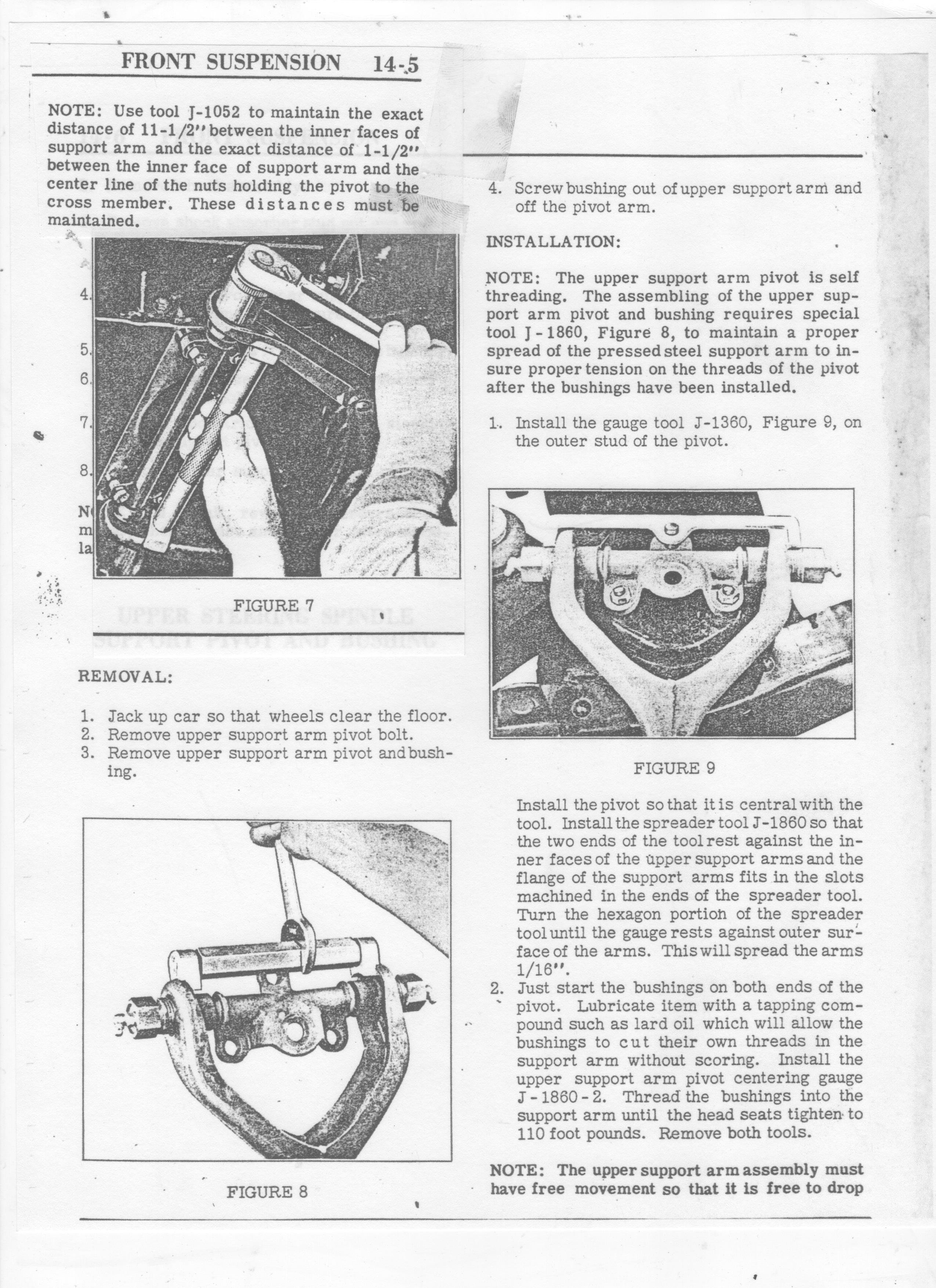

I am looking for the tools to work on 51-54 A arms - would like to buy or use as templates to make new ones.
J-1360 Gauge
J-1052
J-1860
J-1360 Gauge
J-1052
J-1860
I did not use a tool on my stepdown to either, take them off or put them back on. I will admit that when using my "home made" grease seals (made from heater hose), it required a little more strength to compress the rubber hose (in order to get the A-arms ends over the cross support arms).Michael0
