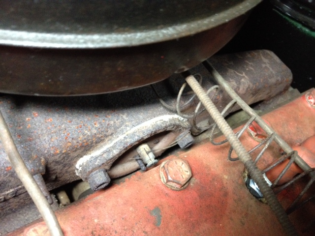

Thanks for the tips! Where is the heat riser? Is it the round cover with a pin in the center on the exhaust manifold that faces the engine (picture 1)??

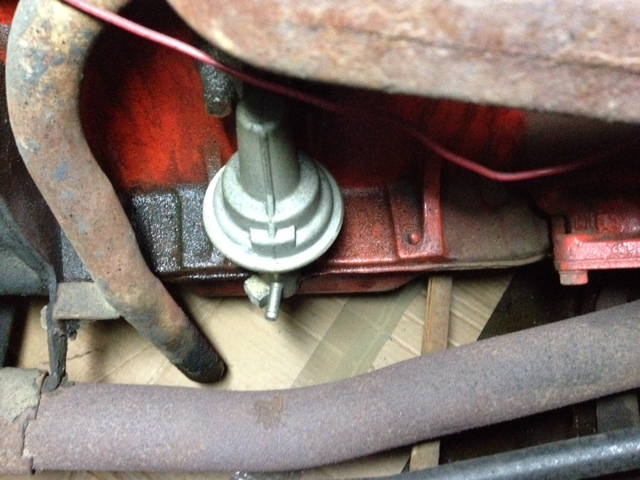

Also, what is the silver, newer, item in picture 2? It sits right below the exhaust manifold and carb.

fuel pump, and yes that is the heat riser.0

In looking at the first picture your heat riser is missing the spring and is wired open already (or it could be wired shut)John0
I'll give it a little push tomorrow morning and see what happens.
