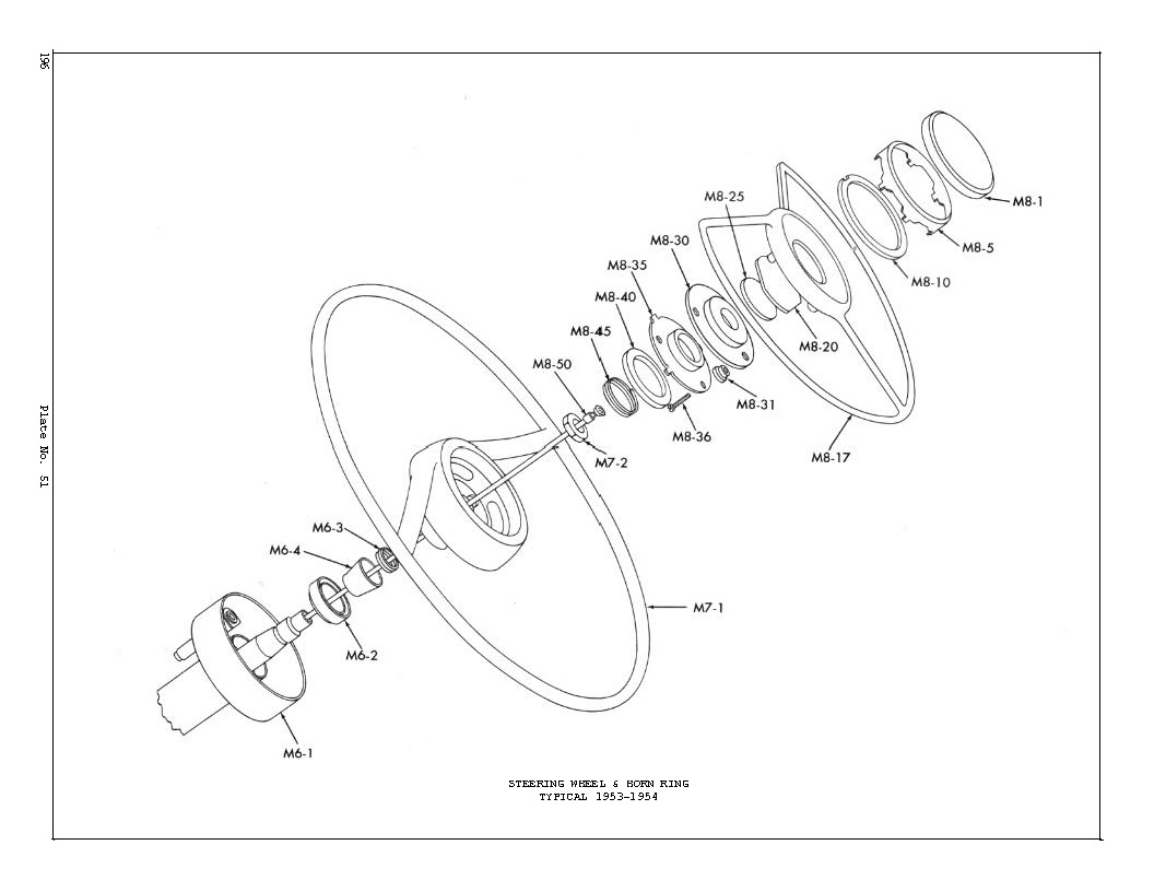

Well I did it. I took apart the '54 Jet's horn ring and removed the steering wheel with out taking any pictures. I've disassembled the components on the horn ring that hold it to the steering wheel and activate the horn.
Would anyone happen to have a diagram of how it all goes back together? I've screwed the three screws and the notched ring to the back of the horn ring. But there's a triangular piece of metal... a round rubber pad... and a smaller triangular piece of metal. I can't figure out how this goes back together.

The master parts manual for the 1948 to 54 Hudson lists all the elements of the Hudson Horn ring and steering wheel. The attached picture is an extracted page showing the general description of the assembly. The manual is on line in the HET CLUB tech library.0
Thank you! I'll get the master parts manual asap.
