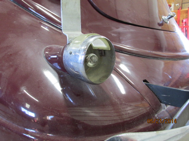

I need the tail light housing for my 35 Terraplane. I have the glass parts (lens and license plate glass) but the housing has been gutted so there is no way to mount the lens. I also do not have the metal ring that holds the lens in place.
The photo shows what is left on my car.
Thanks,
Mike
If you can come up with a photo of the missing parts (possibly from another '35 Terraplane) that would be helpful. Also (and I may have mentioned this) it would benefit you to e-mail your needs and that same photo, to some of the various Hudson parts vendors who advertise in the WTN. They may not all be following this forum carefully, so wouldn't see this message. Many of them have collected a lot of miscellaneous used Hudson parts over the years, though they may not be able to identify all the parts, and a photo would help them do so.

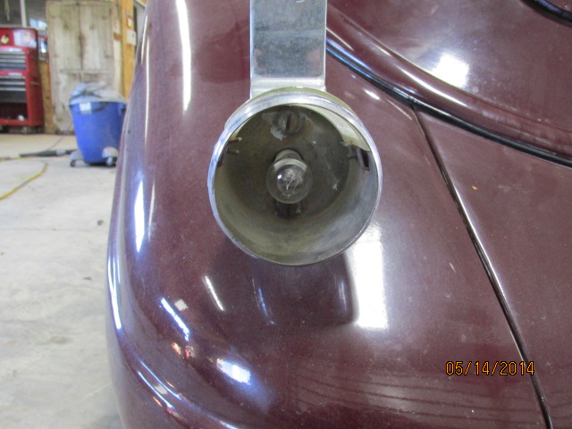

At the angle of your photo I can't tell if you have the original tail light chrome housing. The original is rim-less, it has no rim. There is an inner piece of spring steel that holds the glass lens which is pressed inside against the resistance of the spring. Take a side pic of the housing for more info. Being spun brass these housings tended to crack with age so I won't be surprised if you have a replacement tail light housing.
StillOutThere,
I took your advice and have attached another photo of the tail light housing. The past owner had an oversized lens that he had cobbled together and had made two cuts along one side of the housing so he could jamb some screws with square nuts along the inside of the housing to keep the lens in place.
Thanks,
Mike
Appears to be the correct housing and you are only missing the internal spring and a lens. There do appear to be a couple of cracks in the brass and until those are repaired, a proper lens will not stay in the housing but will be pushed out by the spring. Silver soldering the housing and rechroming is the fix.

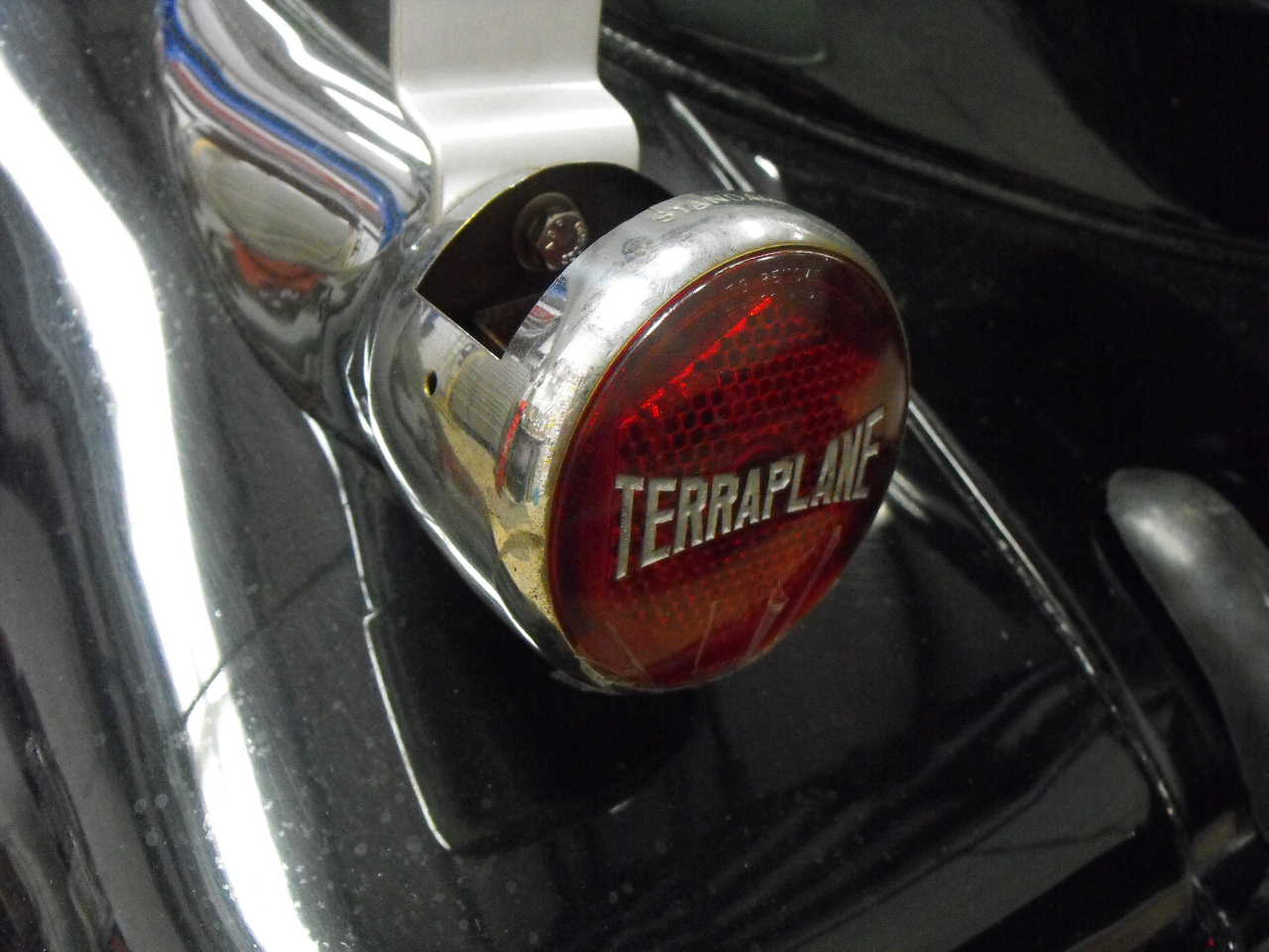

Attaching photo of the same housing as yours on my '34 Terraplane. I was missing the license lens at the time. The '34 lens is almost flat. Your '35 lens has about a half inch of bubble to it.
