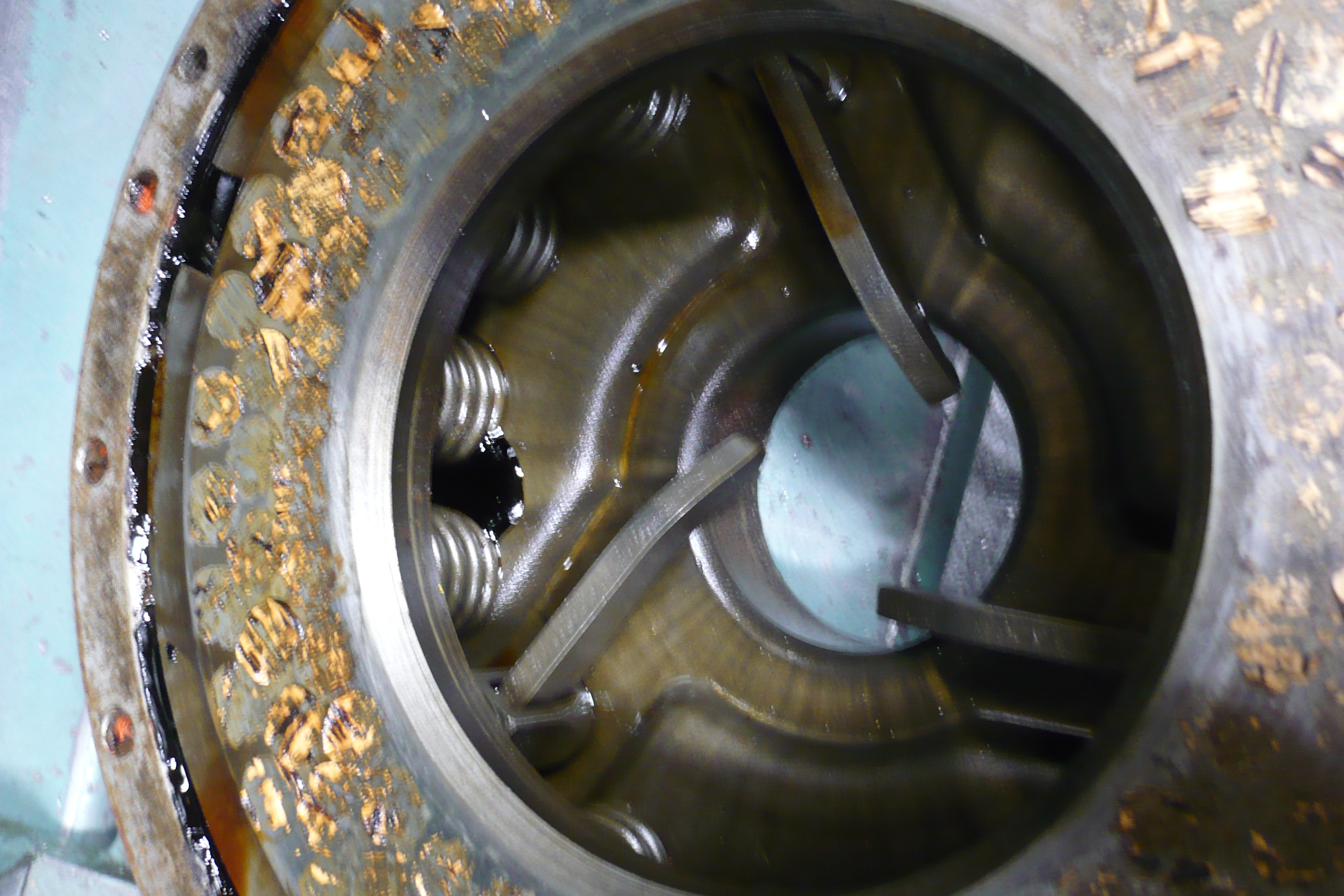

After taking apart and the cork is still stuck to pressure plate and or the flywheel, do you use a sharp putty knife to cut loose?
Thanks for your help. My first fluid clutch work.
Lee O'Dell
Yup, and use solvent..save all the cork you can. It might be re-usable.0
I hate to be the bearer of bad news, but if it has been under pressure for that long, the likelihood of successfully releasing it without damage is pretty much nil. Just the act of depressing the clutch pedal (realizing that you don't have that option) will move the pressure plate away from the flywheel, pulling off pieces of the stuck corks as it goes. You do have the advantage of having the whole thing more accessible since it's out of the car. My prediction is that you'll just have to bite the bullet and take it apart for a proper repair/replacement.0
Just be careful not to bend the plate while prying it off. If it's warped, it can't be rebuilt.0

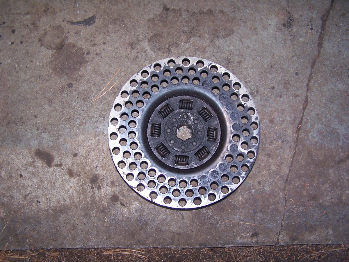

I want to remove my clutch disc, have removed the trans. now how do you get the disc off, ??? Thanks Don B0
Take the cover off (alternate bolt loosening side to side top to bottom etc.) The Pressure plate will come with it (maybe) and the disk will probably be stuck to the flywheel. Put some acetone, carbochlor, sea foam etc between the disk and the flywheel, let soak for a day or so and carefully scrape the corks from the flywheel with a sharp wide putty knife.
It may come loose with most of the corks, and it may not.
