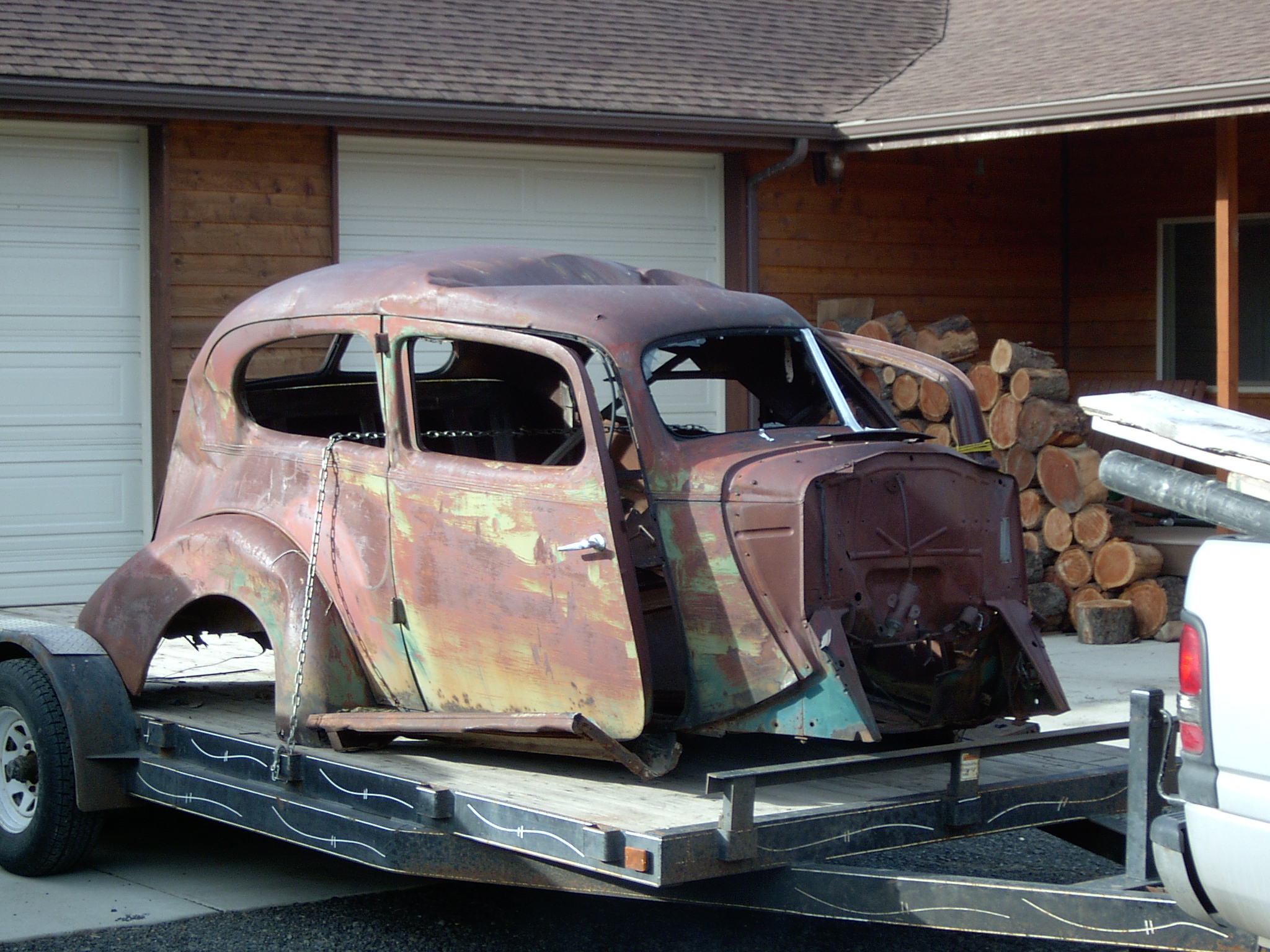

found a 2dr that is rough bought and the more I look the more I'm lost. The coupe rear clip has rear fenders, deck and rear panel. The panel delivery is body and side panels no floor or fenders. So I bought a 2dr model 61 for floors, running boards, grill and pieces, fenders, hood and misc, Does the panel delivery use short wheel base 115 or lwb 120 2dr body is rough but can't walk into NAPA or carquest and buy new.

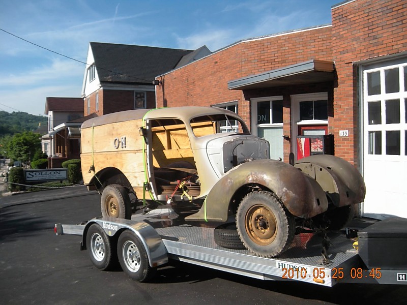

the panel delivery would share the body panels of a 4dr from the back of the front doors forward. the rear body was built by York Hoover skinning metal over wood. the rear floor is wood as is the interior sides and top of the rear portion.0

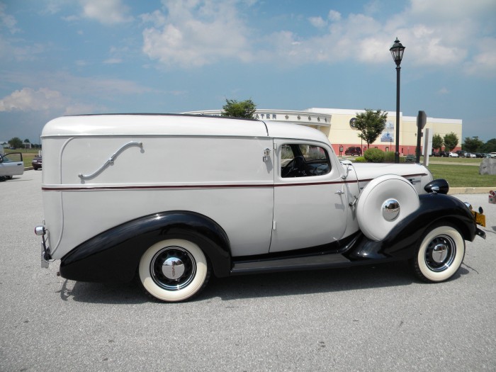

You need to take a camera and plenty of measuring tools to Pennsylvania, and check out Dave S's '36 panel delivery! With his permission, of course!

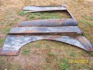

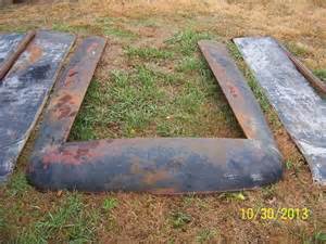

So the rear panels that I have are pictured in attachment. body has no floor at all So the floor in the panel section is wood Well that make's sense the curve section that the fender attaches to has 1/2 lip Does anybody know which frame?0

It is built on sedan frame with 3/4 ton truck springs. I donated copy of factory blueprints for the rear body to HET and they have them on file at the AACA Library in Hershey, PA. If you want, I can have another copy made.
Give me your email and I can send you link to site I have on Snapfish with over 325 pictures I took when We were building our 36.0
