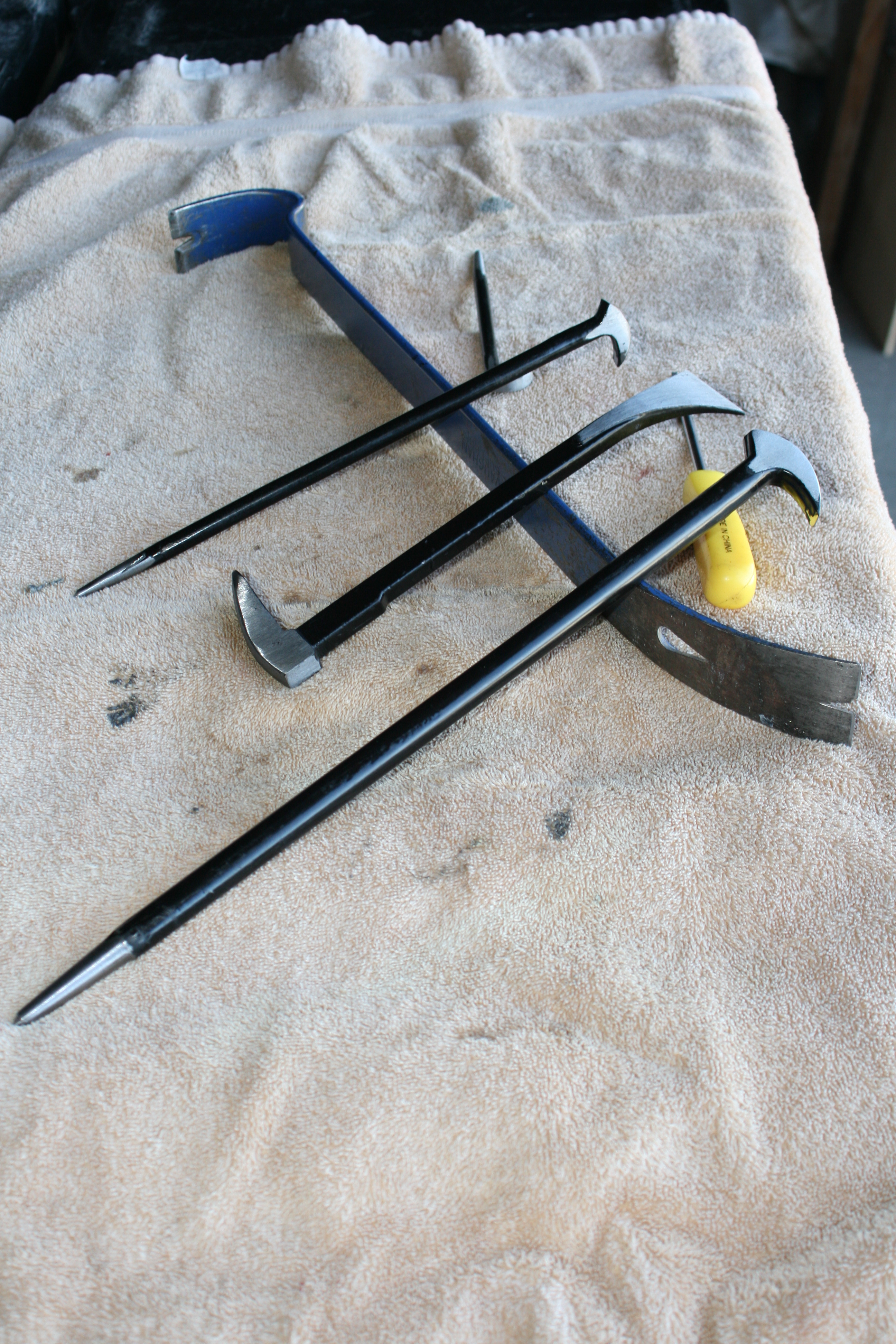

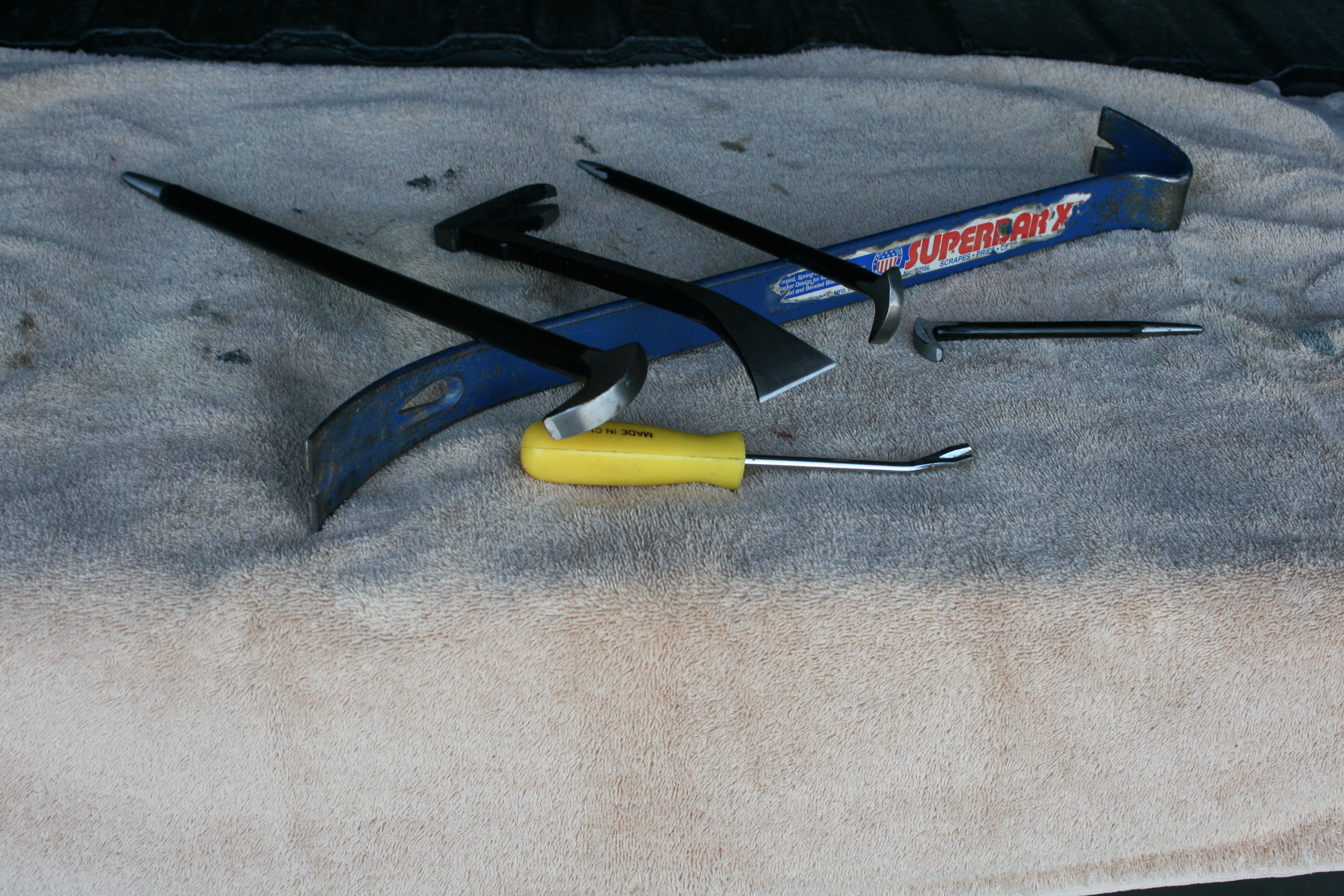

I may be a little late to the party, but since I need to pull my stainless to paint my 54 I stopped by Harbor freight today and picked up a few small pry bars. They run about a buck each and since they are low quality stuff, I can grind them to what works for me. I bought four.... Just tried one and it works great and does not damage the stainless....0
Brownie, Any pictures of how you ground yours to get the trim off.
Thanks,
Larry
So I went out to the shop and gathered up all my stainless removal tools and took a photo. So, here you are--by the way, I sharpened them before I took the photo....... By the way, no one tool works better than the other. My rule is the smaller the tool the better it is to start with/0
Thanks, Brownie
