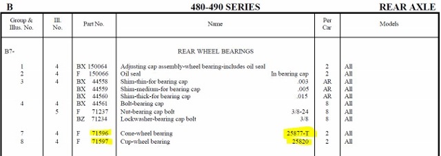

So Here is what I found.
In the 48-49 parts guide it shows part number 71956 which shows the bearing number as 25877T.

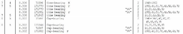

Now the 48-54 parts guide shows the axle was changed after 52. The early axle is identified by an H and list the same part number as the 48-49.
So My thinking says the 25877T bearing is for the 48-52 axle with the H style differential.
