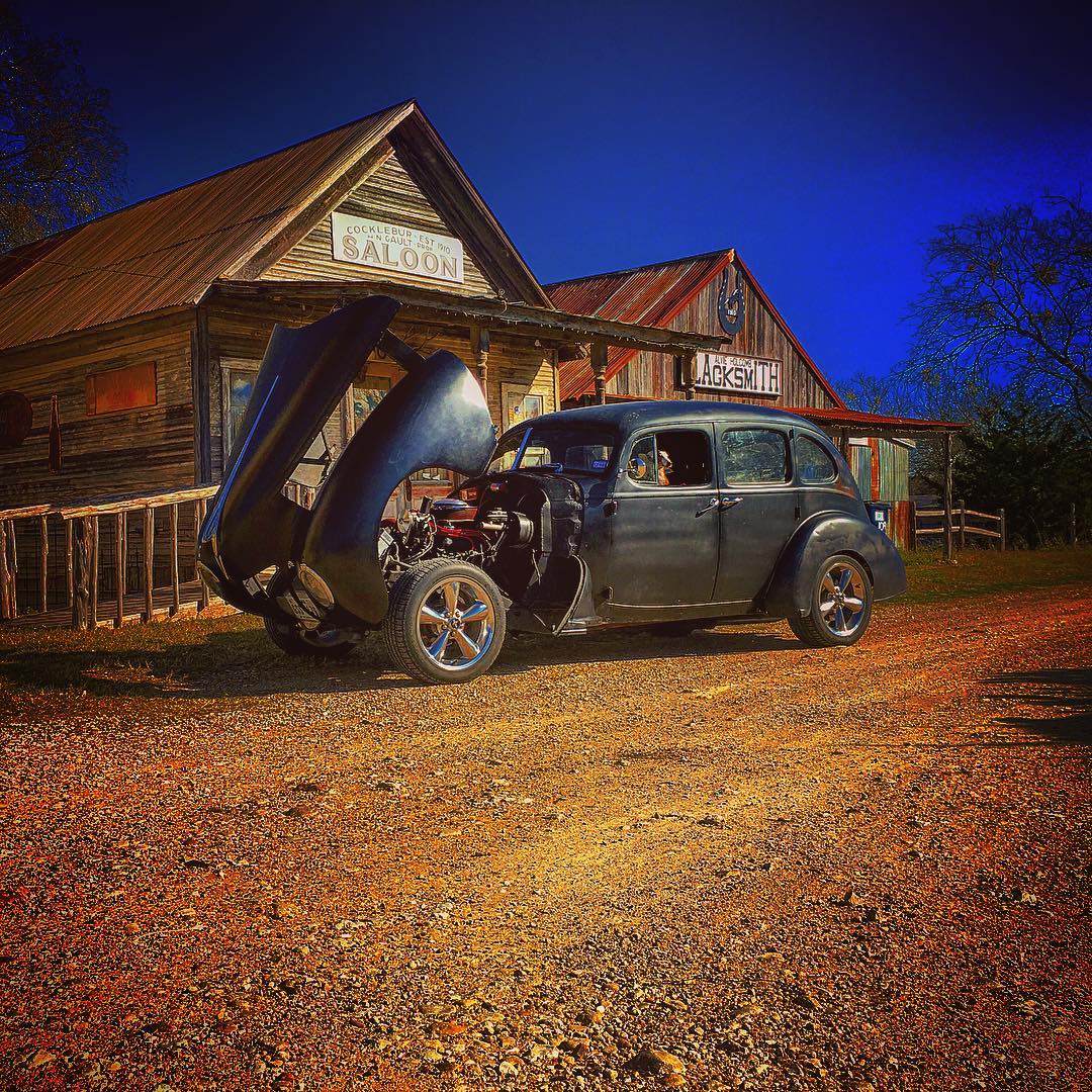

I installed a 460 ford with a c6 into my 39 Country Club, but, that was after I clipped a 2003 ford Ranger front frame section. It also has a 07 Ford Explorer rear independent suspension.0

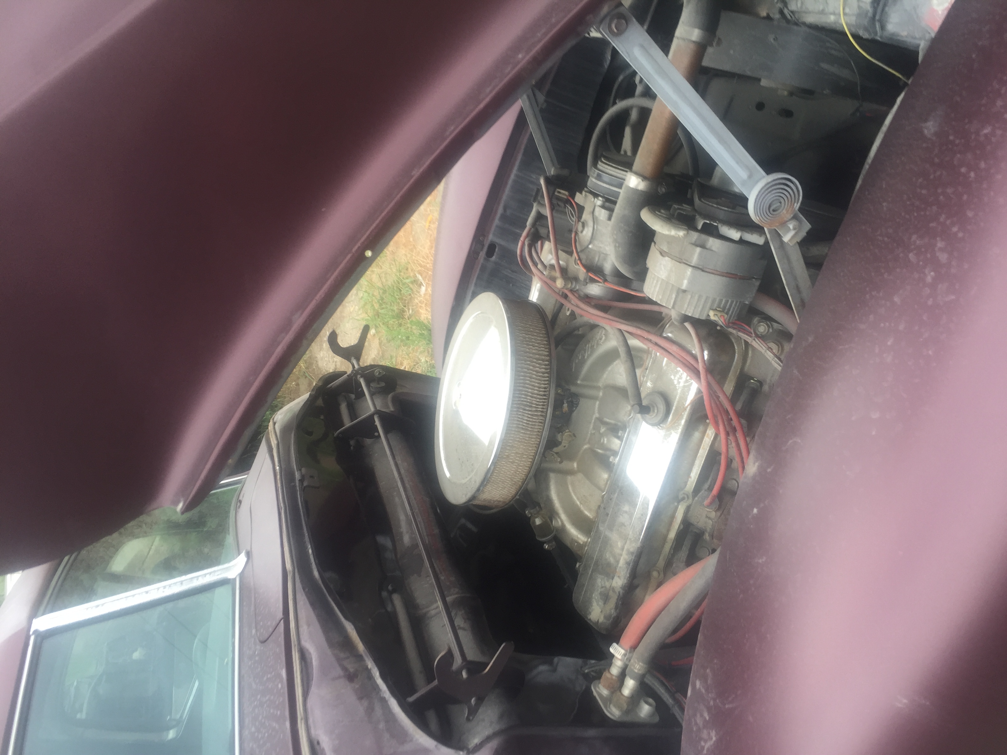

Oh it can be done! I didn't do it, but I bought one that is done. They took a 71 deville and cut the front clip off. Welded it to the stock Hudson in front of the x member. No issues with the firewall or hood, but you will beed to make sure you have the right oil pan and pickup or it will drag on,well, pretty much everything on the road.
its tight but not too bad as I've seen a lot tighter. No prob doing spark plug changes or anything . 0 -
