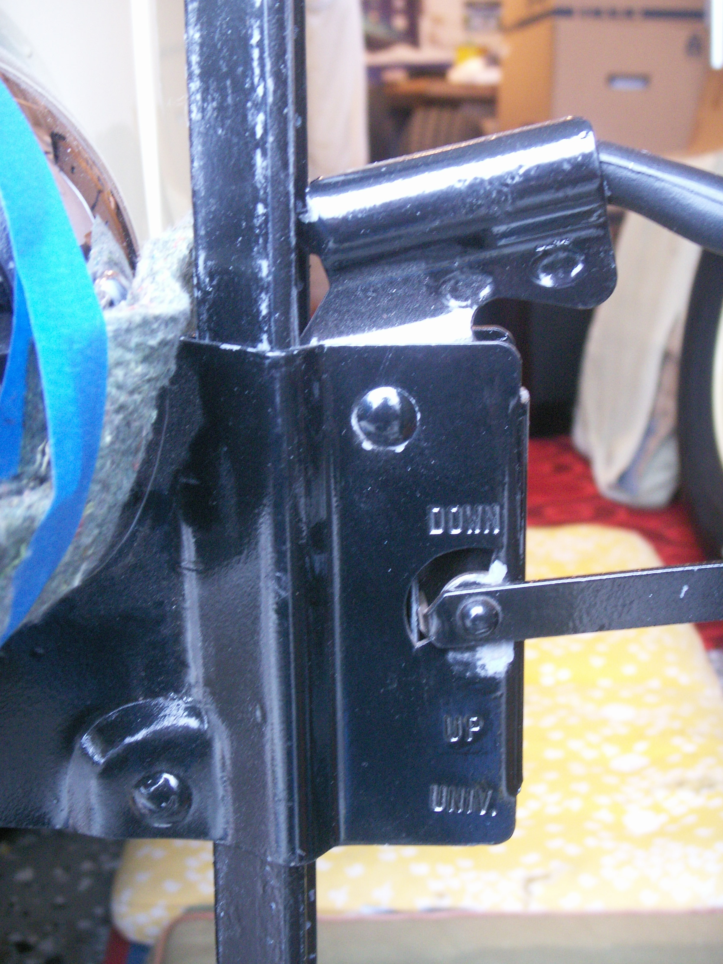

My Hudson jack does not work as expected...
There is no problem to lift the car when the lever is in the 3 o'clock position, see enclosed picture.
But it will not move downwards when I move the lever to the 6 o'clock position and try to lower the jack by operating it the same way as when I lifted it.
It stays in the position it had before I tried to lower it. What´s wrong?
Any tip how to repair?
6 o'clock is up? What kind of a clock do you have, Ken?0
What happens when you move the lever to "UNIV"? Do you get a degree in Mechanical Engineering?
What keeps a good number of Hudnuts using these critters is that on the stepdowns, if you need to pull a rear wheel you have to jack either the frame or the built-in "pockets" under the bumper. The frame is the logical choice then, but it has to be raised quite a bit, and some typical scissors jacks don't have enough range..0
Thanks Ken U-Tx for your tip but it cannot work. Look at my picture but magnified. The lever can only move within a circular sector which limits its movement to 3 o’clock. 12 o’clock cannot be reached.
To Jon B I would like to say that I already have the degree in Mechanical Engineering plus a Master of Science in Electrical Engineering plus 45 years experience from my work.
I got a tip0
Ihave got a tip from a Swedish friend: When you wish to lower the car you must press the "pumprod" down until it stops. Then you can lift it and the car goes down a bit.
I have tried this without success. I guess that the spring inside the jack is weak and does not operate the "hooks" in the correct way. The spring is not broken.0 -

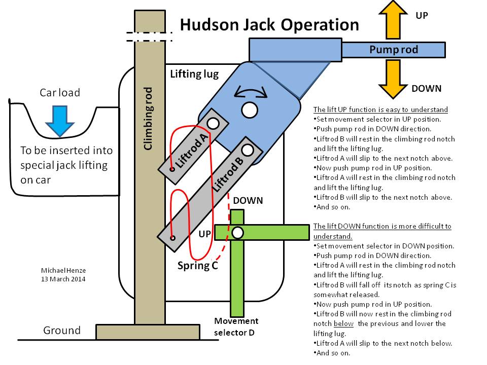

I looks like I have solved the problem by decreasing the tension of the inside spring a little. If I have time I will make a drawing to show my solution.0
Dear friends. Have a look att the enclosed drawing which I have made by inspecting the inside parts of the jack using a torch. The spring has a significant function. At first I tried to extend the lower left U-shaped part in the drawing but it did not make any difference. Still the jack refused to go down. So I tried the opposite and compressed the lower left U-shaped part a little. And it worked.
I hope you can have some benefit from my drawing and exlanation. Best regards
Michael (micki) Henze, Sweden
1 -
Nice job on the drawing and explanation. It should help to get some of those pesky jacks working again.0
