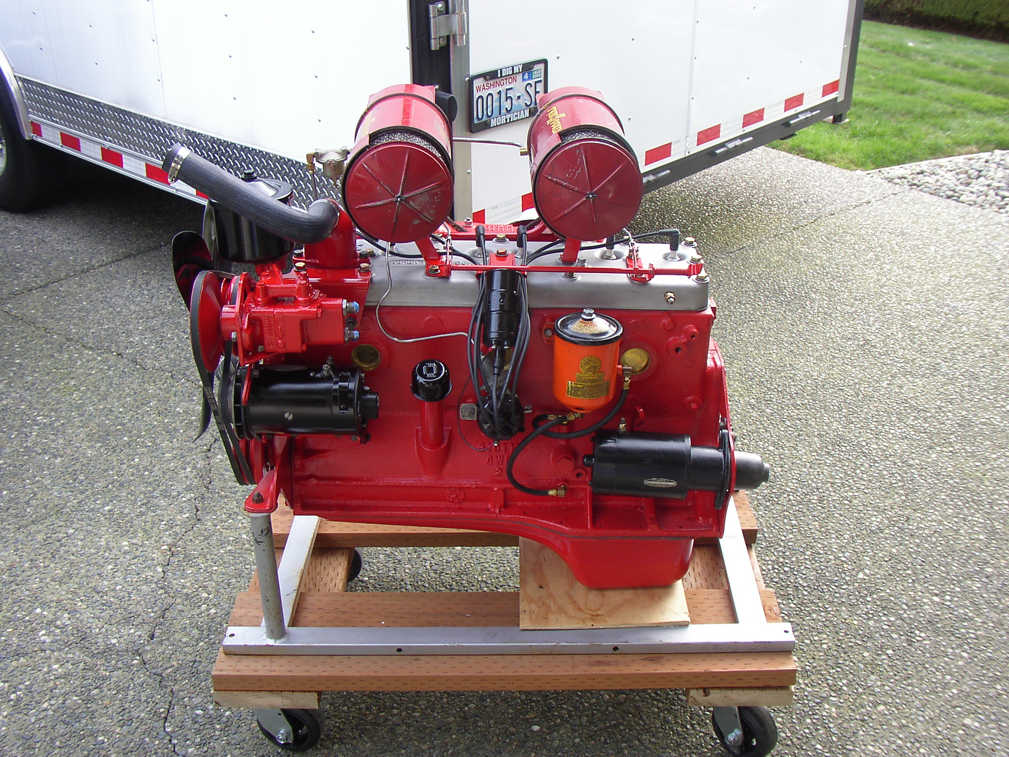

probably doesn't have one, by chance it does it will be a canister boltedto the side of the block, origonally orange with a black lid.0

Walt has an add on oil filter kit.
http://52hornet.blogspot.com/2010/04/next-project-oil-filter-kit-by-walt.html
