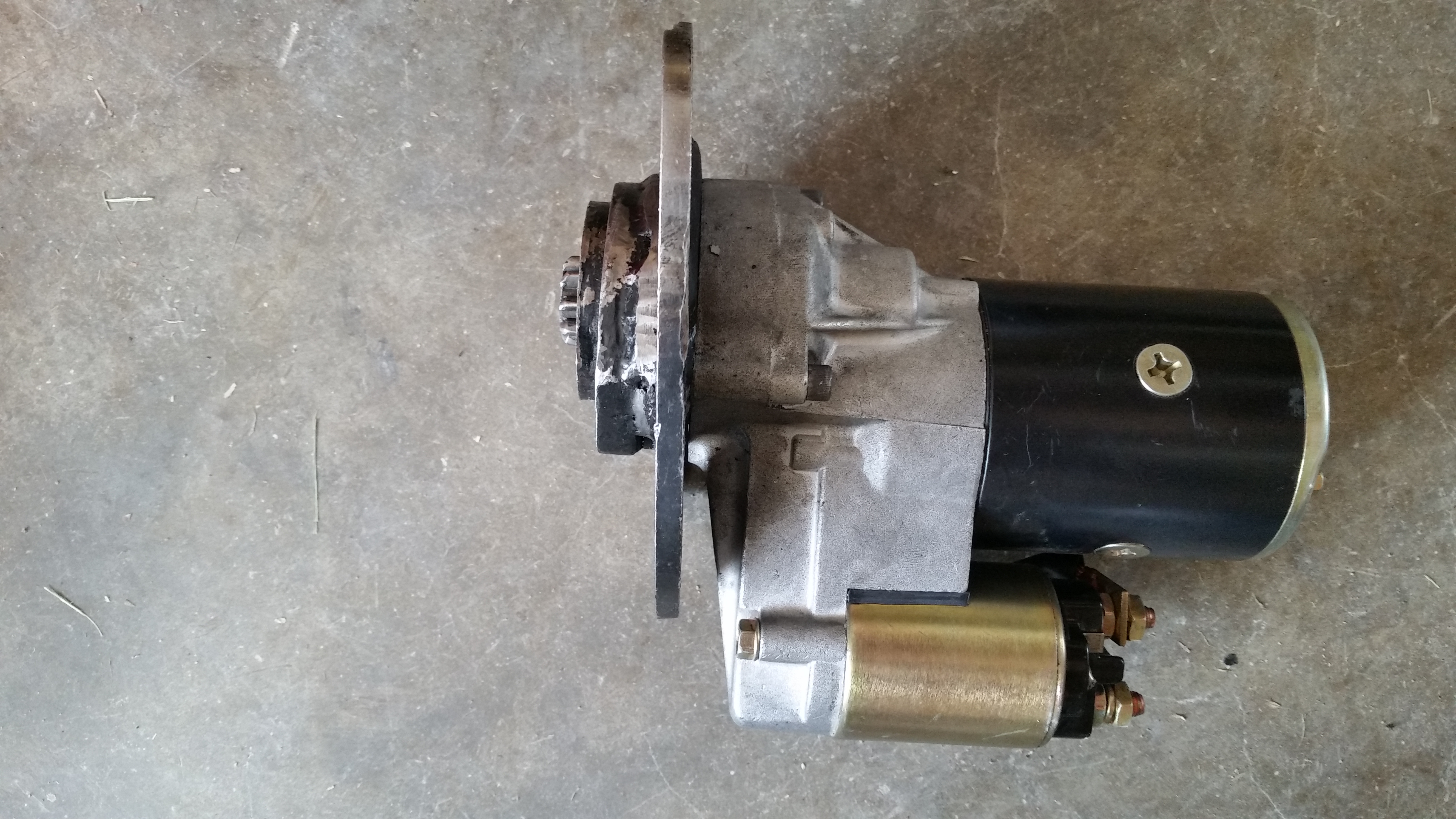

Attached is a photo of the starter bracket (with Chevy mini starter attached) that buddy and I made. I took to a machine shop to see if they could make a duplicate that didn't look so rough. He said he could and would as soon as he got caught up on his regular jobs. That was in December. Needless to say, he never got caught up and so I'm going to reinstall it on the car as is.0
Jason, Is that for a standard or automatic?0
Standard. Works pretty well too.0
I would have thought the chevy starter bendix would not have been the right pitch-tooth count. Hope this works long term, it would be a relatively cheap way to go.0
Keep an eye on that ring gear. Starter pinions that engage from the front have been known to eventually knock the ring-gear off of the flywheel. Now, that would turn into a project you don't want to do just for the hell of it. Hydra-Matics don't have that problem since the gear teeth are integral with the flywheel/torus cover.

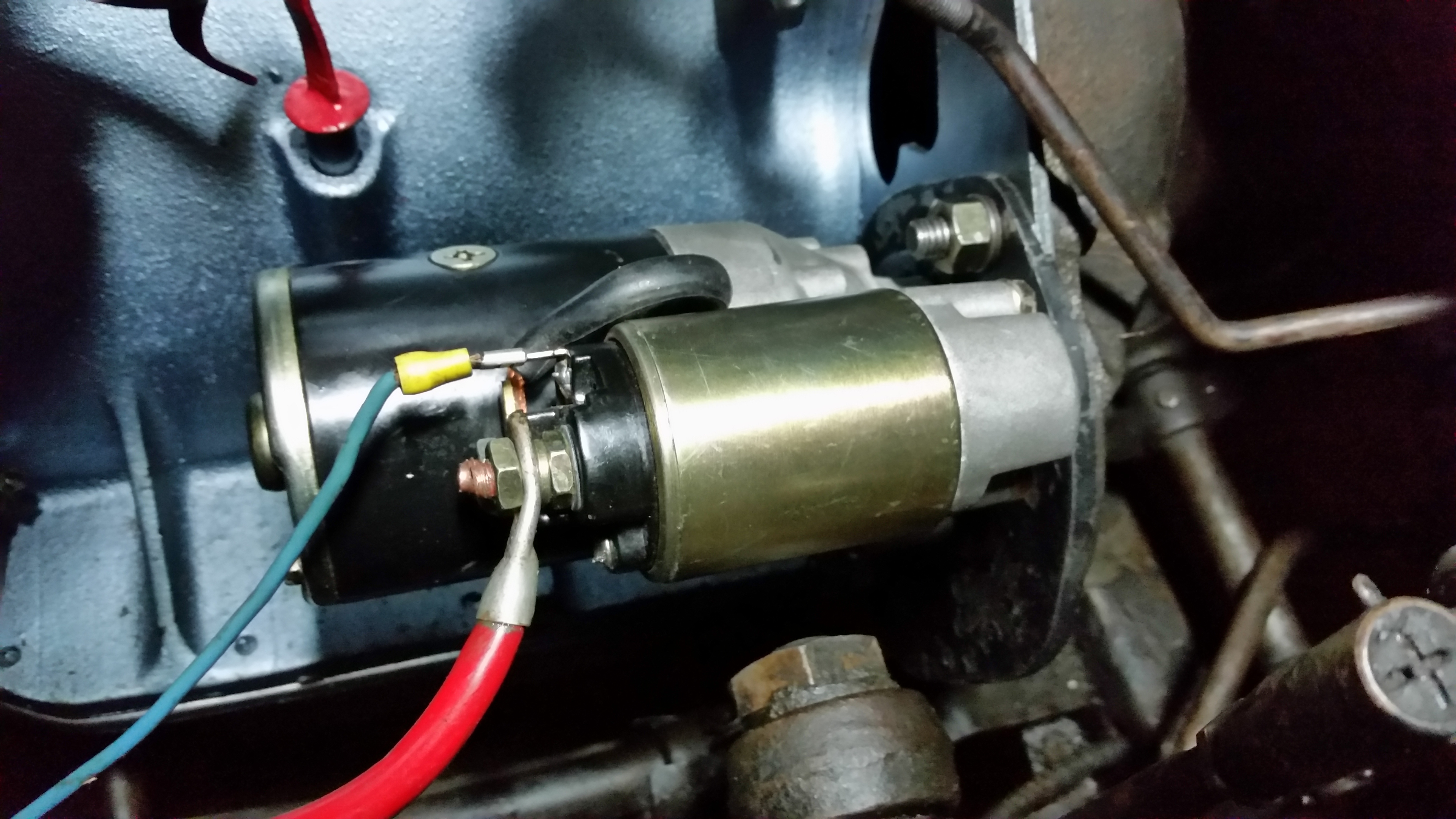

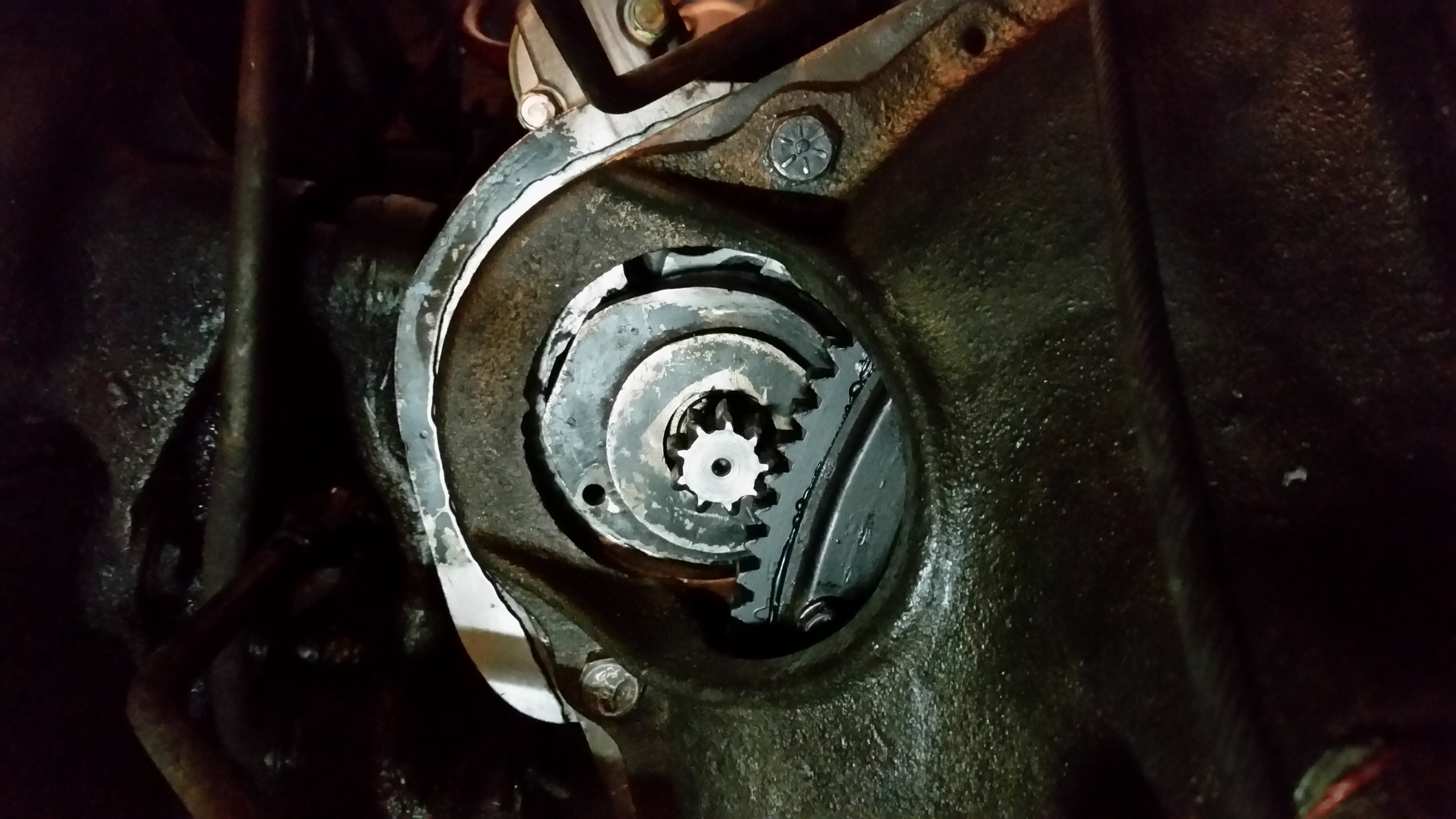

Frank, I just broke the pinion on the old fashioned starter turning the engine without realizing that the car was in third gear. Attached are photos of the mini starter that I just attached to the newly rebuilt engine (1) and what it looks like when the gear is engaged with the flywheel. I have used this setup for nearly two years and so far it engaged the flywheel better than the old starter. I hope you haven't jinxed me....0
Well, as the old saying goes, "the proof of the puddin' is in the eating". If it isn't doing any bad stuff and continues to perform well, it looks like it has potential as a low cost retrofit.
Cranking the engine (or attempting to) in third shouldn't have broken the pinion unless it was already on its way out, IMO, but it sparked a good idea. Is it at all noisy? One apparent advantage to that design is that the pinion engages the ring gear before the starter is energized. The Hudson/Autolite unit is the other way around. May I assume (you know what that means) that you were running the original on 12? If so, that may have had more to do with the pinion failure than anything else.
