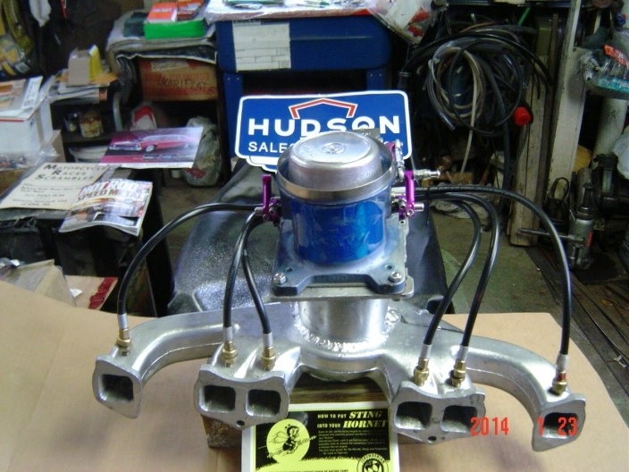

FYI
Here is one of the mechanical F/Inj setups Ive fabricated for my Drag Car Project when time permits. Its a Rons Fuel Injection huge Throttle Body that's not for Street use though. You need a Belt Driven Hi Flow Pump, Large Fuel Lines, etc.. It ran nice but needed more Fine Tuning with 'Pill' (Jetting) experimenting....
