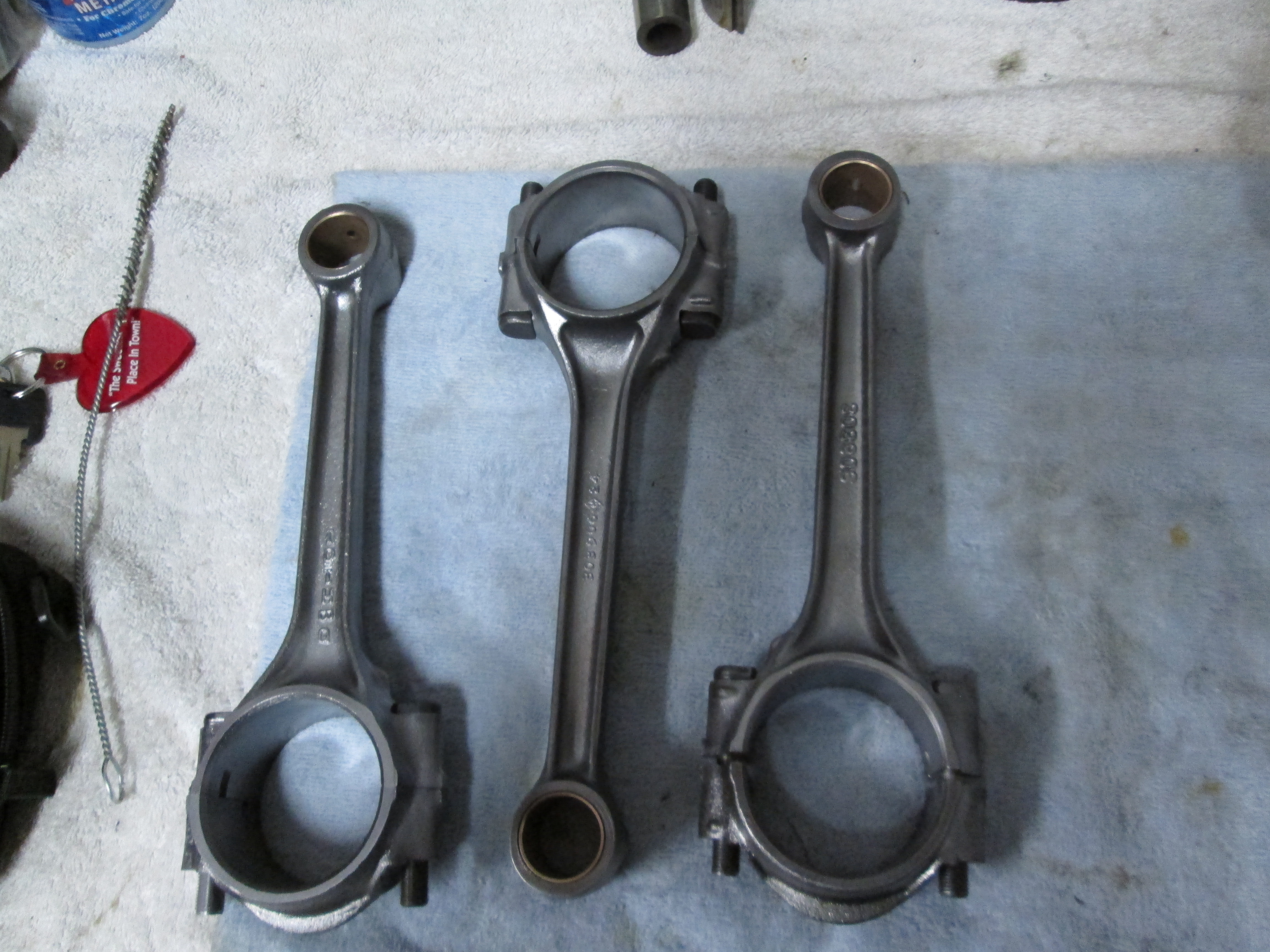

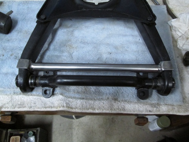

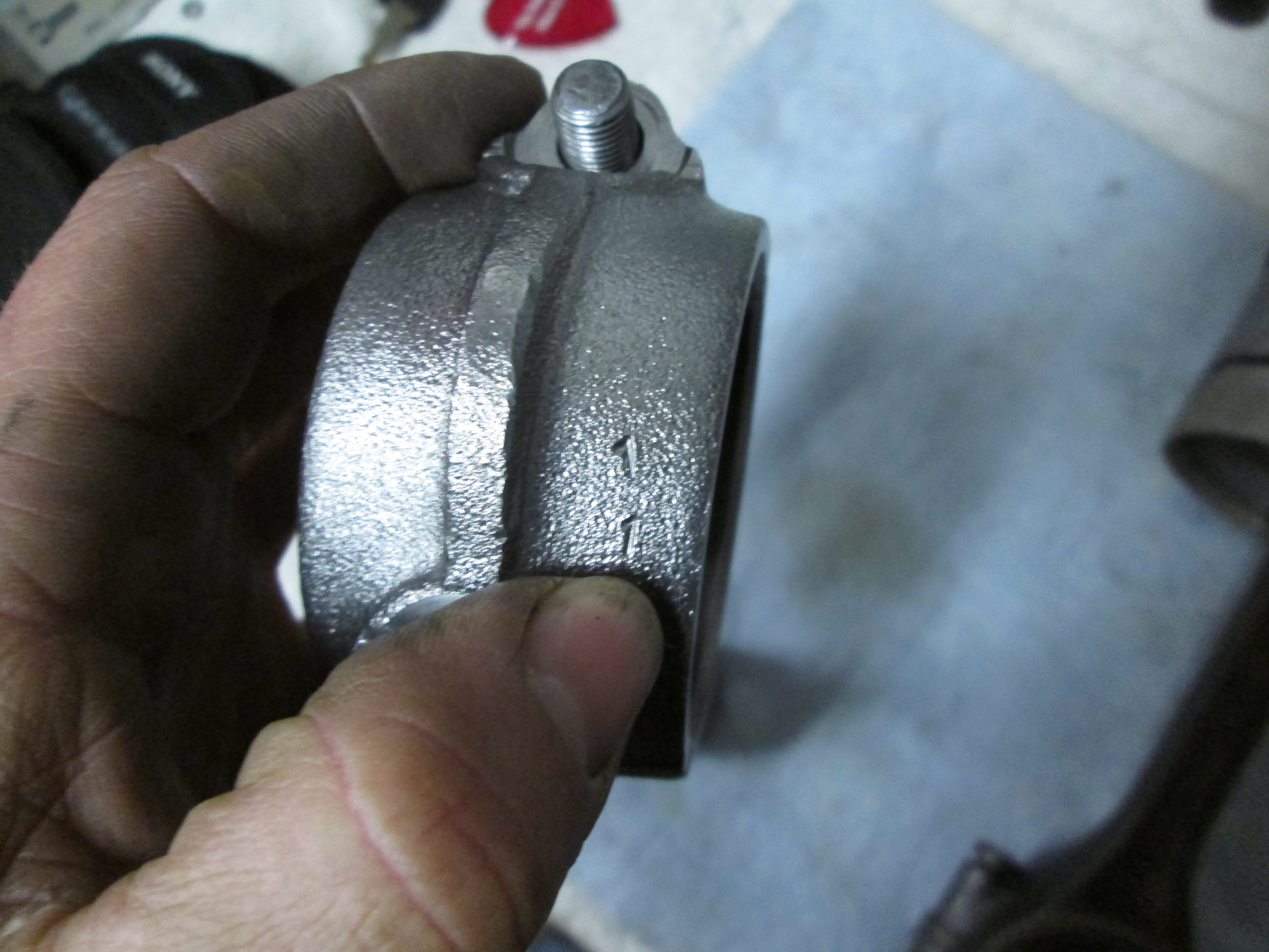

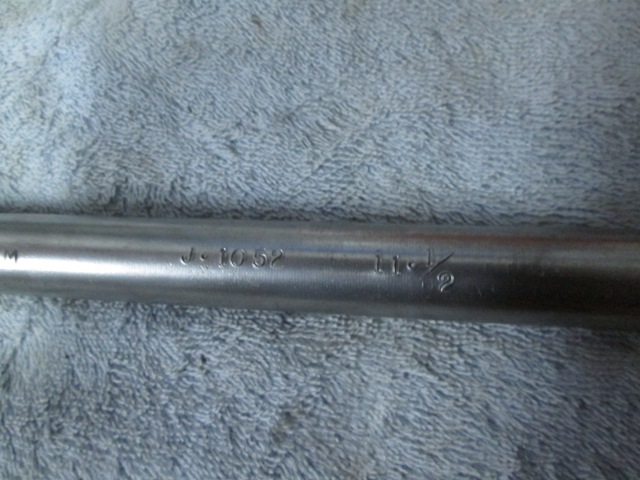

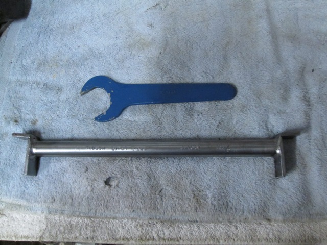

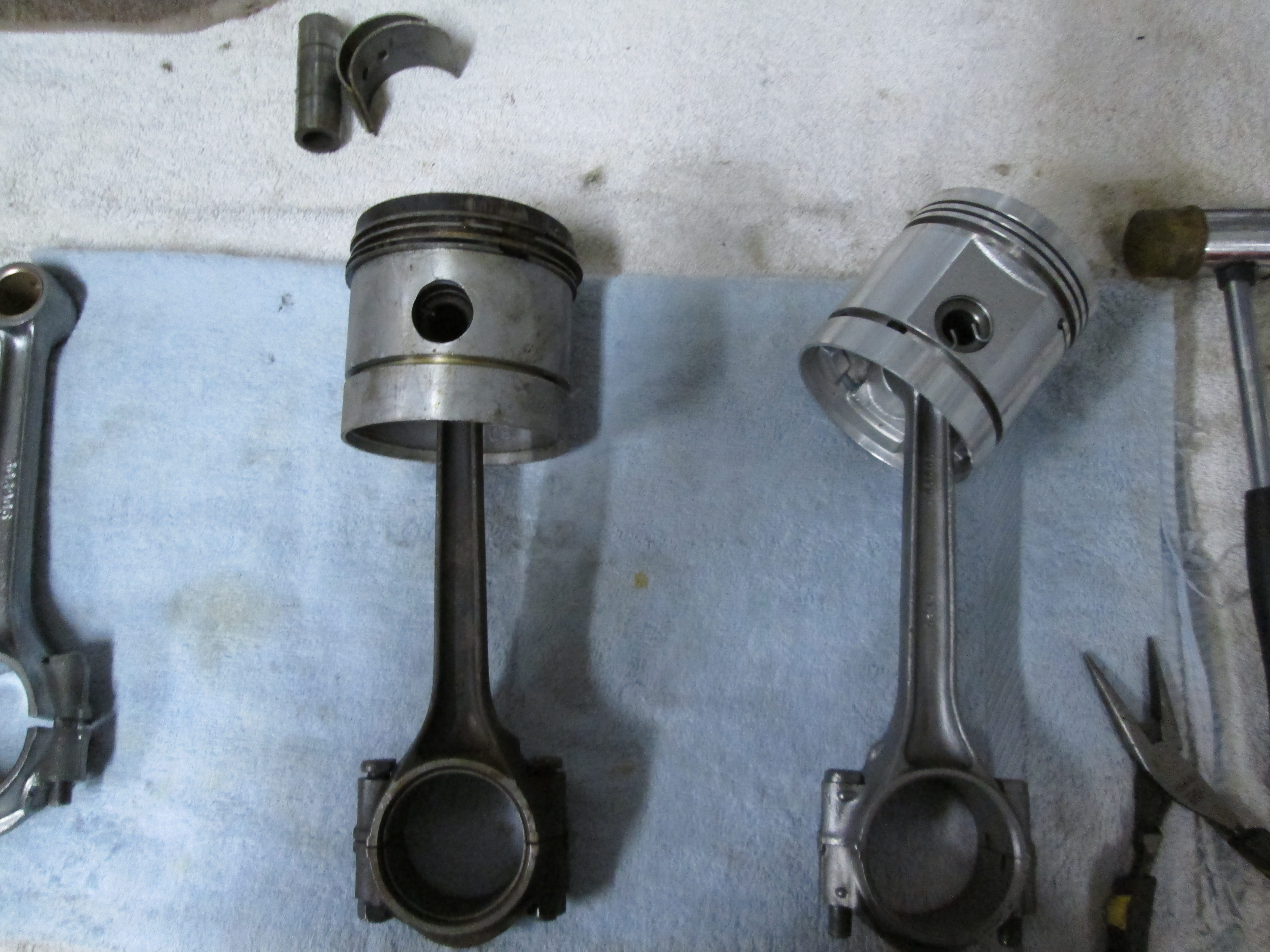

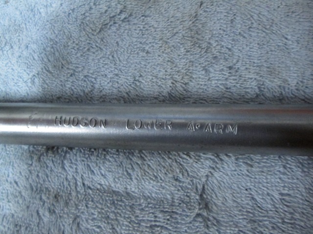

I just finished making the tool for the lower support arm on the Hudson. I got a little carried away with the letter punches. I will be starting on the spreading tool for the upper control arm soon. <?xml:namespace prefix = o ns = "urn:schemas-microsoft-com:office:office" />I also am finishing some rods to replace two that were 50 grams too light. I am inspecting everything to make sure nothing is wrong or damaged. I also noticed what looks like factory markings to designate rod weights. All of my rods but two were marked 1 1 and were 940 grams, but the other two were 14 with a little 8 in the corner were both 890 grams. So I located 5 more rods that were 1 1 marked. Then I will check large and small end weight to match everything.
