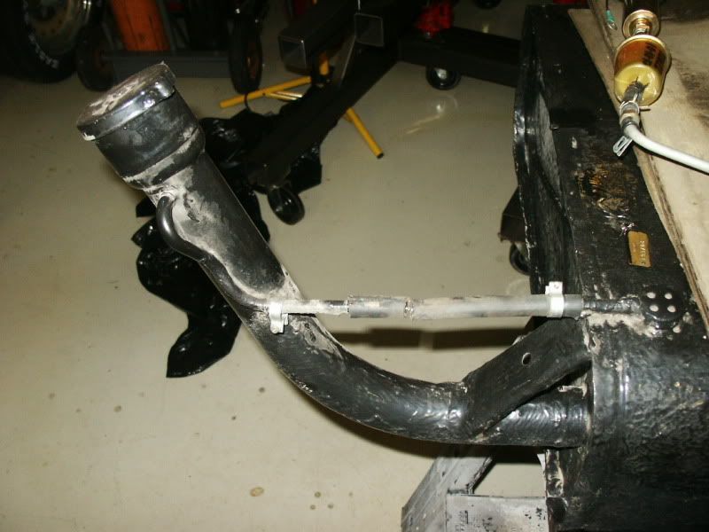

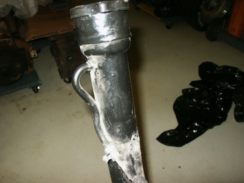

    My tanks out too (49). Heres a couple pics of the vent tube in the filler neck.

    Park, there is no tubing running along side, I didn't see any hole where tubing might have been attached. I'll check more closely tomorrow. Thanks Park. Richie.
    TwinH, mine definately doesn't look anything like your tank, thanks for the pics. I'll have to fashion something that resembles your tank setup TwinH. Your pics helped me, thanks very much. Richie.
  • The gas tank has to be installed then the neoprene gas line installed. it sits above the frame cross member. Somebody soldered the openings to make the tank go in easier, and screwed it up. Walt.

    Gas smell is gone !! I thank all of you for your comments and help,the pics saved me lots of time. There was no tubing where there should have been but there was about a 3/8'' hole in the filler pipe right where it was supposed to be. I threaded it with a 1/8'' pipe tap, screwed in a right angle brass fitting aimed downward. I used some 5/16'' steel tubing to go from the fitting and ran it down thru the floor next to the filler pipe and attached the vent hose to that tubing above the frame. I'll re-seal that area in the trunk floor again.
