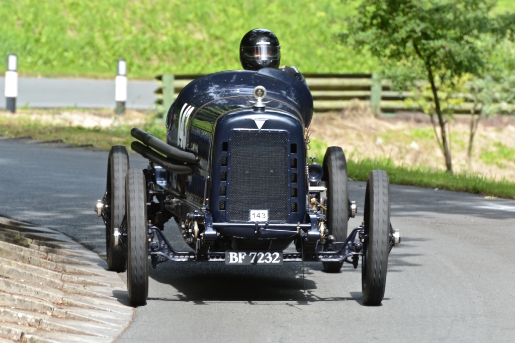

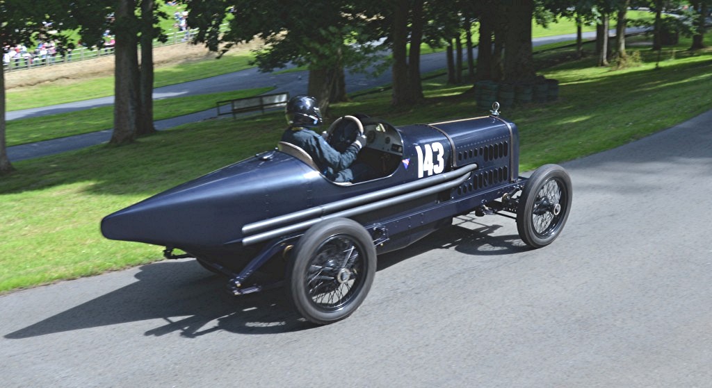

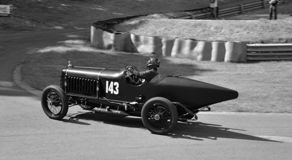

After the resounding success I had thanks to many participants on this forum finding out about what turned out to be the 'Beano' Suburban, I have found some pictures of another Hudson that I took 18 months ago at VSCC meetings at Prescott and Loton Park that you might like to see and share information on.
This one is listed as being a 1917 Super Six with a 4900 cc / 299 cui motor driven by James Colins.
It would appear to be in an immaculate condition suggesting a recent rebuild/restoration.
There can't be too many racing cars built in 1917 even in the USA, I believe my grandfathers were fully occupied representing their countries by taking pot shots at each other on opposite sides of the line somewhere near Arase at the time, so I hope this car will not be too difficult to identify.
I'd be interested in knowing any of it's history, I understand there may have been as many as eight similar racers and that 5 of them were entered for the Indy 500 in 1919, I am wondering if this car might be one of them.
Relevant answers maybe credited and used in a forthcoming blog.
Thanking you in anticipation of your answers.

Thanks for the pictures. Love those 17's0
I've been looking at some photo's of the Hudsons that took part in the 1919 Indy 500 and it looks like the vehicle I photographed above does not have the same kind of radiator cowling, I am beginning to wonder if the vehicle I photographed falls into the recreation / replica category.
Can anyone tell me if the chassis used on the 1919 Indy Hudsons might have been a stock item used on regular road going models ?0 -
The Rad on the Collins 17 is from an old Peugeot.
The frames were all Modified. Shorter wheel base. Engine move back for better weight placement.

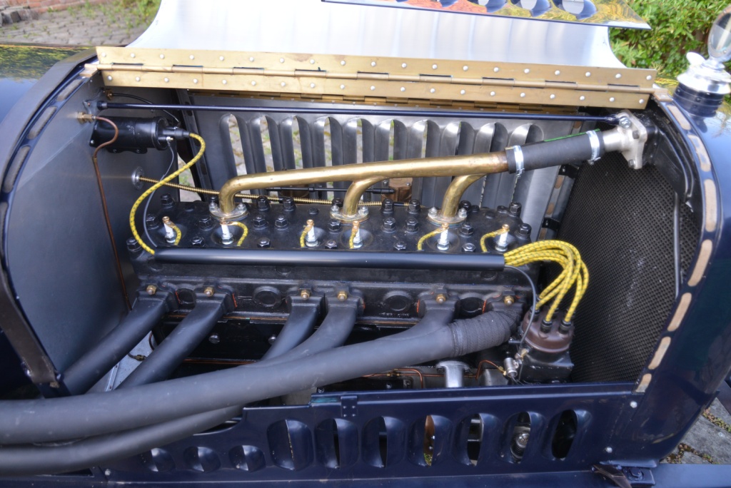

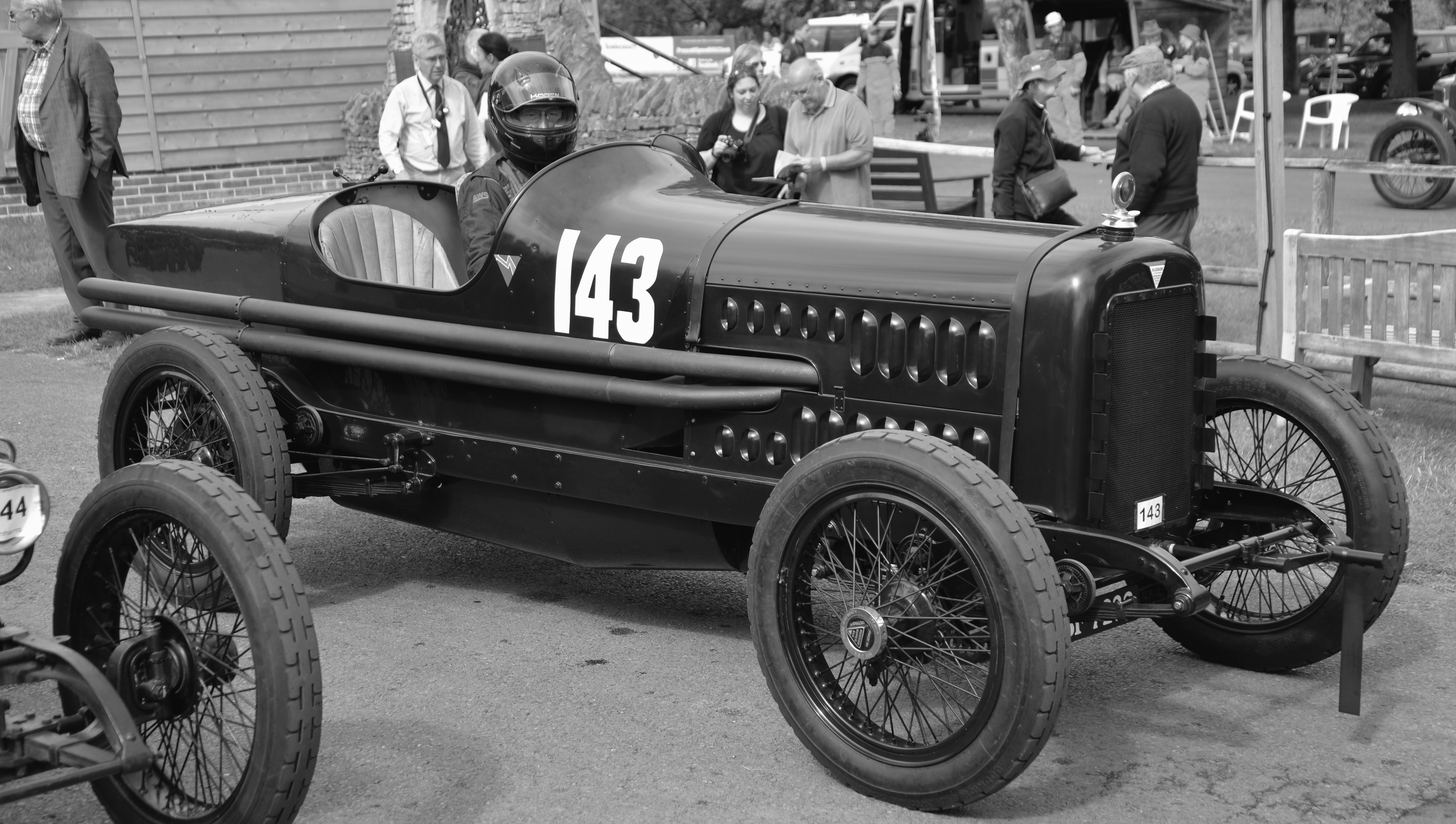

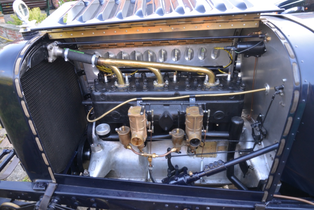

Better late than never - I thought you might like to see a few pics of the finished car mentioned in the thread aboveThe car is as an exact a replica of the original 4 Hudson works cars as possible - bearing in mind that only one car survives in the Samsung Transportation Museum of S Korea!We started with a 1917 "barn find", which was beyond economic repair and made the car by doing exactly what the works did. i.e......> shortened the frame by 20"> the engine was not moved back as stated above, so the engine is in the "usual place"> fitted twin Hudson carbs> made an exact replica of the body from period pictures and current pics of the car in Korea> fitted the 6 branch racing exhaust> drilled the front axle and chassisIn addition we have.......> converted the engine to a pressure fed crank with a modern oil filter + new rods and pistons> better cam with more lift a bit more overlap> bigger valves and stronger springs> crankshaft damper> single plate dry clutch + concealed modern starter> close ratio gears(31mph per 1000rpm in top)> new castings included cylinder head and water pump> block was sleeved back to standard 4,738cc (289 cu ins)Quite a few teething issues in the first year of competition (2015), but managed to win the speed series for automobile-engined Edwardian cars here in the UK and car going pretty well nowSome pictures of the car attachedDrop me a line if you're ever in the UK and would like to have a run!!CheersHugh Mackintosh0
Very impressive, Hugh!
