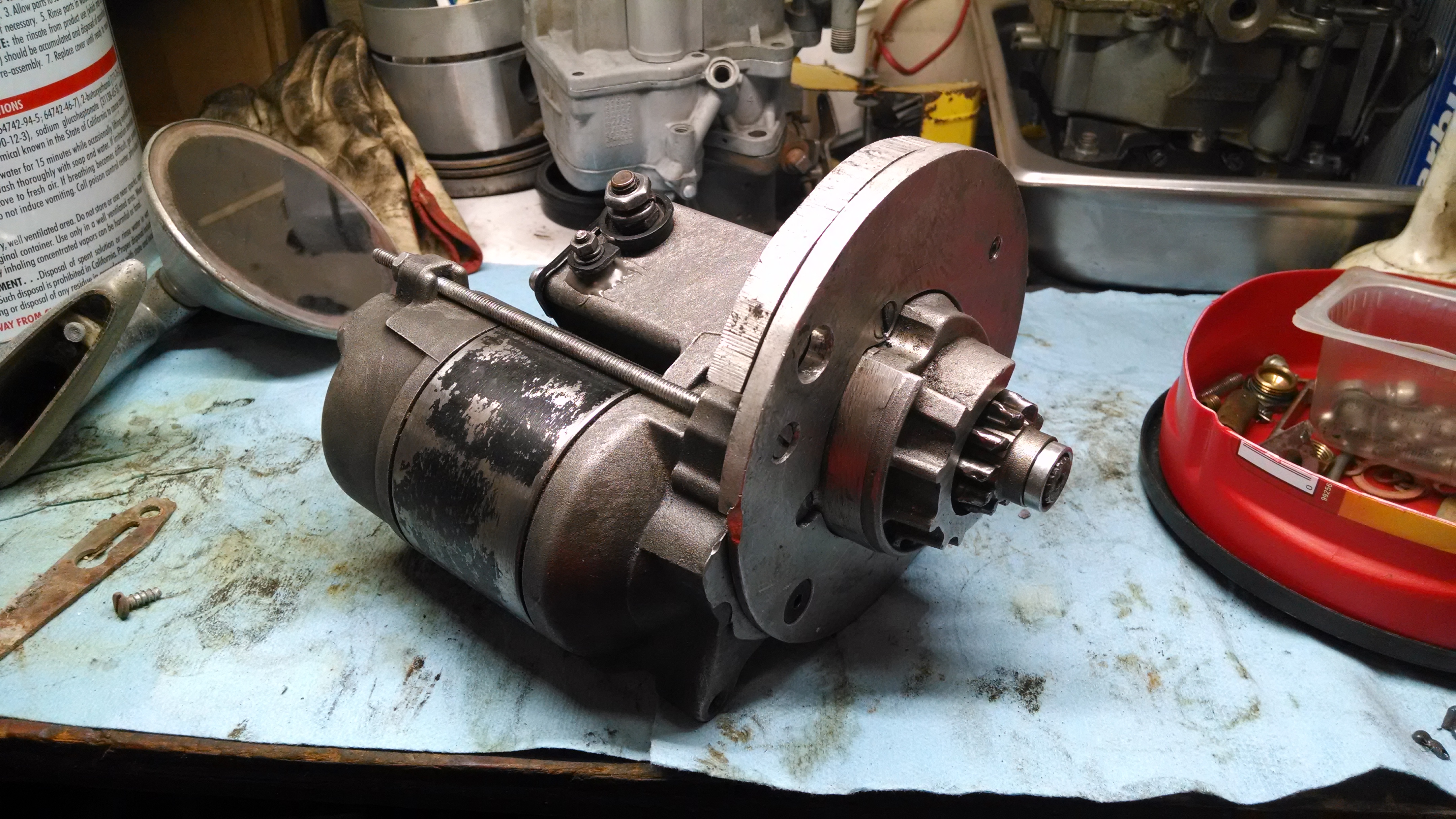

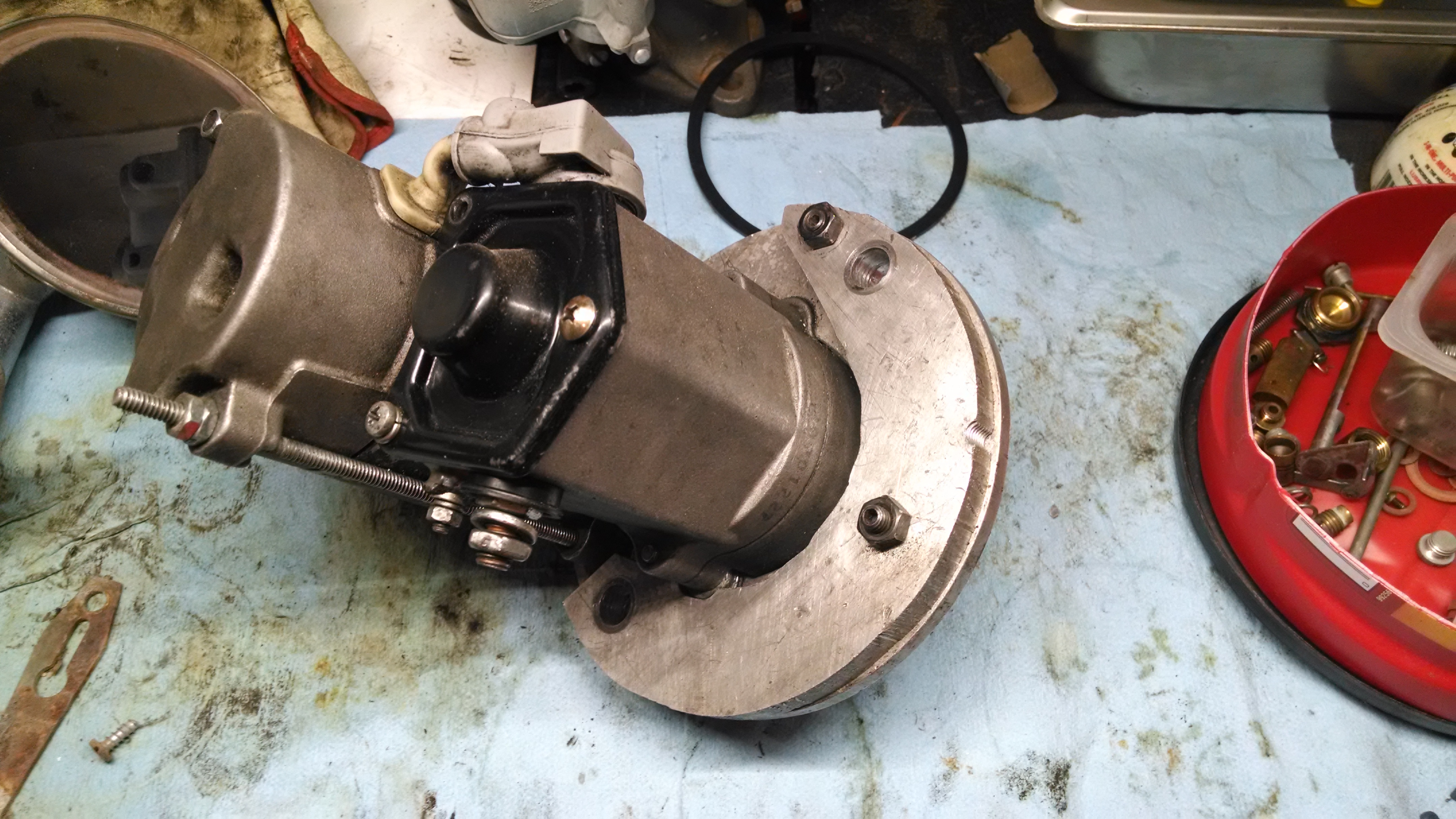

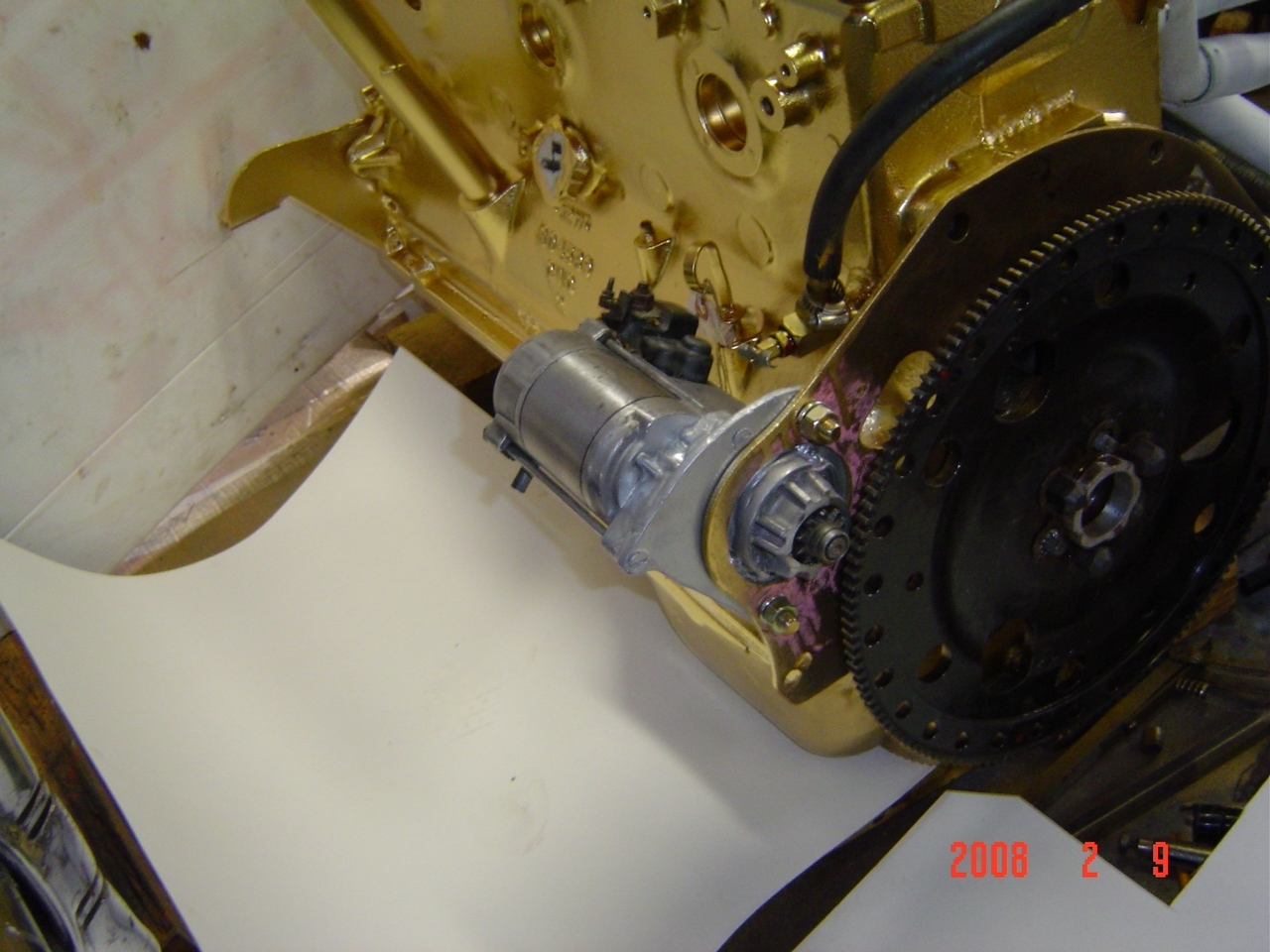

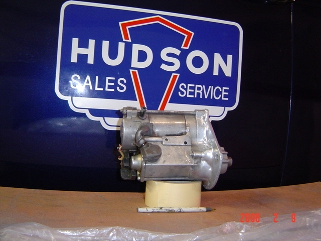

Here are some pictures of my starter. Started with a 1/4 aluminum plate, which was too thin. Made a backer plate out of some 3/8. Stiff enough now. The problem I had was doing this thing with the engine and transission in the car. Think I did pretty good, given that... Don't mind the buggered teeth... All part of working the bugs out.0
Thanks Grim.
So the 1/4 was fine for spacer thickness but the aluminum wasn't stiff enough.

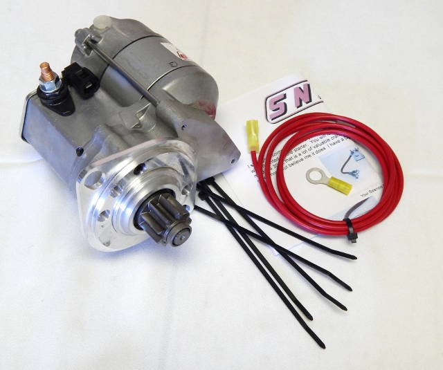

Ironically, Snap Starter Co called me today and said they have some New Nentenso Mini Starters for Hudson ready to sell. He said they will send pictures, pricing, and more Info later today then I will Post..
Cool. Interested to see them.0

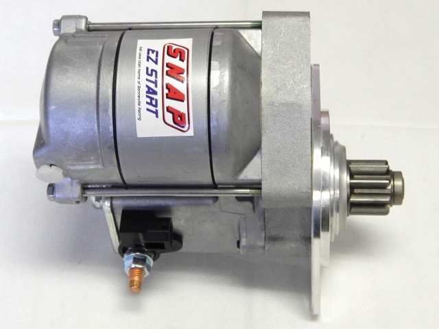

I got off the phone about an hour ago with Terry.
I was waiting on the pics before I posted.
He has 2 on the shelf for $325 with free shipping.
He orders the machined adapters in batches so it depends on what orders he has to how many are in stock.
The starter is all new not a reman.
Here's his email.
I assume your Chuck?

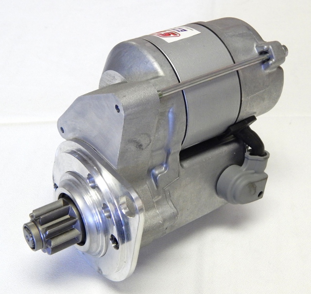

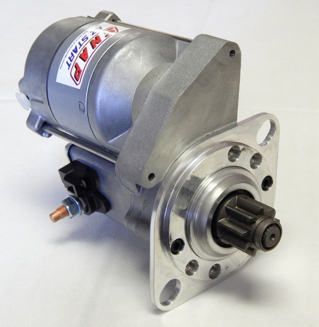

I have attached some photos of this starter it is 12 volt made to replace the MCH6204 if my info is right it should also work for the MCH6107, MCH6201 and MCH6205.
These starters are made from a 100% New OEM Real Nippon Denso Starter, NOT CHINESE, Do not let the size fool you these have twice the power as the original starter, Price on these will be $325.00 I will ship in the US Free by USPS Priority Mail and International the same for $59.50.
The starter does come with a simple wire kit and instructions as you can see in one of the photos

Here are the pics from Terry at Snap.

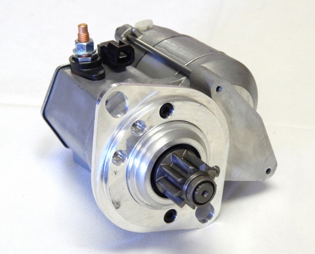

That was a fast reply from the contact number I posted for Snap Rebuilders Wedesday to get the pictures Posted. Snap made an earlier Mini starter Adapter last Fall that worked well then tweaked their initial Adaptor then nachined and built a number of Starters over the winter. They look excellent and I hope we take advantage of Snap's efforts. They even can be rotated if necessary. Rebuilding the heavy OEM Hudson Starter isnt Cheap. The last 12V Starter I took in to have completly rebuilt was over $200.The all new Snap Mini Starter bought Direct is $325 Shipping included in domestic USA.

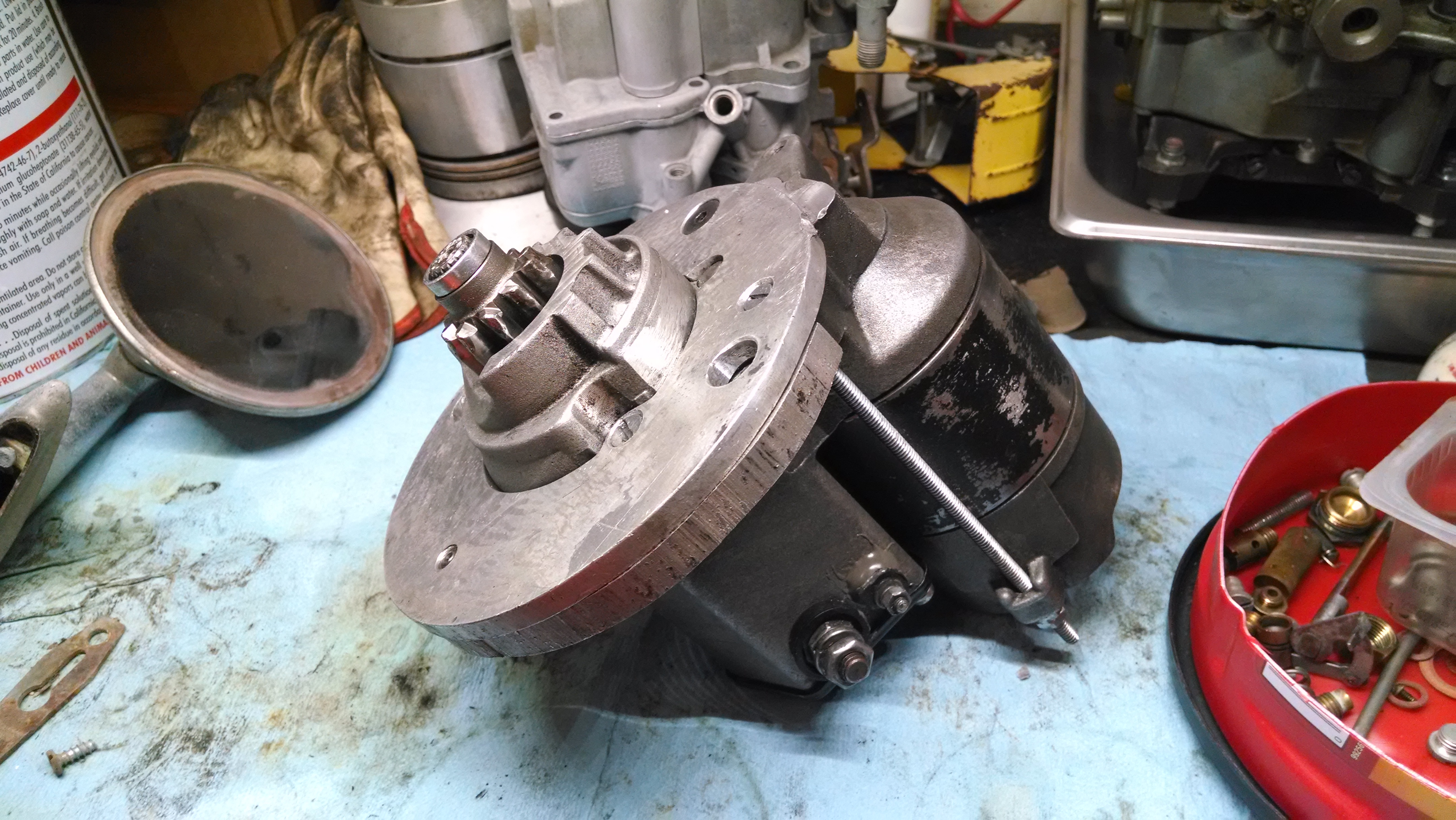

I built two Mini Starter's (Pictured) a few Yrs ago after learning Mopar had the 'same Pitch Ring Gear as Hudson' using a hack saw & die grinder that worked out well. I bolted my fabricated Adapter Plate onto the starter then read how to set Ring Gear clearance. One starter is on a Stroker Motor and one on a St Rod.
My Point is the Snap Starter is a brand New HD Nippon Denso (not a used Mopar), looks like the Adapter is better engineered & manufactured using modern CNC Machinery,(not a hacksaw), and appears adjustable, as well as clocking (rotating) ability if desired I would think it would work very well so I would buy one when needed rather than re- fabricating another adaptor....
