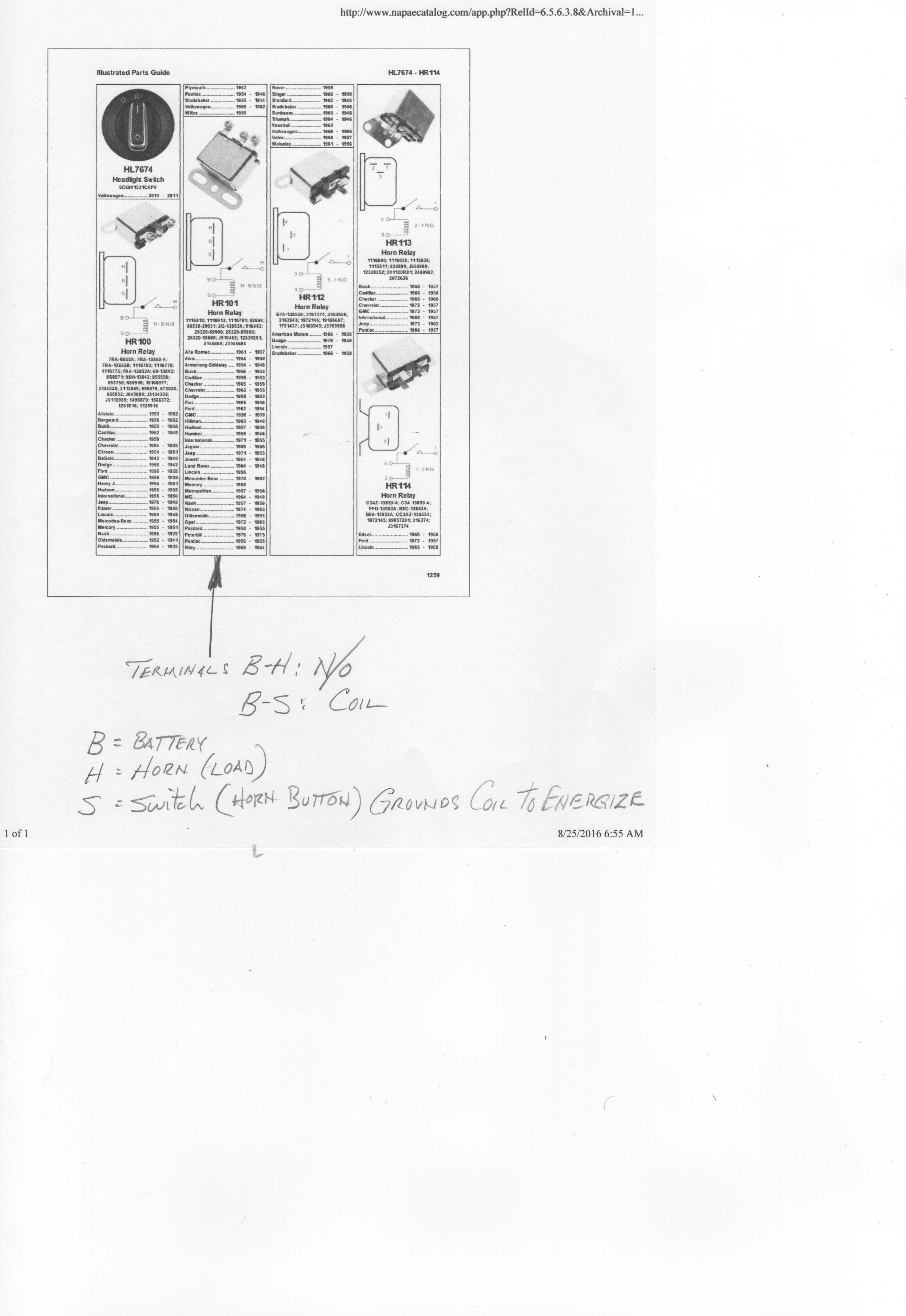

I converted to 12 volt, attached horn wire to horns and it blows out the 15 amp fuse. What specific relay should I use and how should I wire it? Thanks0
Look on Park's 12 volt conversion chart. I don't have mine readily available but it's HR-101 or something close to that I think from NAPA.0
Jason's got a good memory . . . it's (Echlin) HR-101. But what fuse are you blowing? One on the relay?0
No, I installed a complete wiring harness and fuse box from RonFrancis Wiring and I wired them directly to the horn fuse in the fusebox.0
The Horn circuit in the harness is intended to carry only the current necessary to operate the relay, not the full load of the horns. Horns draw quite a bit of current......that's why they go through a relay.
As for using a 6V relay in a 12V system, it's not a matter of what the contacts will handle, it's a question of whether or not the pull coil will burn out when 12 V is applied. I suspect some will handle it for a long time but I'd avoid holding the horn button down for very long. It won't likely damage/burn anything else, just the relay coil.
F
So the (Echlin) HR-101 will work?Any tips as far as wiring it?0
Wire it up the same way it was wired using the original wiring diagram. The HR 101 has three terminals and looks just like the old 6 volt horn relay.0
Hold down "Ctrl" & spin mouse button to enlarge.Frankvintagefullflowcom said:Sorry the pic is so small but........
Dave,
Thanks for the tip. I'm an admitted techno-dork. That works but I'm not likely to remember it.
What I'd like to do is figure out how to get my printer to fill the page.....but I'd forget that, too.
