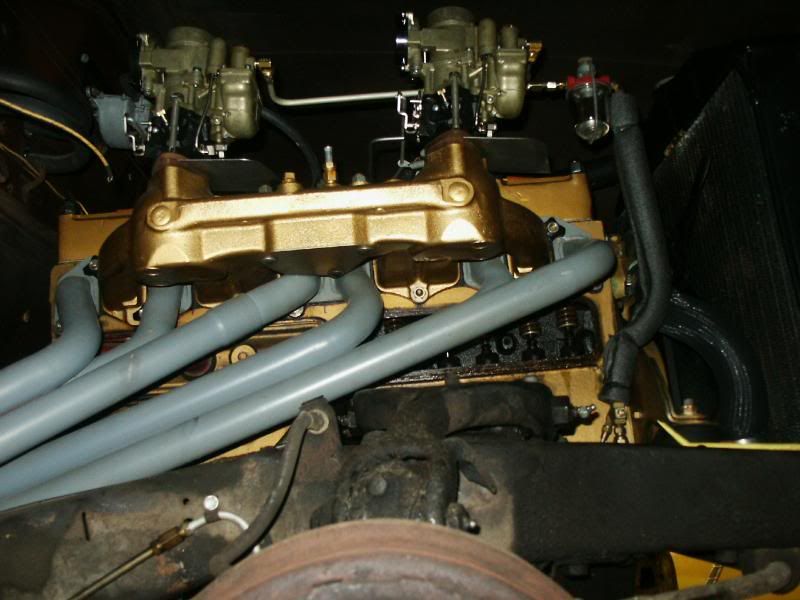

My 308 has a Clifford head and split header and has had a little puff out one of
the pipes for a little while now that really hasn't affected driveability, just
noticeable at idle and an aggravation. Well,I figured a little attention and good
tune-up would bring her back to her sweet self,but I guess thats not to be,at least
right now. Here's what I found.

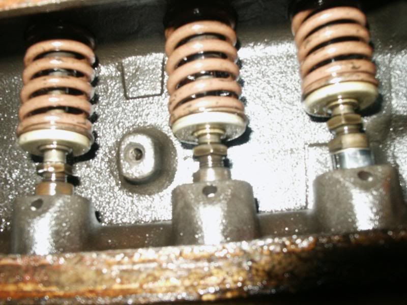

Well,I was wrong.It does have solid lifters...
BUT,this headers going to have to come off to get to the rear ones.
Cylinders #1 and 2 are checking at .011 int and .015 exh so I will
be loosening up to the .014 int and .017 exh that Walt recommends.
This may not fix the leaking intakes on #5 and 6 but at least I'll
know what I have.The covers were leaking anyhow.

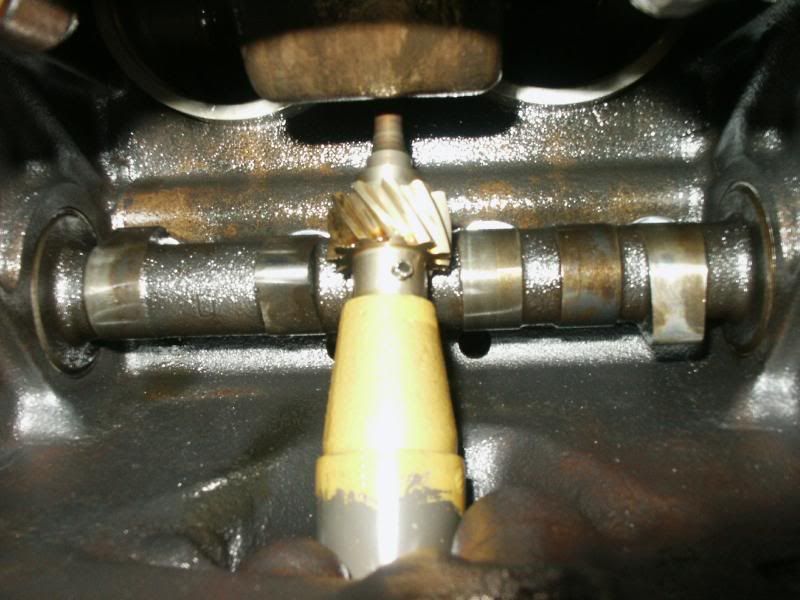

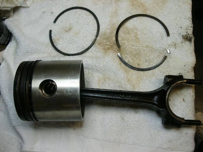

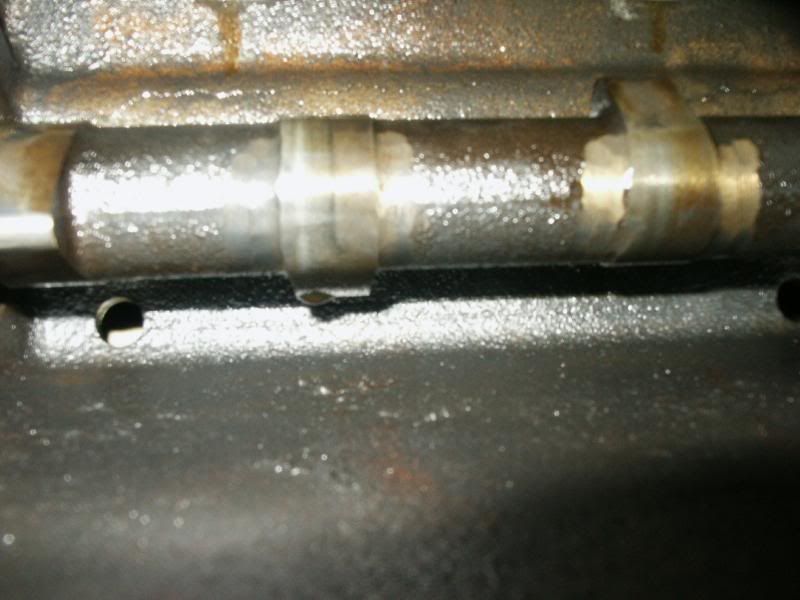

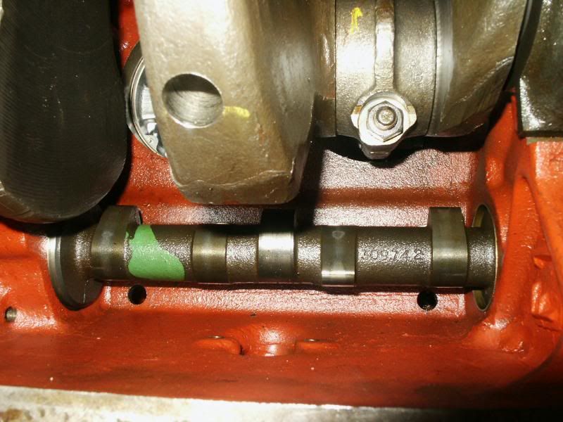

Great news! NO major damage,just broken compression rings on #5.
Oil pump drive gear looks better than I expected.This engine has been previously
rebuilt.
Looks like this camshaft has been reground before. Not much base circle left here.
Aftermarket Jahns Piston,both compression rings broke and the wrist pins a little
looser than what I like.
I'll be completing the teardown and see where I go from here.0 -

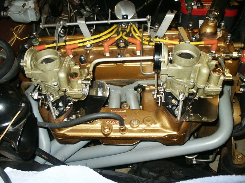

TwinH The carbs look like new are they? If not who did the clean-up on them. Thanks Rudy0
super651 wrote:TwinH The carbs look like new are they? If not who did the clean-up on them. Thanks Rudy
Rudy,yes the carbs are new or "renewed" I should say,by:
Daytona Parts Co.
and what an awesome job they do.0 -

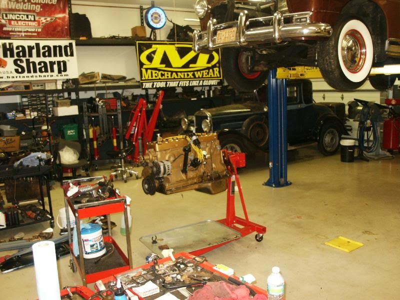

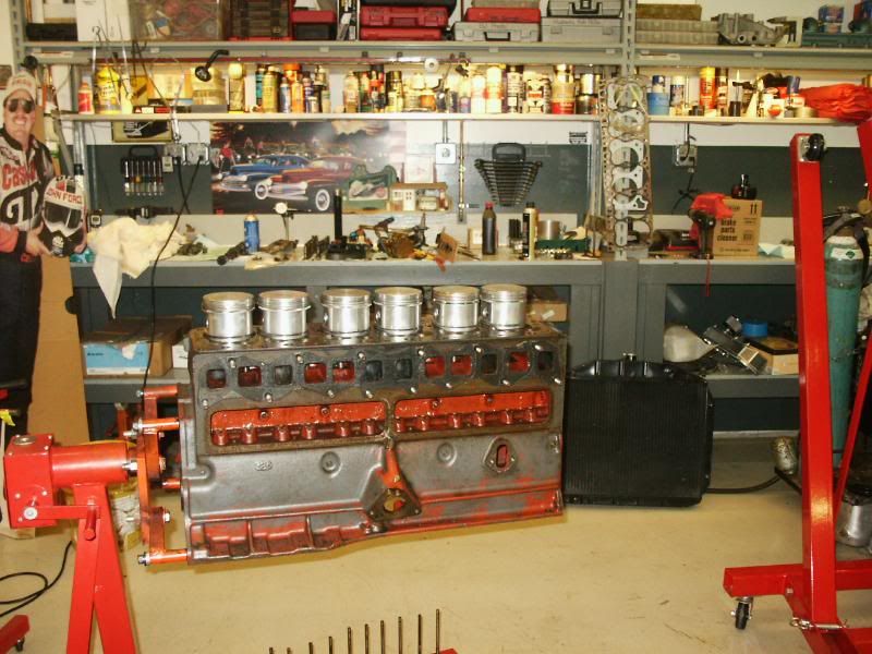

Back again....Plan B. Ring lands are hopelessly worn on the old Jahns Pistons,block
.060 over and the crank turned 30/30 SO,if I'm going to rebuild a motor I want to use
the best parts I've got. Back to the spare motor that came with the car now collecting
dust under some shelving.Its another 55 block/crank but for some reason had hydraulic lifters. Now tearing down this motor is another head scratcher. New pistons in a standard bore and new bearings on a crank that hasn't been run either.The valvetrain
on the other hand seems to be all used stuff.The 309742 cam is visibly a different
profile than the reground 309742 from the other motor. Valves are reground with little
margin left but the guides are all new.Also the inside of the crankcase is coated with
glyptal seemingly before any machining was done.Dropped these parts off at my local
machine shop yesterday to check the bores,clearances,etc.and run a profile on the cam
to compare to the other one.If this all works out I'll be saving considerable $$ getting the Hornadore back on the road.

OK,life gets in the way,finally back on the 308 build. Just to bring you back up to speed the motor I pulled out of our 49 was already .060" oversize Jahns pistons and
.030"/.030" on the crank with the pistons being slap wore-out.Plan 'B' is the spare
308 that came with the car and finding it to be a fresh build that never was run,but had suffered some poor storage over the years. New standard(pinned)pistons and new never run standard crank. The dilemma faced now is my machinist balking at the 'tight'
main bearing clearances(by his standards). My take and factory specs of .0005"-.0015"
is that these babbit backed steel shell bearings are much softer than the Clevite and tri-metal bearings he is used to dealing with. Clearances on the mains are as follows:
#1-.0013" #2-.0013 #3-.0014" #4-.0017 and .0055"endplay. Bearing part#'s jive with
standard #'s in the manual except for the #3 thrust bearing.
#1-300260 #2-300261 #3-302574 #4-300263.
The machinist would like to hone the main bearing bores to loosen the clearances.
I am leaning heavily toward telling him to leave as is,but would value advice here.
Its no 'race' motor,just a little hotter with a super 7x cam,7x valves,Clifford head
and headers. BTW, rod bearing clearances are: #1-.0021" #2-.0025" #3-.0025"
#4-.0022" #5-.0019" #6-.0018" and I can live with these, I believe.0 -
