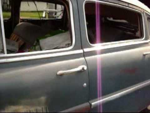

Why Im here, well my dad purchased a 1953 Hudson Hornet back in 1973. he rebuilt the engine and converted the car to 12 volt, but other than that he didnt really get much else doen to it due to bad health. sadly in november of 09 dad passed away, he left me the hudson in his will and now i want to get it onm the road but im not really shure where to start with this project. The engine has been upgraded with as much of the factory style speed equipment as he could get (the cylanders are also bored .04 with jans pistons) but he never could get any headers so my 308 still has factory manifolds. the engine runs perfect.
Here are a few pics of the hudson.
My current plan is to put the drive haft in and go through the brakes to see if i can get it to go up and down the driveway under it owne power.

It looks like your dad did some quality work / mods on it. I see it has electric wipers and very neat engine bay work. If you look back in the forum you will find some one talking about new headers being made. By Clifford I think,

Thanks You for your Comment, yes i forgot that dad did retro fit electric wipers addapted from a ford windstar. I hope to have this car road worthy ugly or not next summer.

Thank You everybody for your comments. Joining the HET club is on my todo list as I know that at one time my father was a member but that was in the 80's. dad also owned a 52 and 54 hornet but he got rid of them before i was born. as far as hudson activity goes in my are(West Cleveland Ohio Specifically Brookpark) there are only a few hudsons that im aware of, a 46/7 pickup, 49 commodore with a hornet engine, and a 54 Jet.
as far as the brakes go dad apparently had them profecionally rebuilt a while ago and all is there accept for a master cylander that jsut needs rebuilt but i will go through the entire system before attempting to drive it.
Here is a video my brother made last summer about my Hornet.
http://www.youtube.com/watch?v=JTal9eH_pJA 0 -
