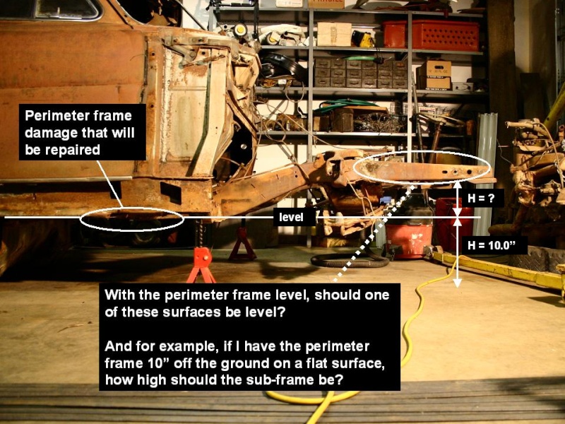

My '49 brougham has definitely seen some abuse, so I want to make sure the front sub-frame isn't bent. Pictures of the car prior to removing the front clip seem to suggest the frame may be bent upwards since the gap between the passenger door and the front fender tapered from ~3/8 at the bottom to 0.0" at the top indicating the frame or fender or core support (or some combination of) is bent upwards. I think it would be relatively easy to check the height dimension on an undamaged original car, or someone may just know it already (see picture). Thanks again for your help.....hopefully you won't get tired of me asking questions :-)

I've been thinking about this. If someone could measure up from the floor to their perimeter frame in 4 places (near the wheel openings), and measure up from the floor to the subframe (near say the bumper bolts), as long as the floor was flat, I could calculate the relative subframe height (using CAD software). The only requirement would be that the floor was flat (the floor or the car would not have to be level). I don't know of anyone in my area with a stepdown or I would do it myself. Is anyone out there in the seattle/tacoma area that wouldn't mind me taking some measurement off their car?

Given your description and that the alignment problem is on the same side as the "frame repair" I'd guess the cracked weld caused that side to sag a little which would have created the gap you mentioned.
If the drivers side door/fender does line up - I'd X-measure the front frame rails from the top using points of reference that match on both sides to start...0 -

To the best of my ability, I calculate my H to equal 6 3/8" which suggests my frame is bent upward by well over an inch. Hmm....now what. I suppose I could heat the cross-beam below the firewall and try to pull the subframe back down? Or if I weld on a new FatMan Fab stub frame I could just make up for the difference in height when I weld it on?? I imagine it's not real critical since I can shim the core support bolt if I need to for fender alignment and slot the bumper holes.....any thoughts? Thanks for all your help.

Before going too far, I would double check the level line and the point you are measuring to so that they are exactly tto the same point. A little bit off will make a big difference in the dimension. Also, you should check the opposite side of your vehicle and compare the numbers. If they are close (I believe the tolerances should run a 1/4 inch or so), you may not have much of a problem. If they are way off, you may have a twist in the subframe which would need to be corrected.

Okay, now we're getting somewhere.....let me carefully re-check my frame to the drawing. I have been checking both sides and taking the average. The passenger side has the cracked weld at the intersection of the cross-beam and sub-frame and is relatively flexible (so I can move it up and down a 1/2" to get it the same as the drivers side before I weld the crack.....but I was worried about the whole frame being bent up. With the frame drawing in hand I should be able to really verify now if my frame is bent. I didn't know the drawings were available.....I certainly owe a 6-pack to HeartofTexas!

Okay, here's the latest, when I tried to enlarge the link that Ken gave me, I still couldn't make out the dimensions very well. So I went to his site and groused around a little more and found the same picuture but at a much higher resolution. Here's his other picture:
http://hudsonrestoration1948-54.com/images/stepdownframechart.JPG
Now this indicates that my "H" dimension should be 5 19/32" (actually to the lower surface of the core support flange from what I can tell from the picture). This is certainly closer to my 6 3/8" measurement. So now I'll take the real measurement from the center of the bumper bolt hole. I think I'm not in too bad of shape.

The thing I'd like to verify is if the 1949 frame uses the exact same measurement as the picture since the picture indicates 1952 thru 1954 models. Does anyone know where this picture came from? Because if I look closely I can see where other drawings of the frame had bled through to this drawing. The several pages before and after this page in the book look like they would be very helpfull as well.

Ken had emailed me the scanned image of the 48-49 frame dimensions. They are indeed identical to the later stepdowns, just a few little things are different. The hi-res image I mentioned in an ealier post is the best one.....you can read all the dimensions easily.
Not sure if I mentioned this earlier, but I used a "cheapy" laser level to check the dimensions. I had the car on jackstands and positioned the level near the front of the car. I then adjusted the level so that it projected a plane parallel to the frame at the rockers (keep in mind the frame changes height near the front wheel and near the back wheel - so I "leveled the level" using the mid section of the rocker frame under the doors). I could then easily measure down to the laser from any point on the frame and determin the relative heights at any location. One key thing to keep in mind is that the "base line" on the drawing is at the lower side of the perimeter frame at the foreward end near the front wheel.
